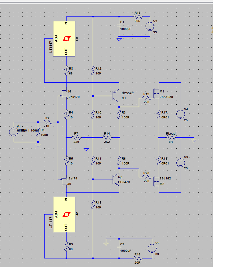

Building a hybrid of posts #75 , #117 and #57
Of course, there are better matched parts and I didn't make an elaborate choice of these two JFETs - I just happen to have them in my parts bin.
So the scope of j175/j310 experiment was just the curiosity how will it sound (having in mind that due to cascoding only small part of transfer curve is exploited so the differences don't get the chance to become too big) and it's not bad at all...
Hi there, I'm planning out a build using ideas from posts #75 , #117 and #57. More or less doing a LSK style frontend using J174's and one of j310/J111/j109 and lateral source followers. Attached is the basic plan of attack - although showing sk170/j74's at the moment I'd rather use the old switching jfets as a learning exercise.
My questions would be
1. what current do you guys suggest for the jfets? ie where on the curve balances best
2. which pairing would you suggest be the best, or should I just sort through for Idss and Vp and pick the closest matches?
3. where to put a pot to balance the offset at the terminals?

1. Generally, pick the most linear region on the transfer curve for the chosen JFET and try not to pair very different JFETs (like j74 and 2N3819)
2. Yes - Vp, Id, gm
3. Good places are between the sources of the input pair, between the bases of cascoding BJTs and R3/R6 on your sch. (to set LATFETs' Iq and DC offset at the amp output).
Also, there is no need to supply the LATFETs with more than +/-18V if your gain stage doesn't produce more than 15V_peak.
Thanks for the reply! I've been playing a little more in ltspice matching models of jfets and it sort of looks like a match between the J174s and the J310's looks good - Vp is quite different as does Idss but the Gm looks similar-ish (datasheet wise anyway) so I might try working through the jfets on hand for something close...
1) Wrenchone ended up at a current of about 5mA yet you seem to run higher currents through the jfets. Looking at the curves on SPICE it seems like the jfets are more linear at higher currents (or the models are a bit naff after a certain point). Do you have any suggestions from your j310 experiments?
2) I needed a good excuse to bin the parts I have anyway... 🙂
3) still considering the best spots for this - I can see the approach you took in post #118, and the the approach taken in altering the source resistance on the front end jfets (although I hadn't thought about altering the cascode reference voltage... hmm 🙂 )
Finally - yes I see your point about the latfet voltage. As it is, with the input voltage at 2V input, it swings +-15V for a 4R load. The FFT shows a lot of distortion though!

Raise the LATFETs' Id to about 1A and change the cascode voltage divider to get JFETs' Vds = 20V. Also try try raising R7 to 270R or 330R and at the same time R14 to 2k7 or 3k...
And don't trust sim graphs too much - many good men were driven to madness that way... 😀 Build a quick point-to-point prototype and see what you get 😉

Thanks again Juma - I'll sim those tweaks.
Re Building - Yup, that's the plan alright. I've the latFets on the way and it's a small and simple enough circuit that it'll be easy to knock up. Only one set of latFets though so I'll be making those connections via terminal block 🙂
And thanks for the suggestions - I'll have a play on LTSPICE and then report back after I do a build.
