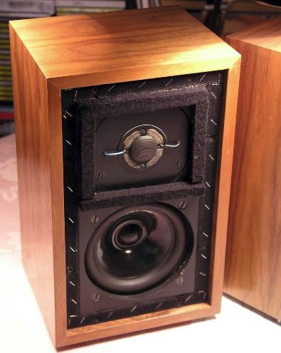

LS3/5a mini monitor clones

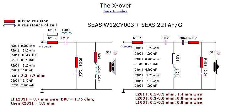

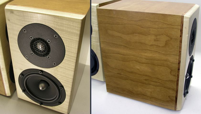

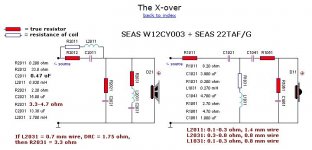

I had a look around for a published design using that same SEAS 22TAF/G Metal Dome along with a very good SEAS W12CY003 Paper Mid/Bass. Mr. Troels Gravesen has done something he calls Eekel's Mini.
This is a 5 litre reflex with a very well designed crossover. The 900Hz peak is notched, the cone breakup gets a tank too. The tweeter has a Zobel. All this is good IMO. Needs some breaking in evidently, but certainly in the BBC tradition I reckon, and the cabinet construction details are up to you I'd say. The SEAS22 TAF/G tweeter seems to have none of that metallic zing that we sometimes hate. The bass/mid is pleasantly low inductance.

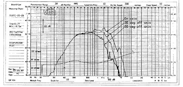

I was looking into this whole KEF T27 mylar tweeter business following mondogenerator's remarks. It's quite strange to uncover yet another living fossil. But here is the efficient Mylar 94mm Vifa D19TD-05-08 still available at Parts Express in the USA:
Vifa D19TD-05 3/4" Poly Dome Tweeter 264-500
This bears an uncanny physical resemblance to the current SEAS 19TFF Soft Dome. You have seen and heard these Vifas in old Monitor Audio, Mission and JPW designs. It's also not dissimilar to the 98mm Celestion HF2000 and the 104mm KEF T27 and is probably a good replacement with a bit of resistor padding. Along with the Visaton DT94, it has a peakyness around 10-15 kHz, which could be readily filtered out I'd reckon. But off-axis dispersion is exemplary.
I gotta admit I am now quite undecided about tweeters. Spendor like the fabric SEAS 22TFF, Harbeth (and Joachim) like the hybrid metal SEAS 22TAF/G as modern replacements. Add mylar domes and paper cone tweeters, and it's really hard to choose. 😀

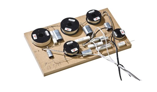

I think you are right, ivanlukic, this Monacor LS 5/19 is quite doable. I had a look at it in post #43, but let's reprise. Bass notch plus a notch on the mylar tweeter peak at 10-15kHz. Otherwise standard sort of 2nd. order bass, 3rd order tweeter which is good on phase alignment at crossover. Plenty of adjustment on tweeter level available on R3.
Monacor SPH-145HQ £41 5.5" Paper bass.
119mm cutout. 145mm dia, rebate 6mm. Qts=0.44, Vas=9.4L. Qms=3.07. Rdc=5.8. Ind=0.53mH. Fs=52Hz. 88dB.
Monacor DT-19SU £27 mylar type 19mm dome tweeter.
60mm cutout. 100mm dia, rebate 2mm. 91dB.
Link for kit:
Strassacker: Lautsprecher - Boxen - Selbstbau
Construction details:
Test Lautsprecherbausätze - Monacor LS 5/19 -
Cabinet is about 6L which is close to the 6.2L value I calculated, and accords with Vas and Qts with a low resistance bass coil. External 310mm H x 190mm W X 172mm D for 12mm ply AFAIK. Slightly bigger for 15mm ply. Battens must be some sort of softish (Rahman?) 16mm timber. Bitumen damping on all panels plus polyfill stuffing.

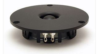

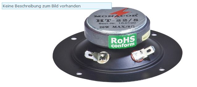

Classic cabinet internal dimensions for optimal non-resonance are 0.618 x1.0x 1.618 (Golden Ratio) or 0.8 x1.0 x1.25 for those who like to tinker. Since they are cheap as chips, I include the cone tweeter Monacor HT-22 which might be fun to try too. 😀

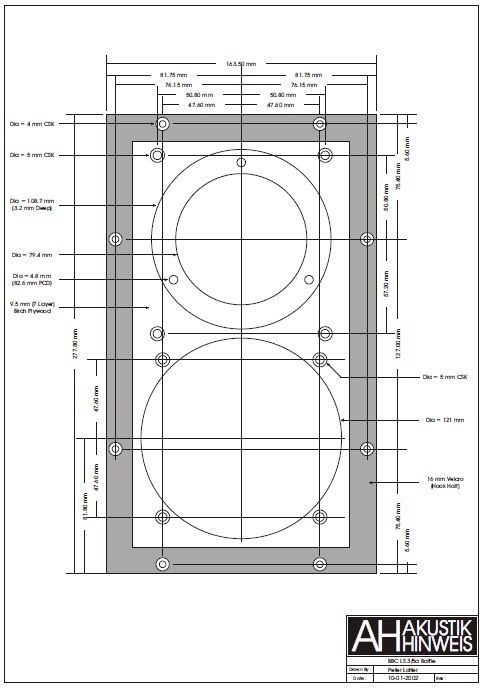

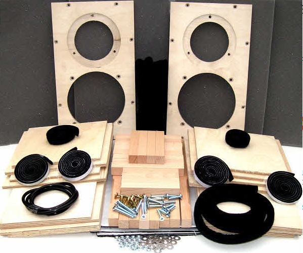

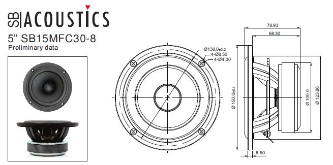

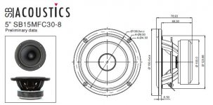

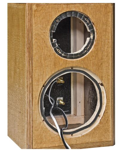

I was scratching my head over whether it is possible to use that Falcon Acoustics LS3-5A Kit with modern drivers. Apart form the Monacor SPH-135/AD and SPH-135TC Mid/Woofers, I haven't found ANYTHING that will fit. 😡
You have a 121mm hole and 4 screws on a roughly 135mm diameter PDC. Tweeter rebate is 108mm. Problem is the beech battens only give you about 133mm width with mounting on the back of the baffle which scuppers your chances with the SB Acoustics polycone below. FWIW, the design uses 9-layer 12mm birch ply and 16mm beech battens, although the front panel is 9mm 7-layer birch ply. It does look possible to fit a different 12mm front baffle with a rebate. Especially with a small unit like the Visaton AL130 or W100S where the Vas works out OK even if it's not a polycone.
Timber is not something I knew a lot about. But Yellow Birch ply is vastly (X4) harder than floppy pine ply. Pinkish Beech battens are vastly (X4) more rigid than floppy pine battens too. Other choices for hardwood front baffle laminating and battens can be maple, used in guitar stems and violins, and surprisingly, Lime aka Linden aka basswood, which is used in the stems of bass guitars and is an ungrainy hardwood. Happens I tested some Lime for strength in 1987 in Holland Park, London, when "Lime Walk" all blew down one very windy night...😀
Lime is that stuff with the big green sticky leaves that dumps goo on your car if you foolishly park under it. Beech trees are interesting because they fuse branches with adjacent trees to produce a stronger structure. These are hardwood trees of the mature forest. Pine and Spruce and Fir adopt a more flexible strategy in exposed places as firstcomers. They BEND with the wind...😎
I would presume birch is quite bendy too, since it is a firstcomer in woodland too. Bottom line, is these BBC cabinets are a lot more rigid than I thought initially, and the hardness of the panels and battens seems to be quite well matched. I really don't know much about the equally important damping properties.
