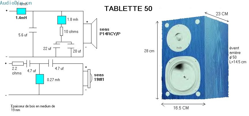

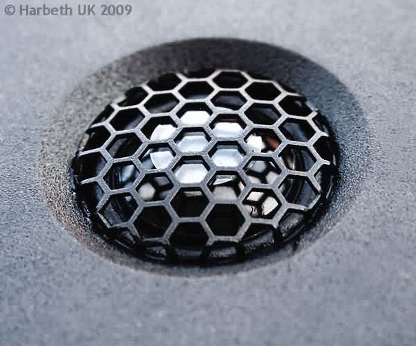

SEAS P14RCY and its successors looks right to me. The Harbeth tweet looks like a variant of the aluminium SEAS 19TAFD/G which continues to irritate me in my Monitor Audio R300/MD, albeit with no ferrofluid... 🙂
H0532-08 19TAFD/G
The soft dome SEAS 19TFF1 looks better to me.
H0737-08 19TFF 1
These two drivers were also used in the Proac Tablette 50, which is an LS3/5A clone if ever I saw one. Credit Paul Yahya here for his hard investigative work:

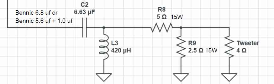

HaHa, Cheap Trick CT 238...yes. 4 ohm 4" bass, 19mm SEAS tweet. 🙂
Rearrange the following into a well known crossover for 4 ohm bass and non-ferro SEAS 19TFF...Reckon there might be a 8.2R/1.5uF Zobel there and 2x4.7uF/0.27mH valve friendly high pass. But I'm a bit stumped. 😕

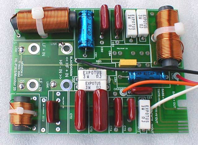

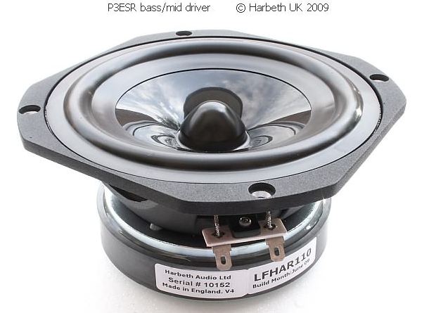

Onwards with the current lovely MDF Harbeth Monitor 20.1 and it's studio P3ESR brother. The bass is a handsome Harbeth special, made by them from some poly material they call radius. Tweet is a modified SEAS metal dome with a different phase plate. Looks like they use double magnets for magnetic shielding and boosting field strength. Crossover is very nice, with a bolt on connection to the rear speaker terminals. Bit of a mixture of models shown here, but vented bass is good too.

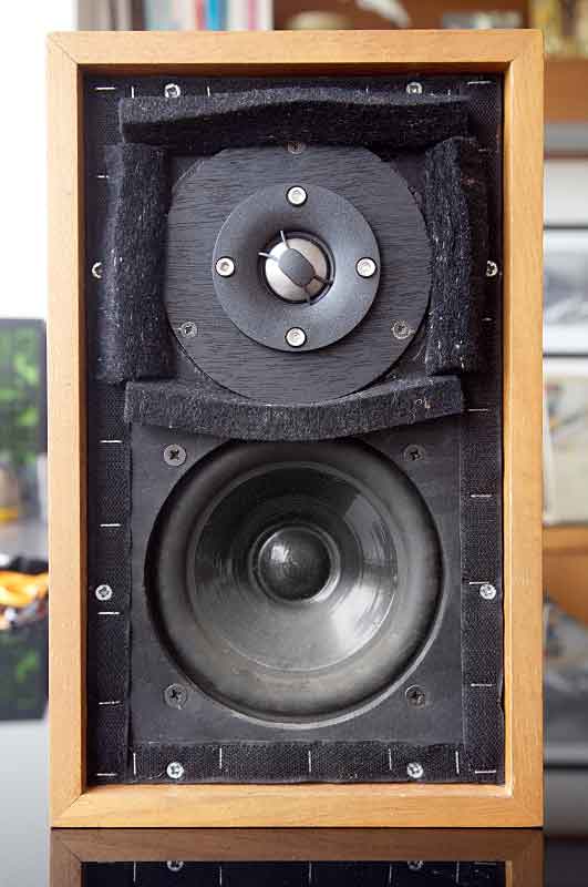

I have a friend who has 3 pairs of LS3/5as. Rogers, Spendor and Stirling. The Stirlings do not use Kef Drivers. He assures me that the Stirling use Monacor 135 TCs, not the ADs. The TCs (twin voice coil) look identical to the ADs but are less efficient (85dB. Not clear if this is 8 or 16ohm, ie both coils in series) and Vas 16 litres and Qt 0.42( from memory). The frequency response looks broadly identical, but smoother. Strangely they are a bit cheaper.
the stirlings look smoother than the other LS5s? I doubt that. The LS5 is a class 2 monitor (IIRC must meet +/- 1dB) The design was contracted to many companies to make the drivers box and all to the original spec (Kef?). Small variation in build quality is the most ive come across. I live with an early 80s 15 Ohm marked Goodmans, which are the infamous 'white belly' types. They really sound very good, and and any 'brand loyalty' is likely an oxymoron. The monacor SPH135 are a world away from what they emulate, or are marketed as drop in replacements for...
I have no direct contact with LS3/5as, and can only relay my friends views. I believe that Stirling were authorised to market these as LS3/5As (is this right)? My friend prefers them to his Spendors which he prefers to the Rogers. No way of knowing if the Spendors or Rogers are performing as they came out of the factory. I was not saying that the Monacors are any good, just that although Wilmslow audio recommend the ADs, Stirling use the TCs.

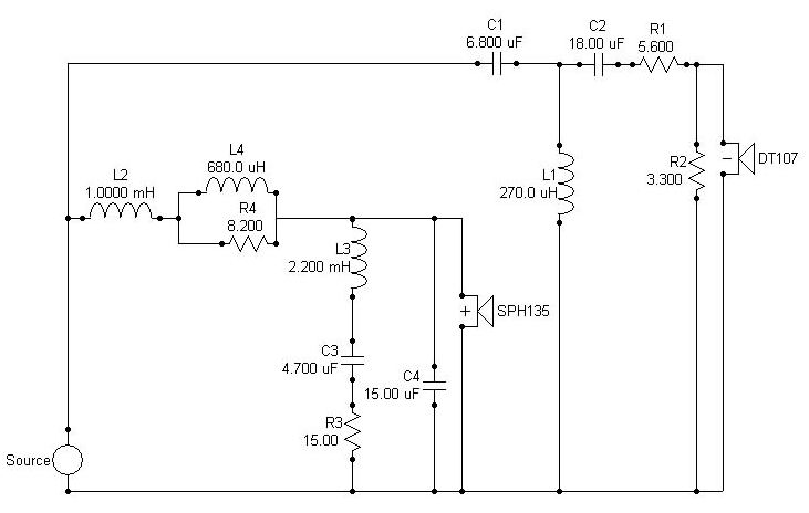

Made some progress on the Monacor SPH135/AD bass notch as pictured below. It's 1.56 kHz to be precise. The rest of the crossover I would regard as a moveable feast depending how you want to do bafflestep and rolloff and I think it would be possible to work out a parallel trap equivalent. But do adjust cabinet volume for the precise driver.

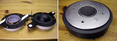

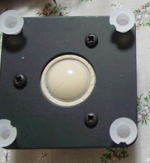

Mondogenerator raises an interesting point about the KEF T27 mylar domed tweeter. This is clearly a different animal from today's soft domes. Robin Marshall explains the objectionable oilcan tweeter resonance issue rather well.
Let's say that plastic coned tweeters were very different from today's fabric soft domes. I recall having my (blown) Isophon KK10/8 plastic tweeters apart. Damping was a piece of BAF wadding actually glued to the dome and magnet and filling the space. Similarly Wharfedale tweeters used glued BAF in the same way. Fact was once you took them apart and broke the glue, you'd messed them up. 😱
Fabric domes use foam or felt damping material too, but it doesn't touch the dome at all and I believe the dome itself is damped. There is a saying that speakers sound like what they are made of. I suspect this is true.
I enclose the usual pictures to keep you interested. The KEF T27 spec is better than I thought. 900Hz resonance is impressive. 😀

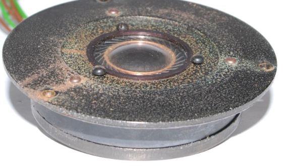

My understanding of the KEF HF drivers was this; they were originally designed as compression drivers, especially those with phenolic domes.
Personally I do not think the D27-45-06 is obsolete, merely that they have stopped producing it; although I would like to see it made "as is" using Neo ring magnets to retain the large rear cavity.
I do think you are sidetracking us here Moondog55. 🙂

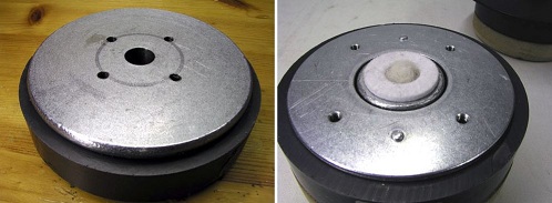

IIRC the Celestion HF1300 was the compression driver:
But it seems the HF1300 was the basis of the current Vifa tweeters:
Quite interesting that the Coles 4001 supertweeter was originally a STC microphone. 😎
Edit: Good Grief. This is like discovering that fish (The Coelacanth...LOL) that was thought to have been extinct for 100 Million years. Coles still make a HF1300 equivalent. The CE 3000 Tweeter: http://www.coleselectroacoustics.com/drivece3000.shtml

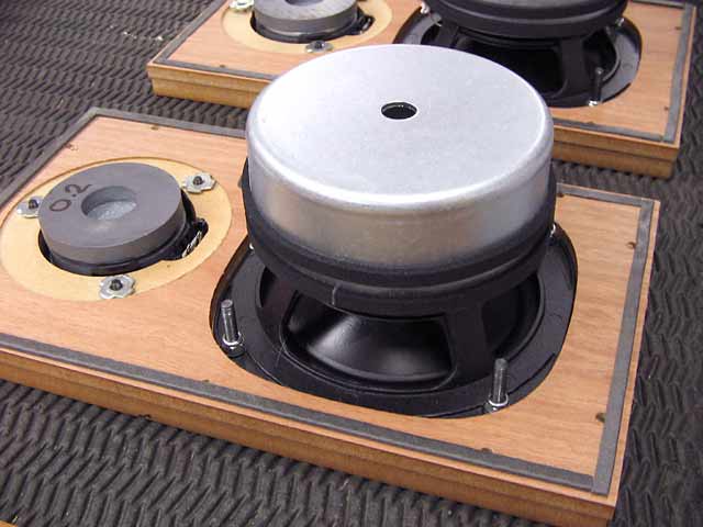

Here's another take on what can be done with the LS3/5a design.
So many years ago(!) my wife and I walked into an audio shop in Palo Alto, CA, to buy some Dahlquist DQ10's and walked out the proud owners of some Rogers LS3/5a's at nearly half the price. We were highly impressed at the time as so the sound and imaging of the LS3/5a's.
Many years and many sounds passed, and my beloved LS3/5a's were sounding a bit long in the tooth. Drivers are physical things that age. Rubber surrounds get hard, wires get brittle, and so on.
So when I blew my T27 tweeters playing Tubular Bells, I immediately ordered replacements. But because I live in a part of the world that makes it a little more difficult to acquire things from foreign lands,. I was stuck without music until the T27's might arrive from England carried as luggage by a friend.
A search for drivers available in my country that might be substituted for the T27, I happened upon some that are used in the Zaph ZA5. After a few false starts, I ended up putting a Zaph-inspired Vifa DQ25 in place of the T27's. I crossed them over at around 3kHz. Sounded wonderful, perhaps even better than the T27's.
So then one of my KEF (B110 SP 1003) woofers began to show its age. The voice coil was rubbing against metal occasionally, causing distortion. I turned the woofer upside-down, and that seemed to fix the rubbing, but things still didn't seem right.
I finally decided to build a complete sealed Zaph 5.2 system into my Rogers enclosures.
I couldn't be happier with the result.
The only change I made was caused by the inavailability of a 2.7 mH iron core choke where I live. So, I wound an air-core version. It measures just under 0.7 Ohms as opposed to Zaph's specified 0.2 Ohms in his crossover schematic. After listening to the sound, I decided that the math I worked out must be quite close. If you add 0.5 Ohms in the low end, you end up 0.3 dB down. So today I added 44 ohms in parallel with the 2.5 ohm resister leg in Zaph's crossover. Listening tests this evening seem to indicate this is just about right.
After I added the Vifa tweeters but still used the B110's on the low end (crossed over around 3kHz), I was highly impressed with the treble, but the mid-low-end still seemed bloated while listening to music such as London Elektricity's Pull the Plug. On the other hand, Anton Quartet's Tchaikovsky had never sounded better.
So I finally built the sealed Zaph 2.5 into my Rogers LS3/5a cabinets. I show some photos below of the Rogers with only the Vifa tweeter as an experiment, the associated crossover, plus my Zaph 2.5 in the Rogers cabinet.
It sounds so good to me at the moment, I don't think I want to go back to the KEF drivers, even though they've finally arrive.
The Zaph drivers and crossover have brought back some of the spine-tingling shivers that I felt when I first bought the Rogers LS3/5a's. I now have less distortion, a similar sound-stage (if not better), and a much better look into the quality of the recording and mix. I now love listening to well-recorded and mixed music more than ever before.
