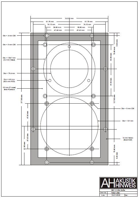

I am not sure that obtaining birch ply is that much worth the effort. Most BBC designs date from late 60s/early 70s so they tried to make the most from materials that were readily available then. A friend of mine built LS3/5a from Wilmslow kit 20+ years ago and used 12mm ply for sides and 9mm front as described in instructions but had problems with KEF drivers that were substandard in quality (although original B110 and T27). So all the efforts concerning cabinets were in vain. Since original drivers are not available, and you must use different drivers, I am inclined to think that emulating cabinets will probably be waste of time.
Although Harbeth still use thin wall construction (BBC style) I am in doubt if the sound of their products is that much owing to it. I think that drivers used and crossovers tuned for particular loudspeaker have more to do with it.

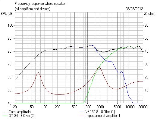

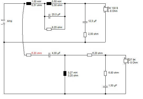

This is basically a 1st. order crossover with Zobel on the woofer. Not so acurate, but lively sound I'd reckon. Troels would be aghast at the unrebated tweeter. 😀

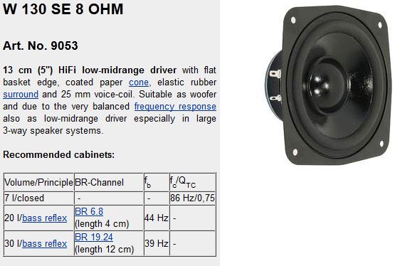

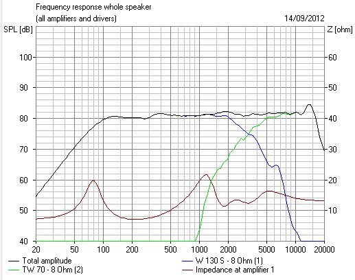

I've found a Visaton 5" 0.6mH paper driver that will fit the Falcon Acoustics plywood cabinet with a slight issue on the bass fixing screw holes but you could fill those with a bit of wooden dowel and redrill them, I reckon! 😎
Visaton - Lautsprecher und Zubehör, Loudspeakers and Accessories

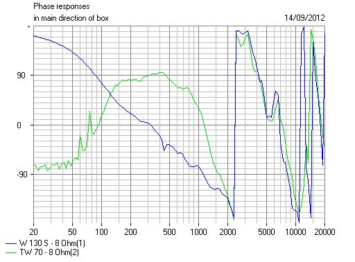

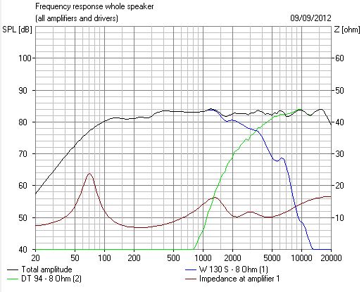

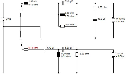

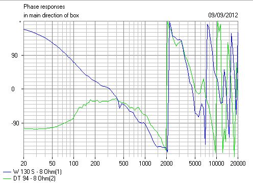

The Visaton W 130 SE 8 ohm. It's really a W 130 S in a different chassis, and you can model it just like a W 130 S. I did this (rough) modelling in Boxsim with front mounting on the baffle as a 5 litre standmounter with a 1.4kHz trap and it all worked out nicely. Looks easy to adapt for any tweeter you fancy to me. 104mm would be ideal. It's hard to source in the UK, but I expect you could get it easily enough from the continent.

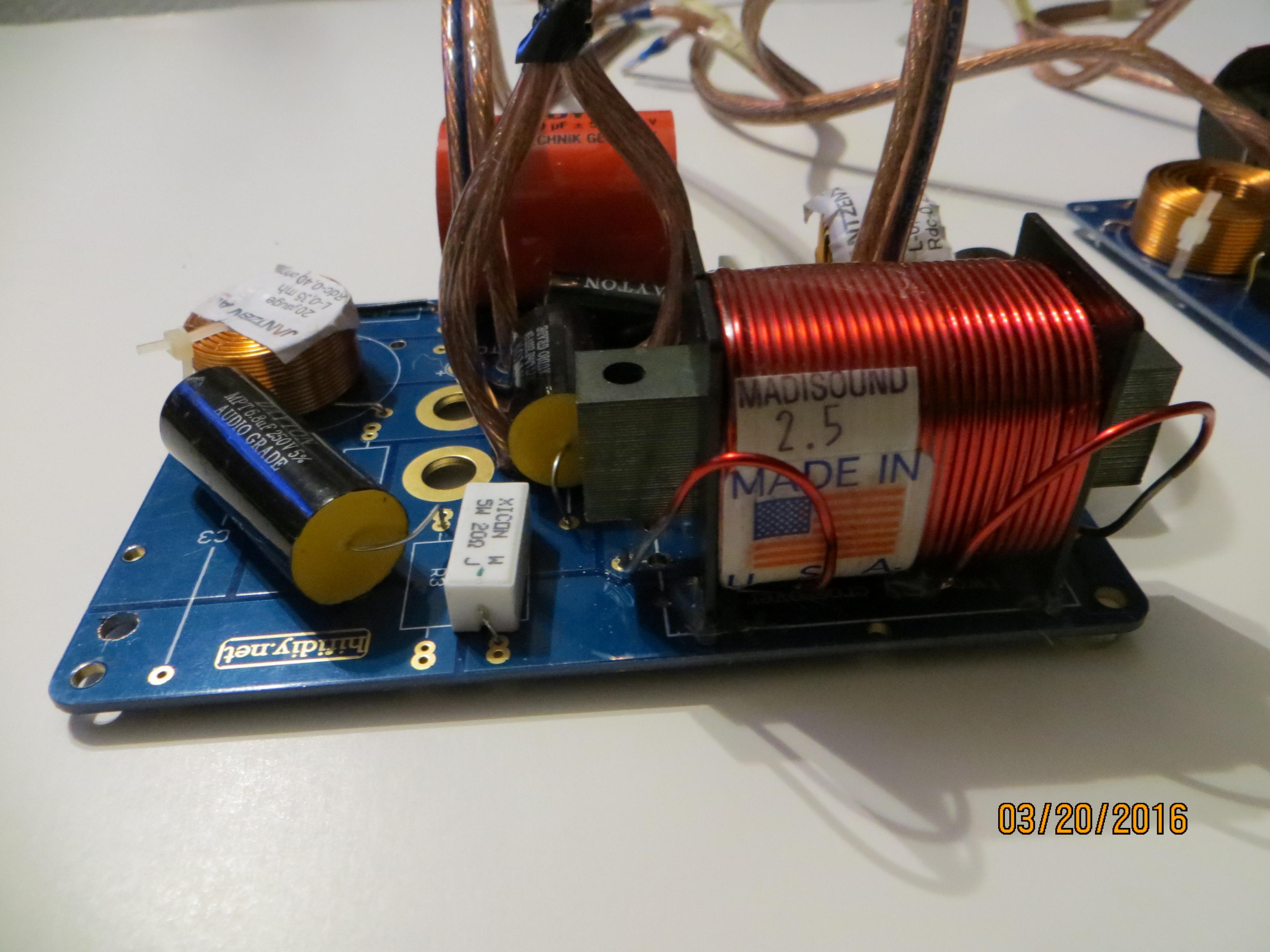

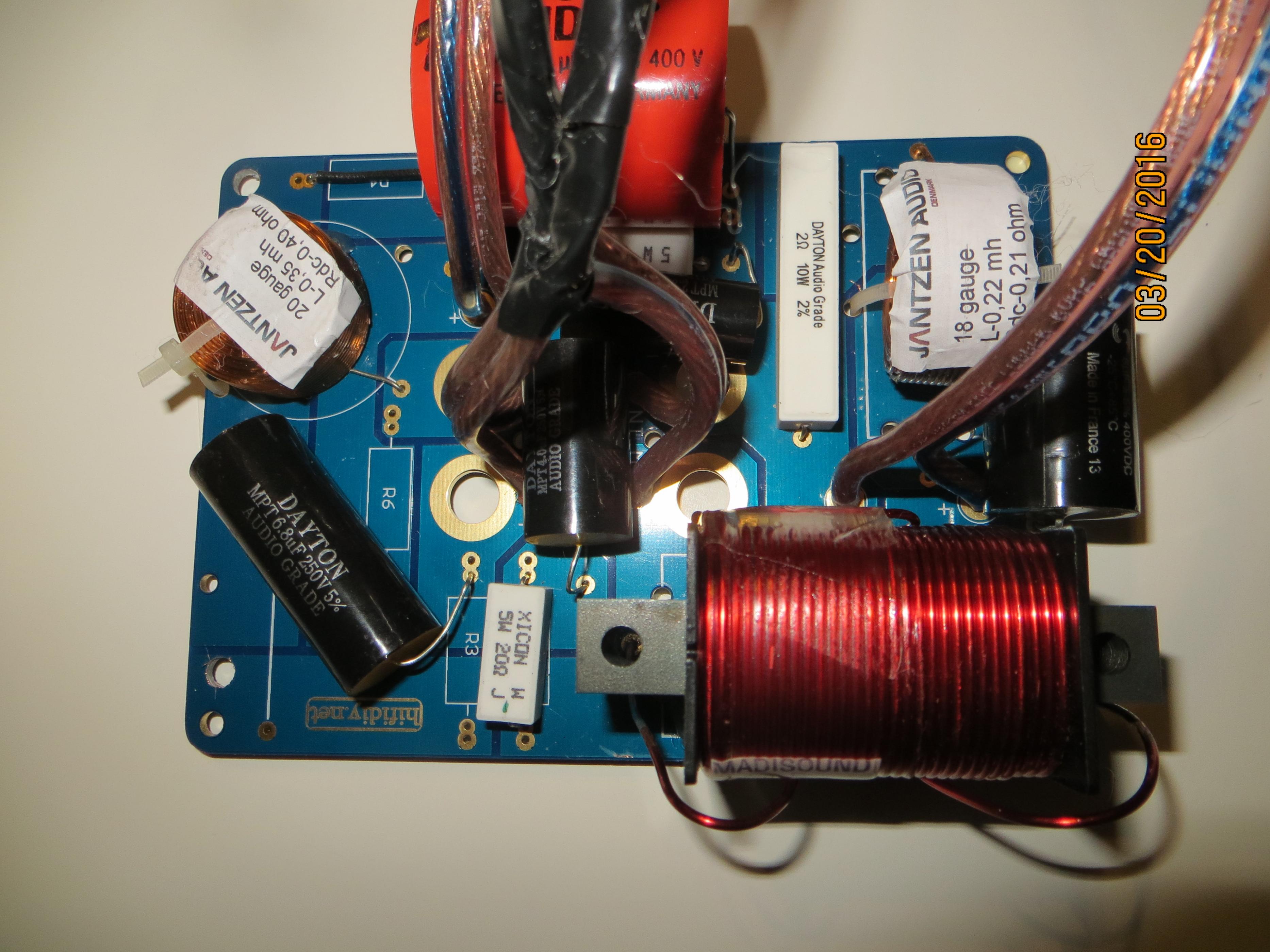

Jeff Bagby made a decision to keep the Continuum crossover design proprietary for commercial purpose. I fully support his decision. There are many sources of the whole kit.
But if the builder wants to get their own drivers to do customized matching etc. There is no source for the crossover only kit yet. It would be nice to have a commercially available PCB for the crossover too.
I found a PCB on Ebay that may work well. I used 2 pairs for the 4 bookshelf I built. This PCB may be a good fit for the Continuum crossover design too. They are not cheap at $26 a pair, but the quality is excellent.
