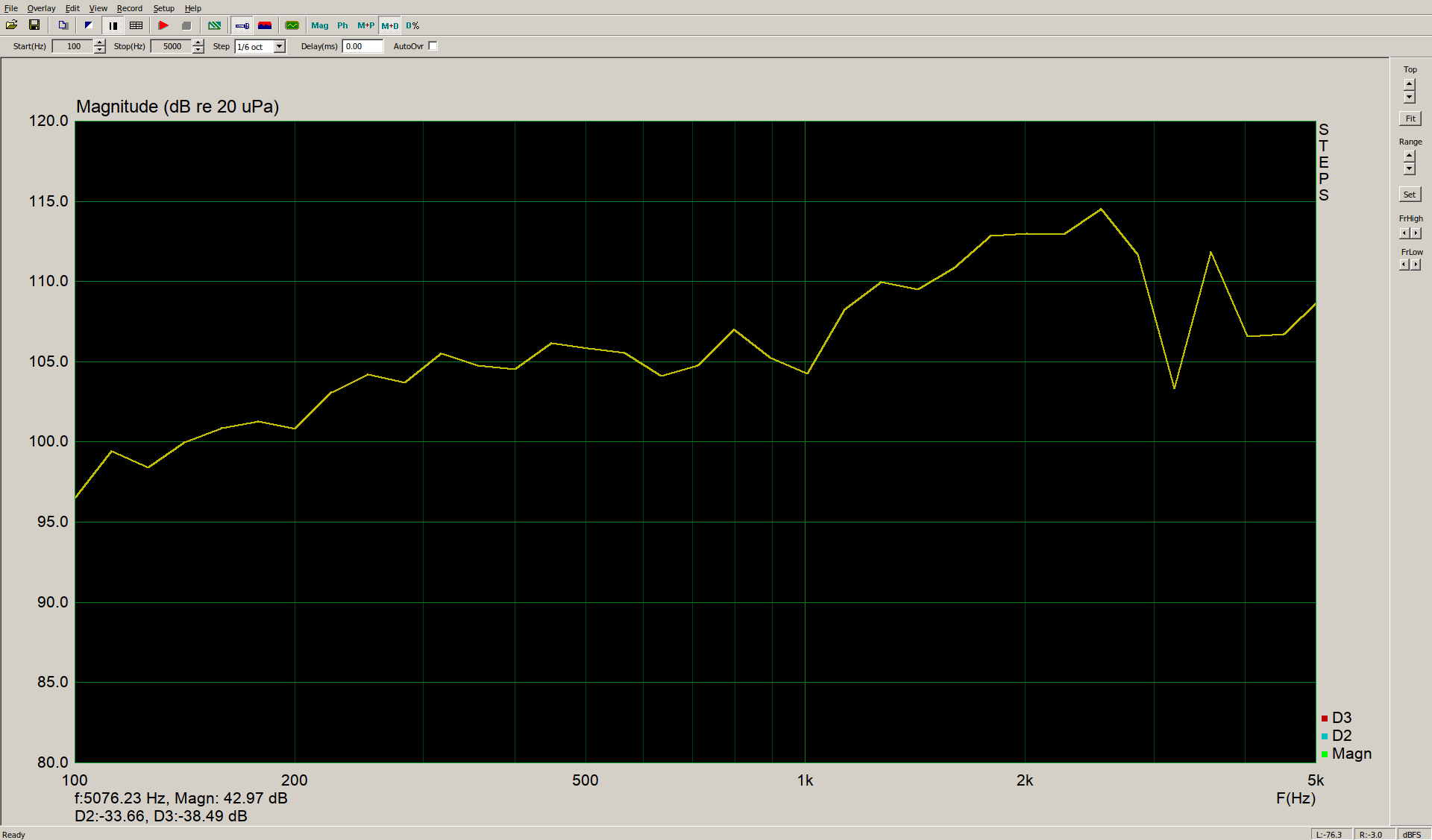

Carry out a measurement at a very moderate volume. Only the transducer in the box, directly connected to the amplifier. [1]
Save this measurement to overlay. [1]

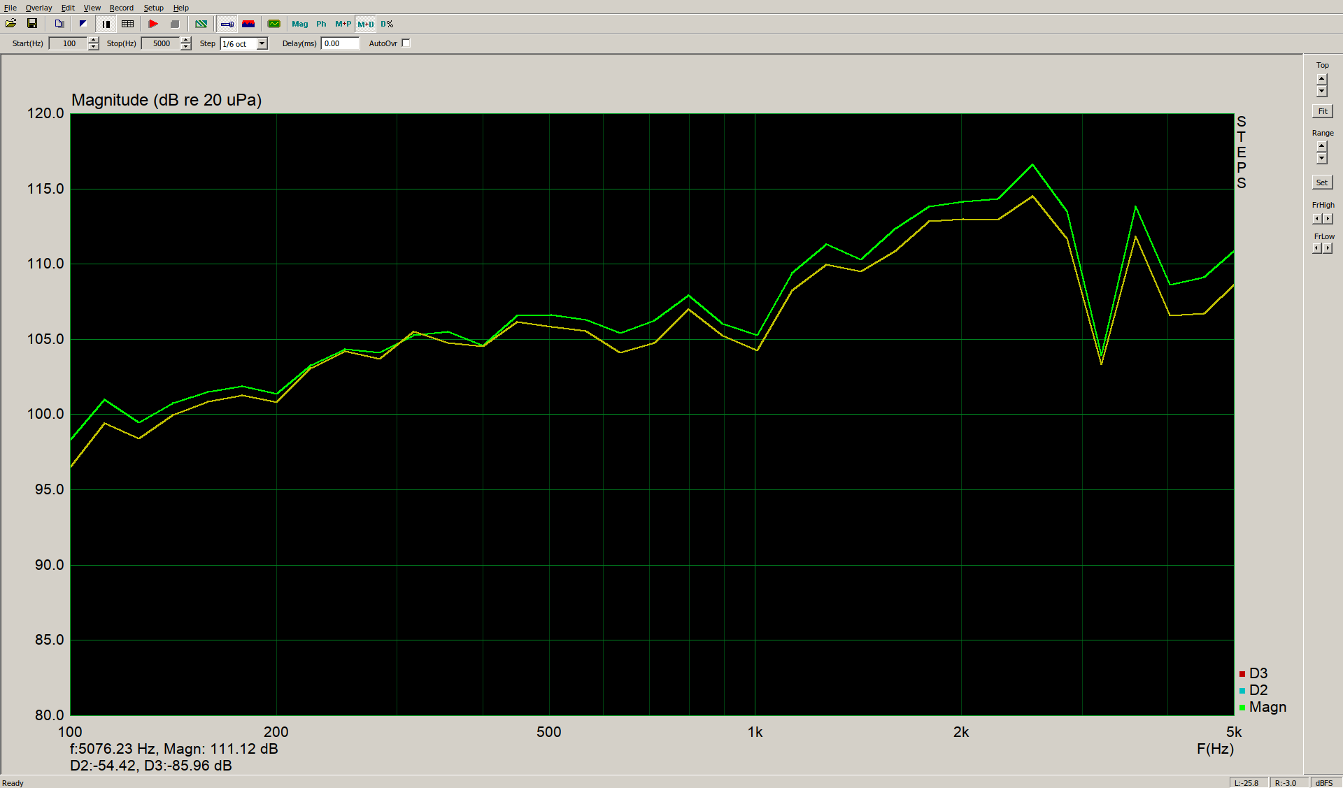

Then insert the 20R resistor. In series to the transducer. Carry out a second measurement. Increase the volume to approximately the same sound pressure level. [3]

This was done at 0,5 Volts at the transducer:
No need to blast your speaker!
[1] yellow is the fundamental directly connected (0R)

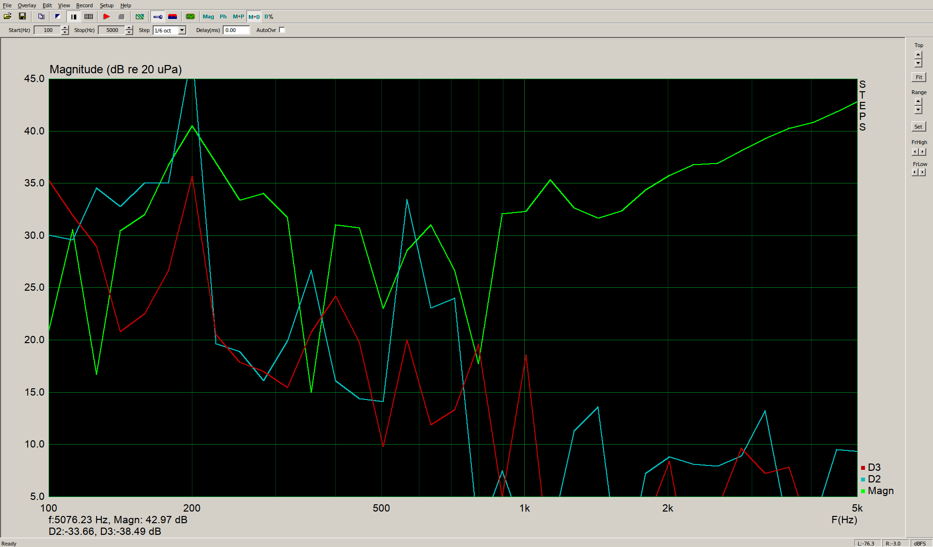

[2] Same setup, just disconnected speaker. Noise...
[3]
green is with 20R in series.
yellow is directly connected (from [1])

Where is the resonant frequency? The levels should be quite unequal around resonance unless your gain correction depends on frequency.
Where is the resonant frequency of your loudspeaker?Where is the resonant frequency?
Where are the levels of your Loudspeaker?levels should be

Coming back to Marcel's point: I would expect to clearly see the speaker resonance with the 20R drive on the freq response.
There's no sign of it, which makes the measurement suspect.

But this is very strange. Or did you do some kind of pre-correction?

Plot starts at 100Hz, resonance is probably below 30Hz. With 20R the increase in Q may be moderate. I think we see signs of response starting to rise at 100Hz. Lot's of guesswork.Coming back to Marcel's point: I would expect to clearly see the speaker resonance with the 20R drive on the freq response.
