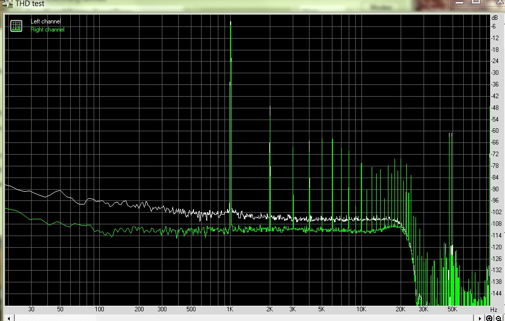

Thanks for the measurement. This amp has BTL output, did you measure it differentially or just single end output. For the even order harmonic distortion, measure it differetially, you can get different result from measure it single-endedly.
I measured TA2024 chip amplifier before, single endedly, the result is not good, especially with dummy load. But that is before I change the output inductors, which make sounds as the music you play(source of extra nonlinearity).

My test result
This is a MUSE amplifier with TA2024 chipset, with one modification is that it is powered with 12V 2A switching power supply buffered by a Capacitor multiplier(modified by myself), with an impedance under 40m Ohm from 20 to 20kHz.
It looks better, tested at level right before clipping. one channel with 8Ohm load, the other is without load. single-ended test results.

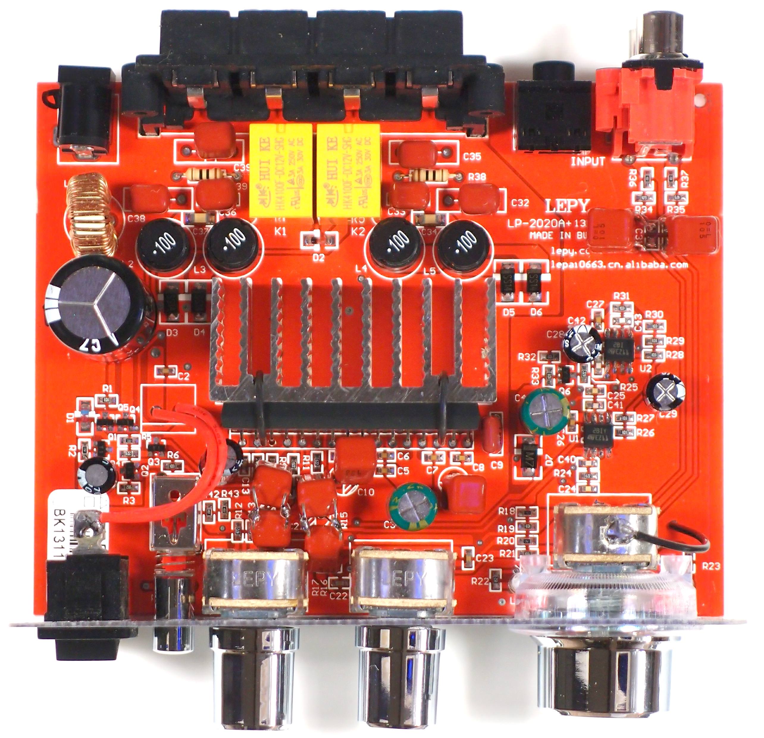

So I want to share with you guys how I swapped the parts of this little AMP. It finally arrived and is built with very cheap parts, actually it's a crap low quality peace. I directly swapped almost everything and it now sounds beautiful 🙂
Here is the part list:
Audio input smd caps C30 C31 near the input RCAs and the audio input caps to Tripath chip C20 C21 - replaced with Wima 2.2uF 63V 10% MKS2
All electrolytic caps replaced with Low ESR ones - I have here only Taiwanese HITANO Low ESRs so no other choice for me. The main power filter C1 was replaced with 4700uF one and additional ceramic cap 220nF 50V X7R P5 added at the bottom side of the PCB. The values of the other electrolytics are kept like the original.
The power input choke L1 was swapped with Panasonic 3.3UH, 0.016OHM, 5.2A.
The audio output chokes L2 L3 L4 L5 - swapped with Panasonics ELC10D100E 10UH, 3.9A, 0R026
Audio output caps C32 C33 C36 C38 swapped with Wima 470nF 63V 10% MKS2
These two changes are according the datasheet of Tripath:
Audio output caps C35 C39 swapped with Wima 220nF 63V 10% MKS2
Audio output resistors R38 R39 - swapped with 10 Ohm 1/2W
It seems the board was purely designed with equal caps in the output section but I decided to follow the datasheet for 4 Ohm speakers 🙂
I replaced too the two smd caps C34 C37 with Wima 10nF 63V 10% MKS02 which I placed underneath the PCB (it was easier for me)
C9 replaced with Panasonic ECW-F2W104JAQ .1µF 450V
Finally I decided to try the AMP with the default OP AMPs after all these changes - it sounds beautiful with my Microlabs SOLO7s converted to passive 🙂 I was surprised how nice and powerful it was and with clean sound. The audio feed is from Asus Xonar DX, the power source is 12V 6.5A power supply brick for LEDs. For now the AMP is good enough for me and I left the OP AMPs unchanged. However the mentioned problem with power On/Off popping sound is present. If someone has a solution to that, please share it with us.

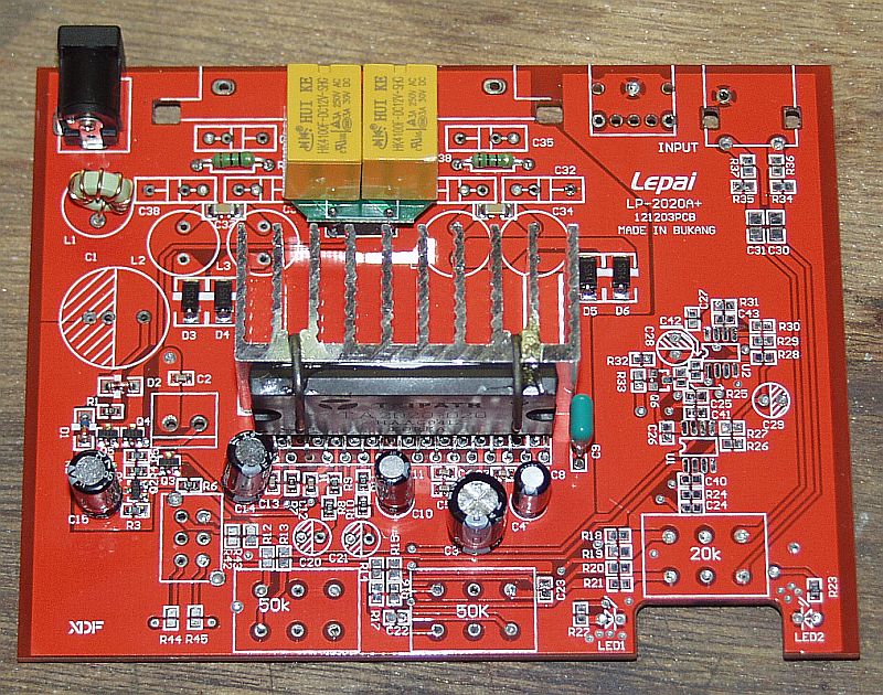

I needed a small amplifier and ended up purchasing a Lepai LP-2020A+ 20W unit for US$21. At first listening I was not impressed so decided to incorporate some of the suggestions from this forum as well as those on the Parts Express web page.
The board in my unit was marked Lepy LP-2020A+ 131005PCB. This is a more recent version than some of the boards in earlier discussions. I concentrated on the input op amps and the signal-coupling capacitors. In addition I replaced the output inductors. I'm not sure how much of a change the inductors made but at least I now know the specs on the parts. Finally, I updated some of the supply decoupling capacitors. I also added some 0.1 uF chip caps on the bottom of the board between the leads of all the decoupling electrolytic caps. At audio frequencies I don't think this makes much of a difference but I had the parts in the junk box so decided to use them.
A photo of the modified board is attached. The sound from the amp is significantly better and meets my needs. I'm quite happy with the $17 investment in the upgrade parts.
