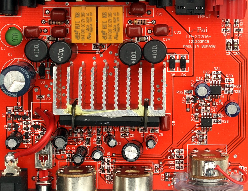

I have the latest double-relay Lepai+. I'm wondering two things:
Is it really worth upgrading the caps? Unlike reports of the awful appearance of caps from previous threads, this one seems to look pretty good. Perhaps they are just fine, or at least good enough. Should I even bother doing anything else to it? It doesn't seem so clear cut, reading this particular thread.
Is it worth correcting the dc offset? I have 79mv on one channel which I'm lead to understand is well in to distortion territory. The problem is that I'm not knowledgeable at electronics and the original dc offset correction guide is for a much earlier version, and no one has seen the need to do it for late versions.
My version is the attached pic, with the double relay.

NO!!! It is NOT worth it!

Yes. If I had a new one, the main change I would make is to change C20/C21 from electrolytic to a film cap of any kind. Besides bypassing the garbage preamp op-amp section again.
I agree. I learned a lot from modding these things. Bypassing the op amps and replacing the input caps helped a lot.
I also noticed a big difference with replacing the output inductors/caps. Inductors were hand wound to 10uH +- 1%. The ones that came with the amp were garbage and the eBay ones I bought were 6-12 uH... All over the place.
Only problem I have now is the DC offset. Anyone know how to fix this? I have about 100mA on one channel and about 40mA on the other.
