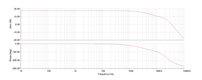

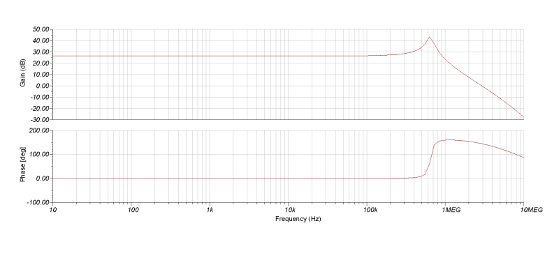

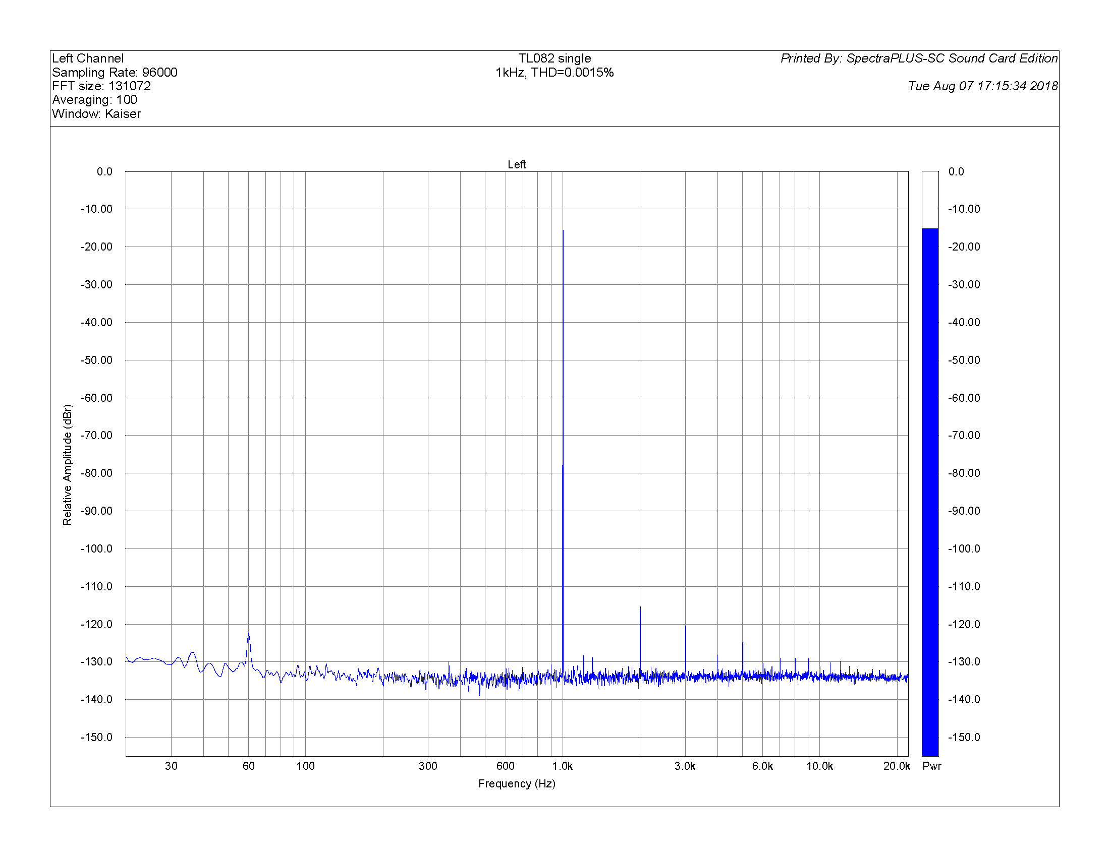

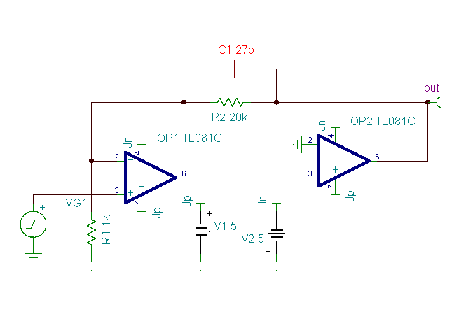

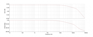

Thank you all for the recommended reading.
So far, I read the TI app note recommended by KSTR in post #46 above. I found it very compact and accessible.
As an exercise, I designed, simulated, and built a composite amp with a gain of 21 with two halves of an TL082 - see attachments. As predicted, it oscillated without compensation, and properly compensated, it demonstrated very different distortion behavior compared to a single half of the TL082. The measurements below were taken at approx 8Vrms output level, just below clipping.
