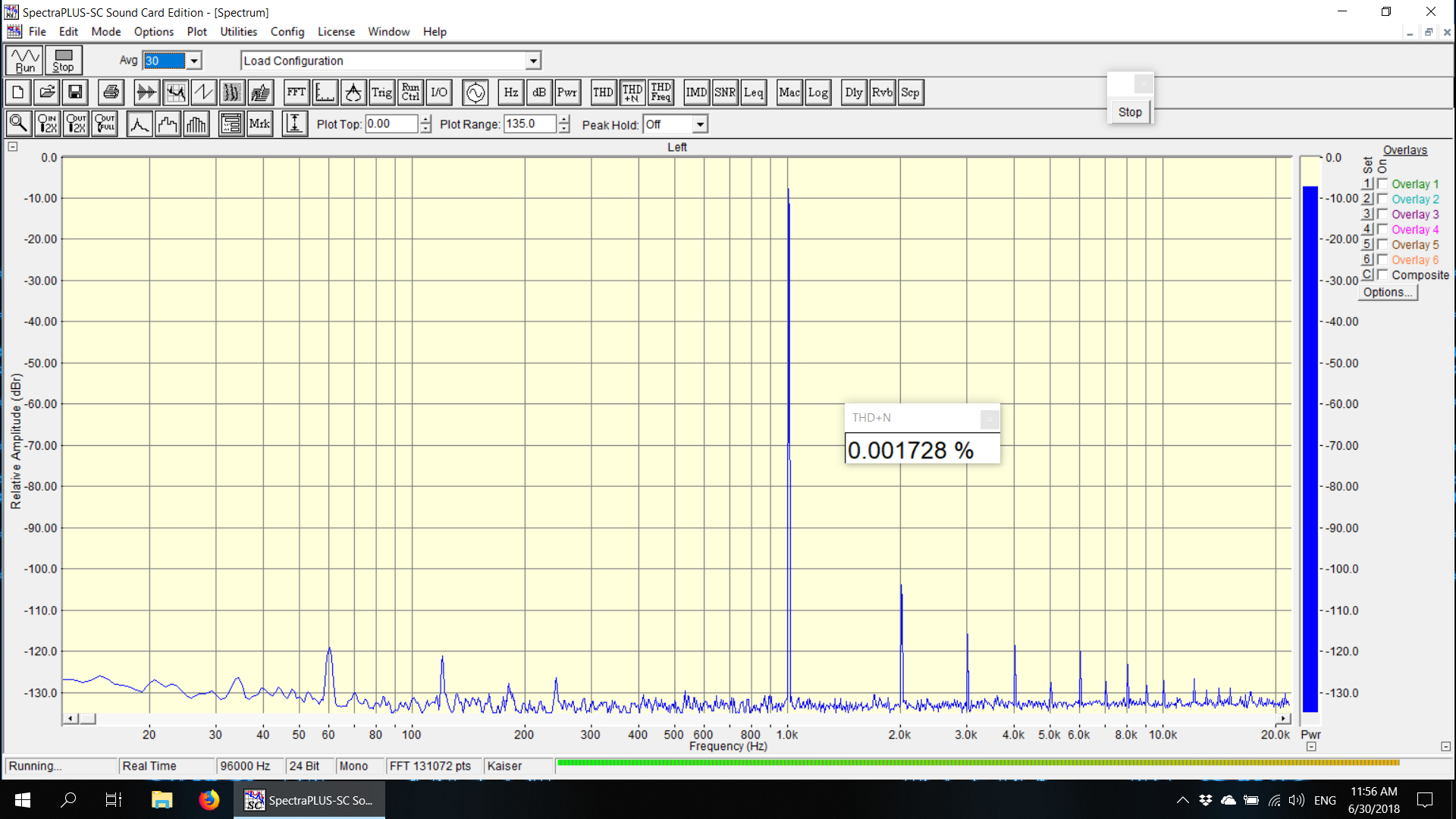

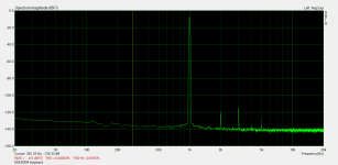

I attach a pic of my amp at the same output (25vp, 50vpp) to give you an idea of what could be hiding under the noise floor. But it's so down under...

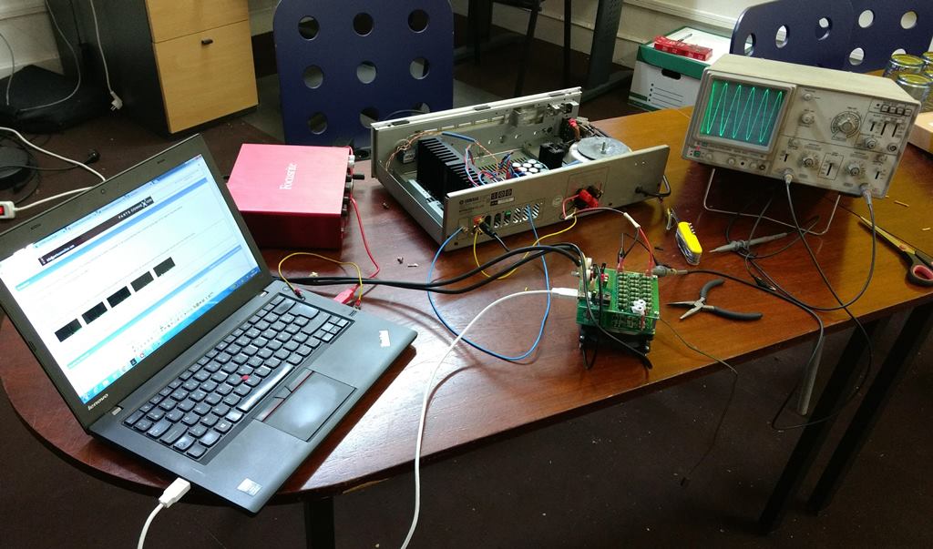

What is you measurement setup?
A focusrite 18i8 and a dedicated load. It's very similar to your setup actually, the load is kind of a simplified version of the Millet interface.
I use a scope to check the amp output levels. Most measurements are made so that the input going into the 18i8 is at -5dbfs (knowing that the 18i8 inputs max out at +16dbu).
Thank you.

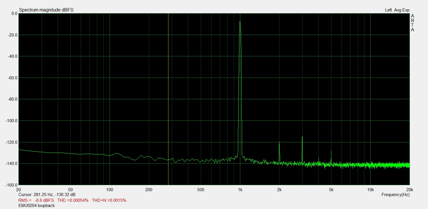

The setup is indeed quite similar, as are the specs of the soundcards, yet your noise floor in the spectrum atatched to your post above is 10 to 20dB better than I can get from my soundcard connected to itself, without the interface. Curious.
Are you certain your soundcard is operating in 24 bits ? Windows can be tricky...
Thank you - for the second time, you point me in the right direction 🙂
The card used 24 bits, but ARTA used 16-bit dithering. With 20 bit dithering, the picture is somewhat better - see attached. This is just the soundcard by itself.

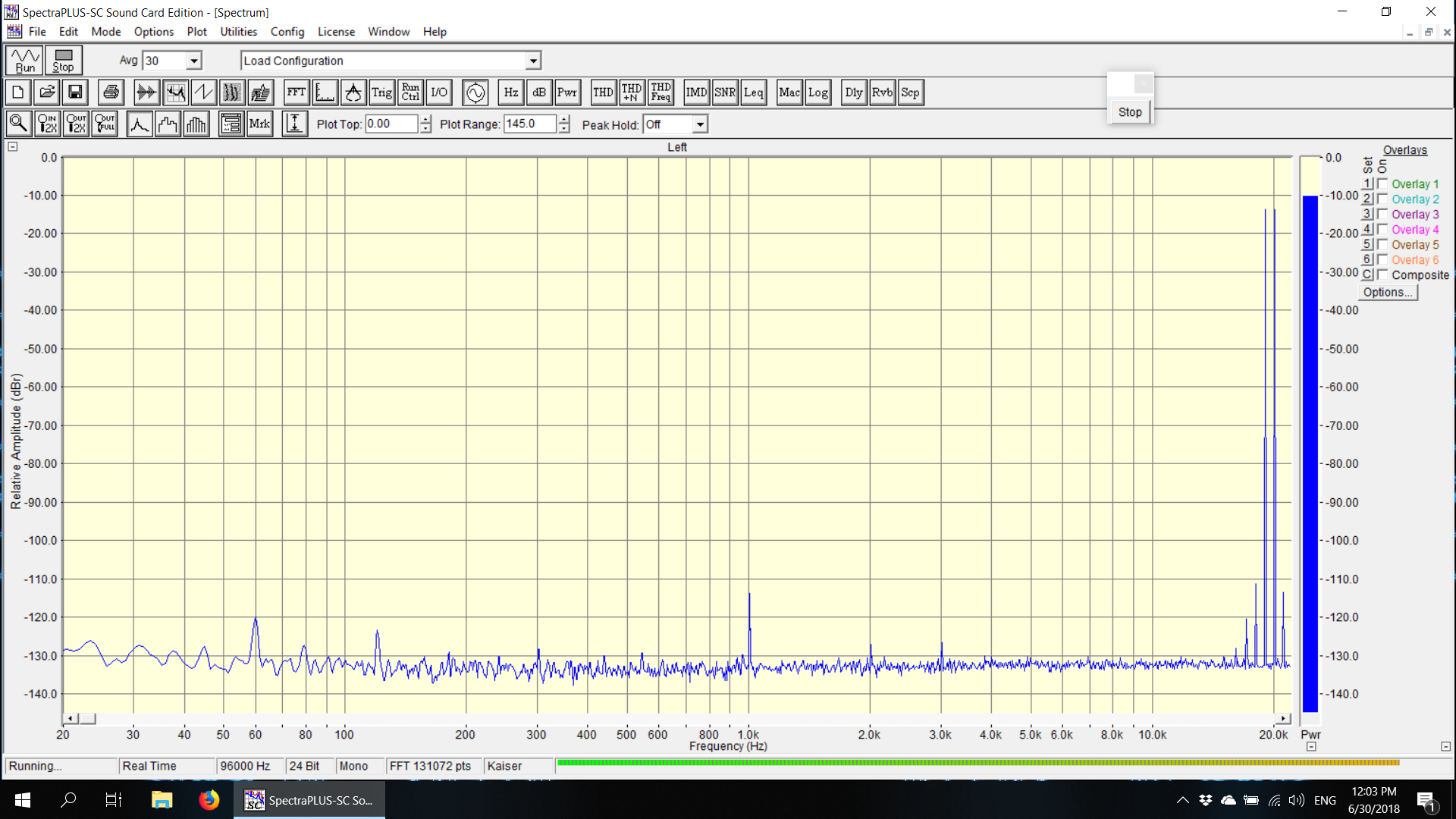

And here are the spectra of the amplifier as before: simple unregulated power supply, 18.5Vrms (about 43W) into a 8ohm resistor.
Here I am using Pete Millett's soundcard interface, but switched from ARTA to SpectraPLUS for FFT processing.

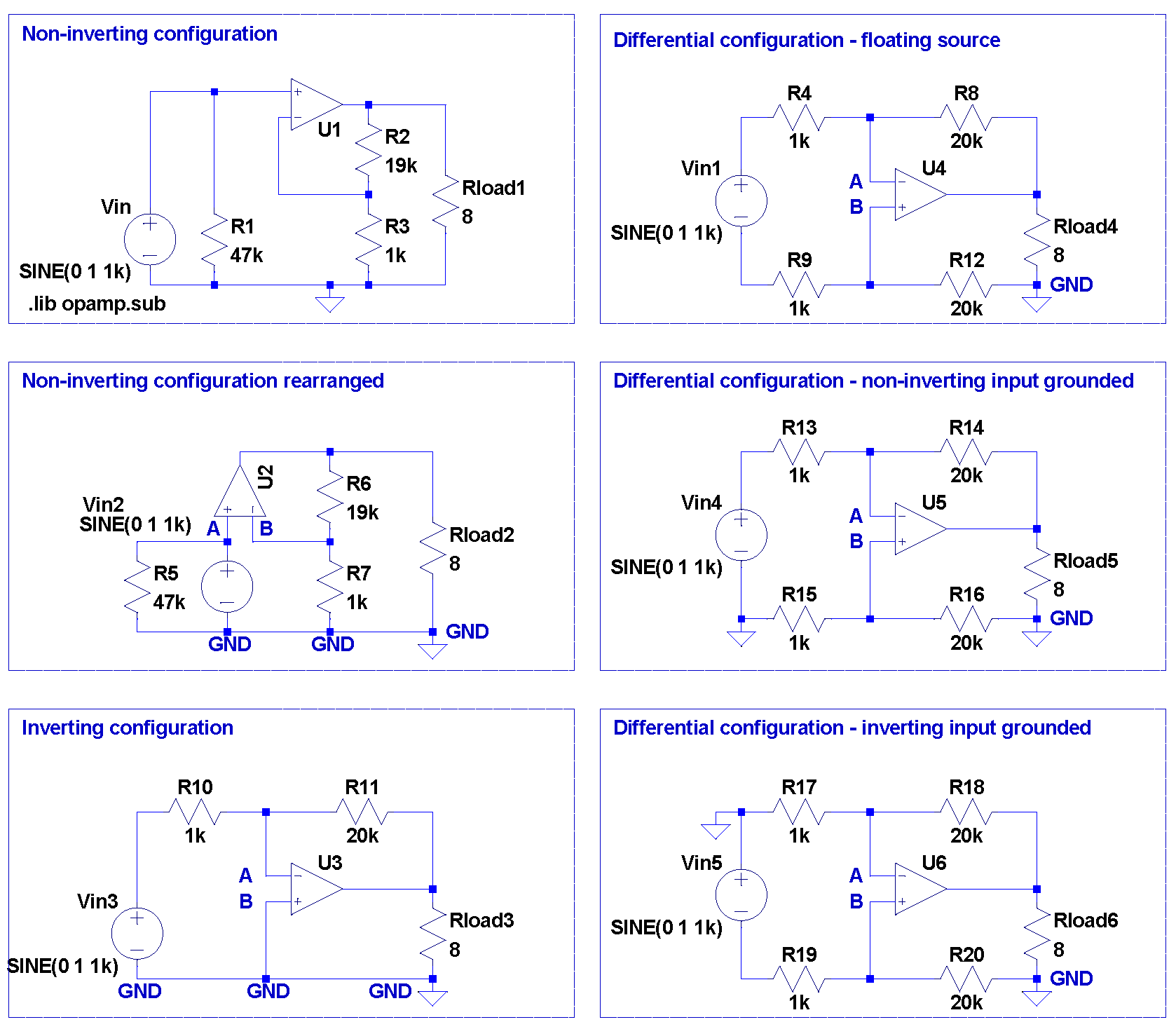

Inverting vs. non-inverting vs. differential configuration
I got some questions regarding the best way to do the grounding of an amp based on my board, and based on that, it makes sense to explain the differental chipamp configuration used by the board.
The datasheet recommends, and virtually everyone uses, the non-inverting configuration - see the top left corner of the attached illustration. I rearranged it to make it clear to myself how it works - see the middle left block - so maybe other find it helpful, too. In this configuration, the opamp (such as an LM3886) strives to minimize the voltage between points A and B by driving its output appropriately. A is the input signal, referred to GND. B is the output signal divided by R6/R7, also referred to GND. it immediately follows that, for a proper amplification, A and B must refer to the same GND - that is, the three GND points (the input reference, the power ground/output reference, and the bottom end of the R6/R7 divider) must be one and the same point. This may become problematic if these points are in fact physically separate, such as in a multichannel system. Separating the grounds will generate all kinds of problem, commonly called ground loop issues, for which there are more or less effective remedies and workarounds. A subtler problem is that the input capacitance of the opamp is non-linear and changes with input signal, introducing distortion via nonlinear input current - some call it common mode error.
The common mode error is dealt with in the inverting configuration (bottom left block on the illustration), where the voltage between A and B is always zero and the input capacitance plays no role. Because of this, the inverting configuration is almost always used in high speed circuits. However, it features low input impedance (equal to R10) and suffers from the same single-point-of-reference problem as the non-inverting. With the LM3886, there is one more issue: if the output is left floating, the gain of the circuits becomes unity, and LM3886 is unstable when the gain is below 10. Because of that, every circuit using LM3886 in the inverting configuration drives it with some buffer with low output impedance - see this one, for example.
My board uses a differential configuration (right column on the illustration). Here, the input reference and the output reference are completely separate and do not need to refer to the same point at all. The input may be left floating or grounded at either end, it makes no difference. You obviously need to ground the output because that is where the power ground is connected. Input capacitance plays no role because the charge currents for the input capacitance cancel. Quoting Bruno Putzeys in his article referenced in my first post, "Whoa. Not only does differential circuit design do away with current loop problems, it actually eliminates a significant source of distortion. If panaceas exist, this must be one of them". Differential input impedance is high, as is the input impedance with the inverting input grounded, although not as high as one can have in a non-inverting circuit. You still need to either ground or drive from a low impedance source the inverting input for LM3886 stability.

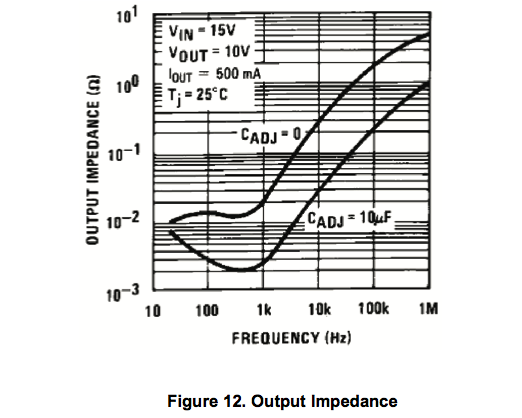

I was thinking of implementing some kind of basic filtering on PSU section of my LM3886 board I play to play with.
CRC and CLC come to mind with CLC being very effective with HF filtering but both options increase power supply output impedance by R component that possibly might affect LM3886 in a negative way since it is a class AB(I actually have not done any measurements, but I would be very interesting how output impedance of PSU affects performance of the chip).
Even CLC is not without problems since some R component is needed in L to stop the low pass filter peaking around corner frequency.

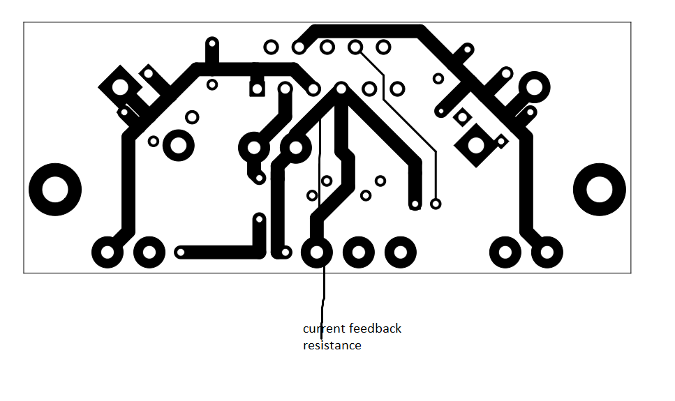

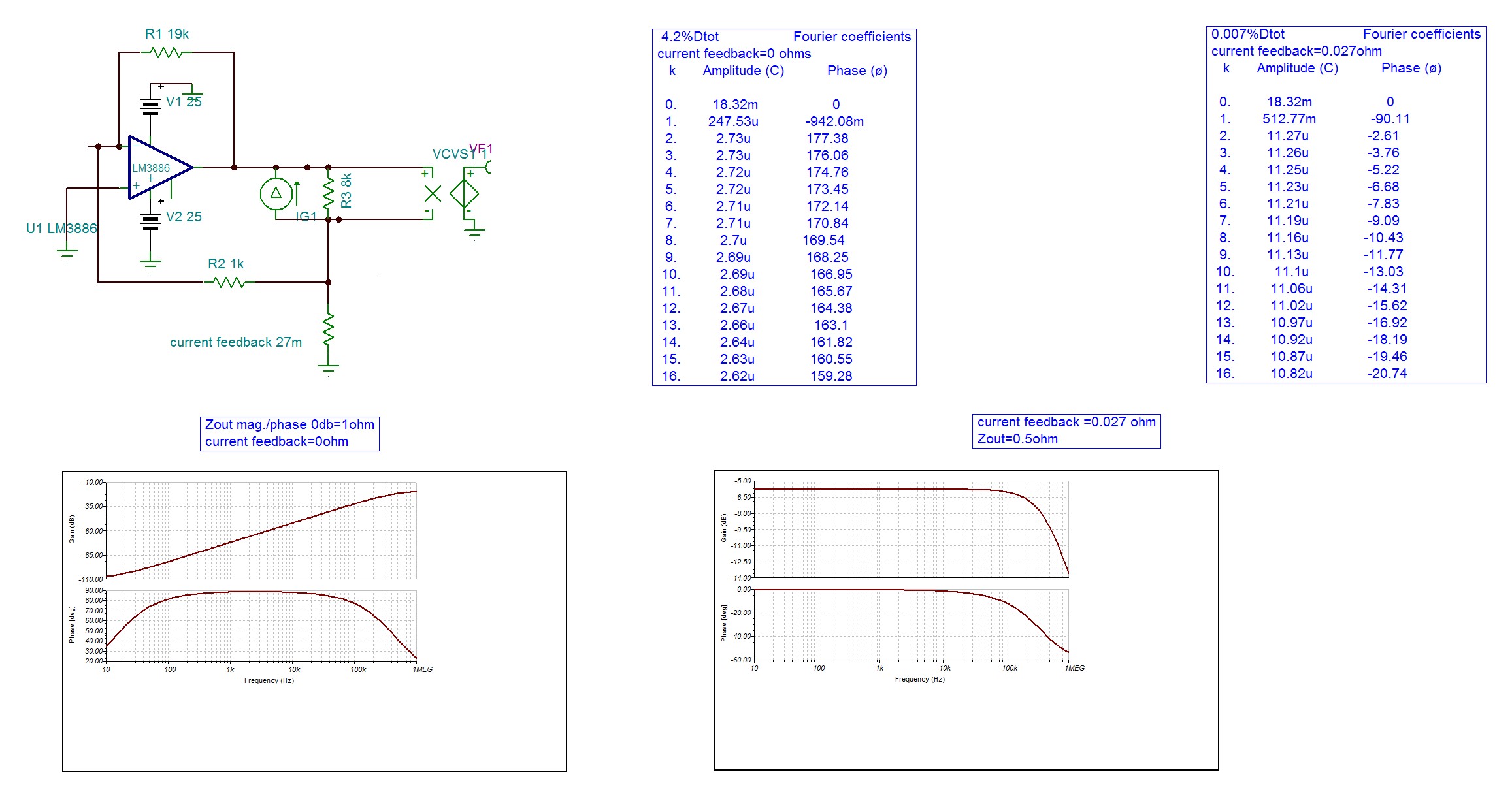

You have followed my advice of adding a negative current feedback explained in. Why Let an Amplifier Sound Good when You can Force it to?
By joining the -IN to the star point instead of the OUT G you added some milliohms resistance made of the strip linking the OUTG to the ground .
I have not, and it's not on my to-do list for now. Although the amp may benefit from a low output impedance power supply, I believe building a high current regulator with consistently low output impedance across the audio range is non-trivial. In any regulator, an error amplifier tries to force the output up or down by comparison with an internal reference. As the error amplifiers gain falls off with increasing frequency, so too does the regulators accuracy and output impedance. See, for example, the output impedance of an LM117/317, taken from its datasheet. Moreover, the impedance that rises with frequency makes the regulator behave like a synthesised inductor, which forms resonant circuit with downstream capacitors, with effects on audio performance.Did you try your boards with regulated PSU?
Filtering sounds like a no regret move, and I used CLC filters (heavy and bulky) in low/no-global-negative-feedback amplifiers, with clearly audible improvement. Douglas Self in his book recommends in particular filtering the rail which is used as a reference in the second (transimpedance) stage of power amplifiers.

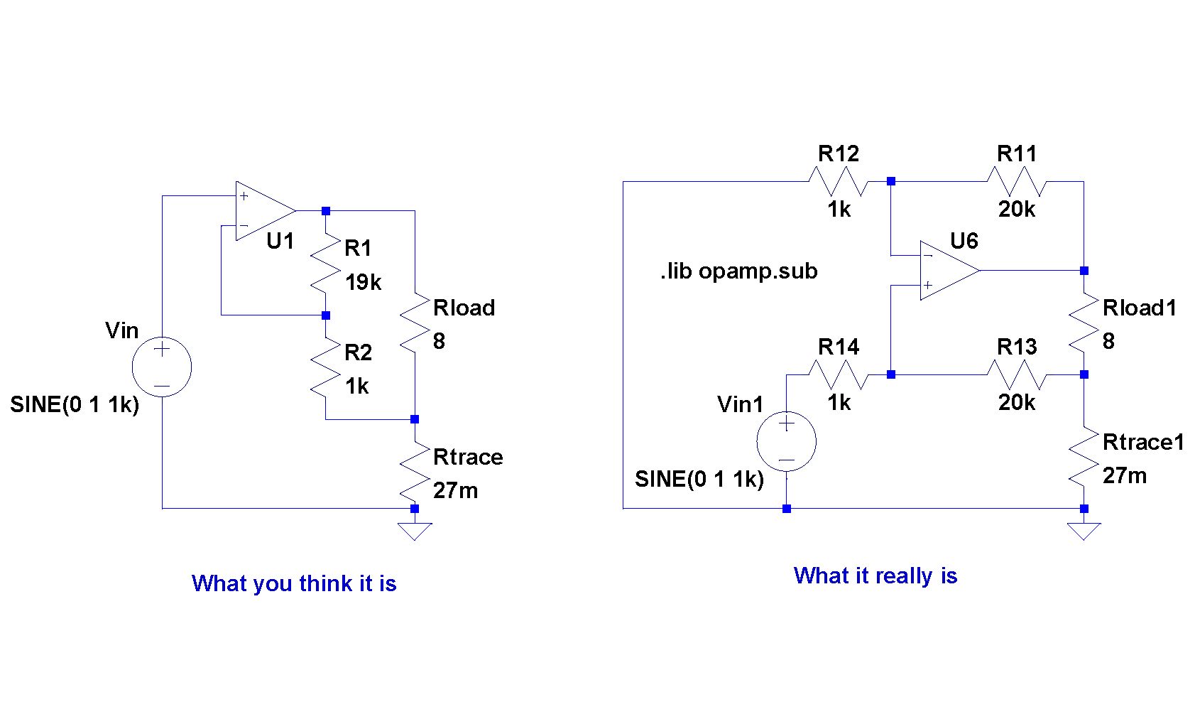

my real circuit diagram
As I tried to explain earlier in this thread, I used a differential topology, not the usual non-inverting one - see the attachment. There is no star ground, no implicit current feedback and no reliance on the impedance of wires or traces.
Looks like pin7 is the star ground. I think the point that is being made is that input and output grounds should be connected so that Rtrace is zero.
Pin 7 looks like a star ground on the PCB but is not a star ground in the sense it is not used as a reference point for any signal. (Pin 7 is the return pin for the muting current).
The commonly used non-inverting topology relies for its proper functioning on several points in the circuit (bottom ends of the source, the load, and the feedback divider in the schematic in my post above) having exactly the same potential. Rtrace, although small, is always greater than zero - on my PCBs, the calculation gives about 2mOhm. That is 0.025% of the nominal load impedance, and its effects can be measured and heard.
If I understood correctly, kokoriantz makes the point that trace resistance can be used to provide some negative feedback based on the output current, which would increase the output impedance of the amplifier but make it less frequency dependent, which in turn would improve the sonics.
I find this idea very interesting, but my board is not relying on any trace impedance to be zero, and thus such negative feedback doesn’t exist on the board - which is one reason for the its low distortion.

Be at least honest.
Well. You asked. 🙂
It looks like you're missing at least one decoupling cap per rail. Also, the decoupling for the VEE pin is quite far away, thus not all that effective. I suggest taking a look here: Taming the LM3886 - Supply Decoupling.
Your supply routing is about the worst you can do for rail-induced distortion. You want the supply lines to be tightly coupled and low impedance. That means wide pours that come in side-by-side from the left (as the supply pins are on the left side of the chip). Douglas Self writes about that in his Power Amp Design book (and Wireless World article series that became the book).
You'll want to run your loop analysis all the way past the unity-gain frequency. Also, I suggest using a reactive load. At least run a few test cases with 8 Ω in parallel with 1 nF, 10 nF, 100 nF ... or better yet a simulated speaker load, such as the model Stereophile is using.
The star ground layout is great for controlling current flows. Unfortunately, it also features the largest ground impedance of any layout, which means you get the largest error voltages developed across the ground with that type of layout. To minimize the error voltages, you need to minimize the ground impedance (i.e. use a ground plane). The ground plane makes it harder (but not impossible) to control the current flows, so you will have to be more careful with your component placement to ensure that sensitive nodes are located in a quiet spot of the ground plane. An alternative is to use multiple ground planes and join them at the ground reference point. You can read more about grounding here: Taming the LM3886 - Grounding.
Yep. I'd expand that to Ztrace should be zero. I.e. minimize the inductance as well as the resistance. That's why I like planes and pours.

Star ground as being the point where power, input and output grounds connect together (pin7).
Where it is different than most is that the feedback resistor is connected to the input ground and the input resistor connects to the output ground.
I have been using a similar approach for a while now but the layout has a single point at the output.
I understand that. It's still not a good idea.
OK. The feedback current is not pretty. It contains all the error signal from the chipamp itself. From your description, it sounds like this error is then added to the input signal. That's not a good idea.
Which is usually where you want it.
