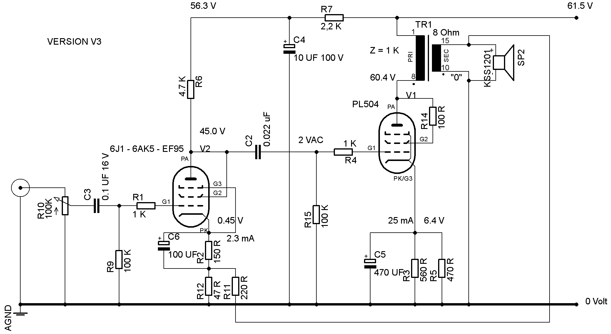

Here are the updated schematics. They include the last voltage measurements also. The amp has undergone some changes to improve the working of the 6J1 at 60 Volt.
The coupling capacitor between the 6J1 and the PL504 has been reduced from 0.1 uF to 0.022 uF. The 0.22 uF and the 100K grid leak resistor form a filter which will cut off the bass below 72 Hz. This will avoid saturating the OPT and will help to reduce distortion. I've tried feedback, but only a feedback resistor of 220 Ohm showed some effect, but I heard no real improvement. If tyhe feedback makes the sound louder, you have to switch the HT connections on the output transformer !!!
There is still some distortion when the amplifier is played fully open. The amplifier is not loud, but plays decent music with a reasonable amount of bass through my small desktop speakers. This is however no hifi.
This project is intended play around with tubes. In this porticular case with two 6J1's and two PL504's and two 24V power transformers.

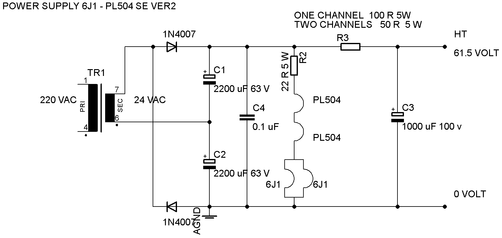

The power supply schematic is also depicted. The 24 VAC is rectified and doubled. This gives about 64 - 65 Volt DC. This is used to feed the chain of filaments.From there the HT is filtered using a resistor of 100 Ohm (one channel) or 50 Ohm (two channels), together with a 1000 uF 100 V electrolytic capacitor. The remaining HT measures 61.4 Volt. The additional filtering makes sure the amplifier is completely hum free.

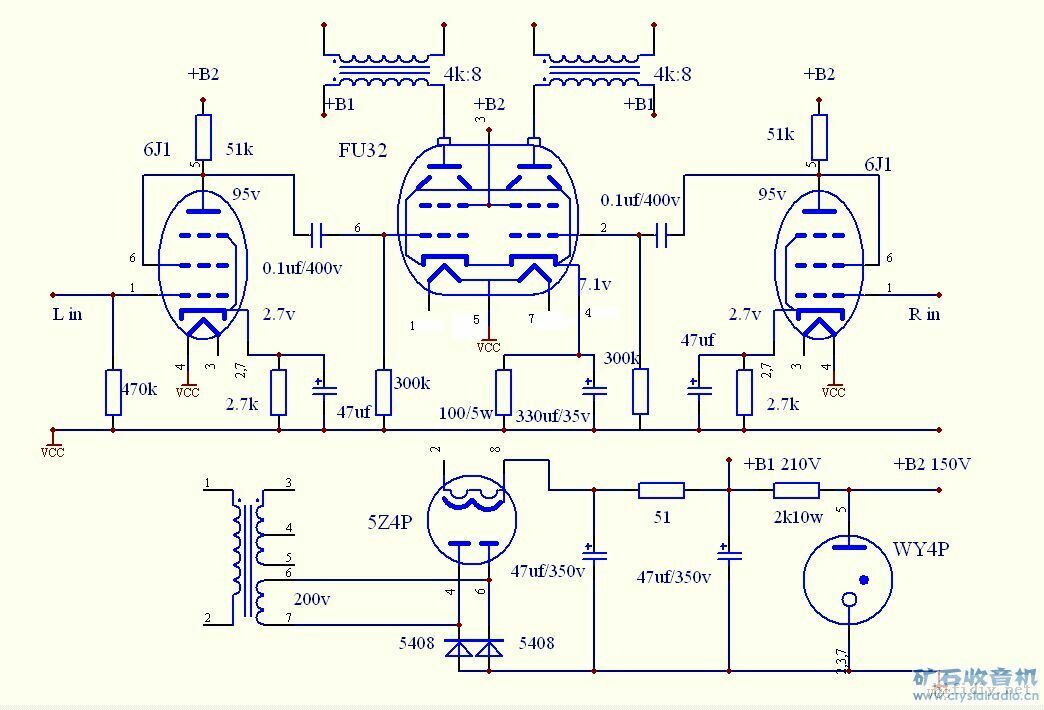

It might be interesting in this thread to come up with a cheap schematic using commonly available parts to build an amp suitable for newbies, which could later on be turned into a higher voltage amp with a much better performance.

tnvijay your test results conforms that the 6J1 does not make an ideal preamp in combination with the PL504. The settings used for the 6J1 are the same as those in the schematics of 6J1 preamps sold on internet working at approx 65 volt. The 2 volt output of the 6J1 is clearly not enough to drive the PL504 in triode mode.
Suggest you try one last change to the 6J1 Ra = 10K Rk = 1K. See if that improves the sound.
If that does not work you might want to try the PCC88. Also an old television tube. No clue if you can get hold of that where you live in India.
Also the fact that adding an air gap to the OPT improved the sound quality is very interesting and confirms the effect of DC in an OPT of a single ended amplifier.

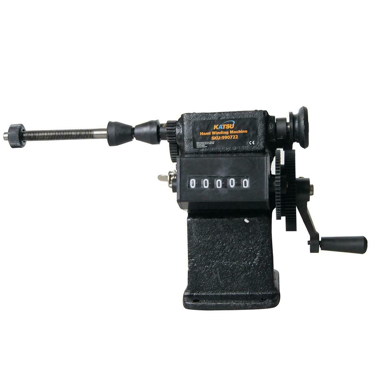

You might want to look for a "hand coil winding machine" on Aliexpress. They are rather cheap and work fine for winding coils. You have to fill the bobbin with a snugly fitting piece of wood, with a hole dead center.

Thanks! I saw the machine, and again, shipping costs too much. I can find native variants of this machine locally. Will try for it in due course. Meanwhile, Yesterday I got two reels of 40 swg and 33 swg wires for winding the trafo for pl504. The plan is to use the bobbin and EI cores of the line matching trafo, and wind a new coil. I am planning to do by hand . I know it's going to take too much time,but since it's only 1400 turns : 140 turns, I can do it in parts. Primary is split in to three and secondary into two.Before that, I will try to optimise the 6j1 preamp section. I will use 47k Ra and 2.2k Rk. B+ would be 150 to 160. Can you verify with data sheet if it works? Thanks in advance.

,I just saw your post. Before that,I tried your final suggestion, a few post back. i.e. Ra 10k and RK 1k. And, I am happy,this works perfectly.! I tested both mobile and laptop as source. There's absolutely no distortion even at full volume. So,at a voltage of 82 B+, this is perfect. The voltage drop against 10k is 22 volt. Cathode volatage is 1 volt. Let's now change the values on the version 2..
