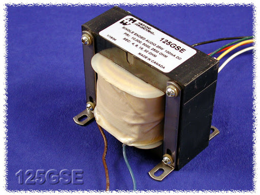

Disadvantage of this approach is however that you need to make brackets to screw the transformer back together. On the first picture you can see the air gap and on the second how Hammond transformers uses the brackets at both sides of the transformer.
To make brackets for homemade transformers, I buy small straight strips of metal at the hardware store, used in wood working to join pieces of wood. They have 2 pre-drilled holes. You can use the top hole (sometimes you have to make it wider to make it fit), make a new hole for the bottom and bend the bottom piece 90 degr, drill a hole in it, so you can fix the transformer to the chassis. Excess to be cut off. Takes a bit of drilling, filing and cutting, but the result works fine. When the 24 V transformer has no screws just buy a piece of 3 mm stainless or other non magnetic threaded bar. Cut to length and use preferably screws and washers of the same material to fix. The stainless steel is not very magnetic and will not act as a shorted winding. With a good homemade brackets you can screw the transformer back together with no change in the air gap.

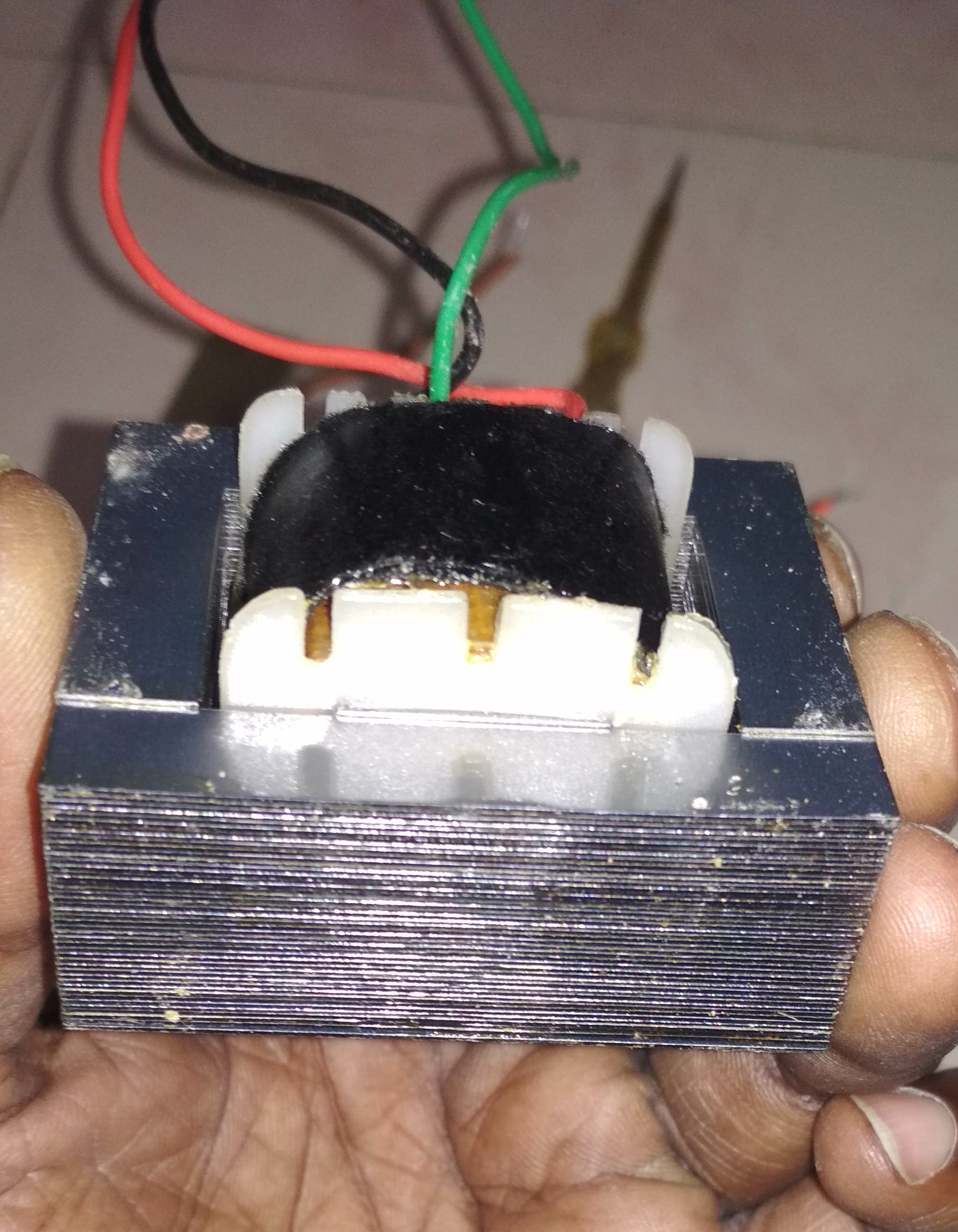

My trafo is unfortunately not having holes on E And I. It was stacked alternatively and covered with a clamp like sheet metal. After restacking, I used the same clamp to put back,but it vibrates.For air gap, I got 0.3mm Nomex sheet. The problem is how to tighten the EI after restacking.( I don't think it's possible CTO drill all the way along the entire stack of E AND I without a proper drilling station with clamps.

That's a nice size transformer. No holes in the laminiations is a problem.
I've no direct solution for that, other than the fact that many SE transformers come
packed in a metal casing. See the enclosed link.
