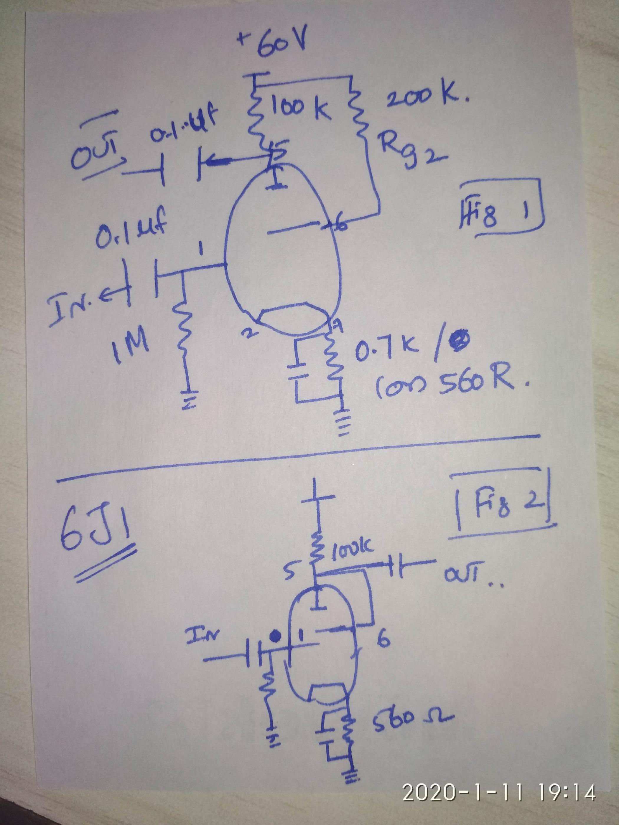

Thanks for the detailed answer. Since i am totally new to tubes, i would like to test the water with simple designs and minimum components. i just have two trafos now, so for a a stereo, i will stick with SE design.As i gain confidence and slowly gather parts, i will try your push pull circuit eventually. The cost of shipping to india is twice that of the trafo itself. Anyway, let me try what i can. My best bet is now to use 6j1,as a driver as you suggested.
i came across a 6j1-fu32 circuit. It uses 82k anode resistor and 2.2k cathode resistor, B+ is 235 volt, which is dropped to 105 volt after 82 k anode resistor.
Thanks again for the help

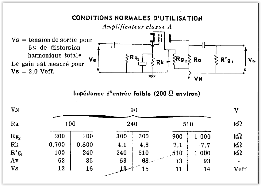

The settings for the 6J1 = 6AK5 can be found in the enclosed table.
This is for a power supply of 90 Volts, but lower e.g. 65 Volts will also work.
The Rk needs to be bridged by a 100 uF capacitor (16V).
The input and output capacitor can be 0,1 uF.
The input capacitor is rated 16V and the output capacitor should be rated more than the power supply voltage on the tube.
Vs / Veff is the signal output voltage of the tube.
Av is the amplification factor.
R'g1 is the grid resistor for the next tube. In your case the PL504.

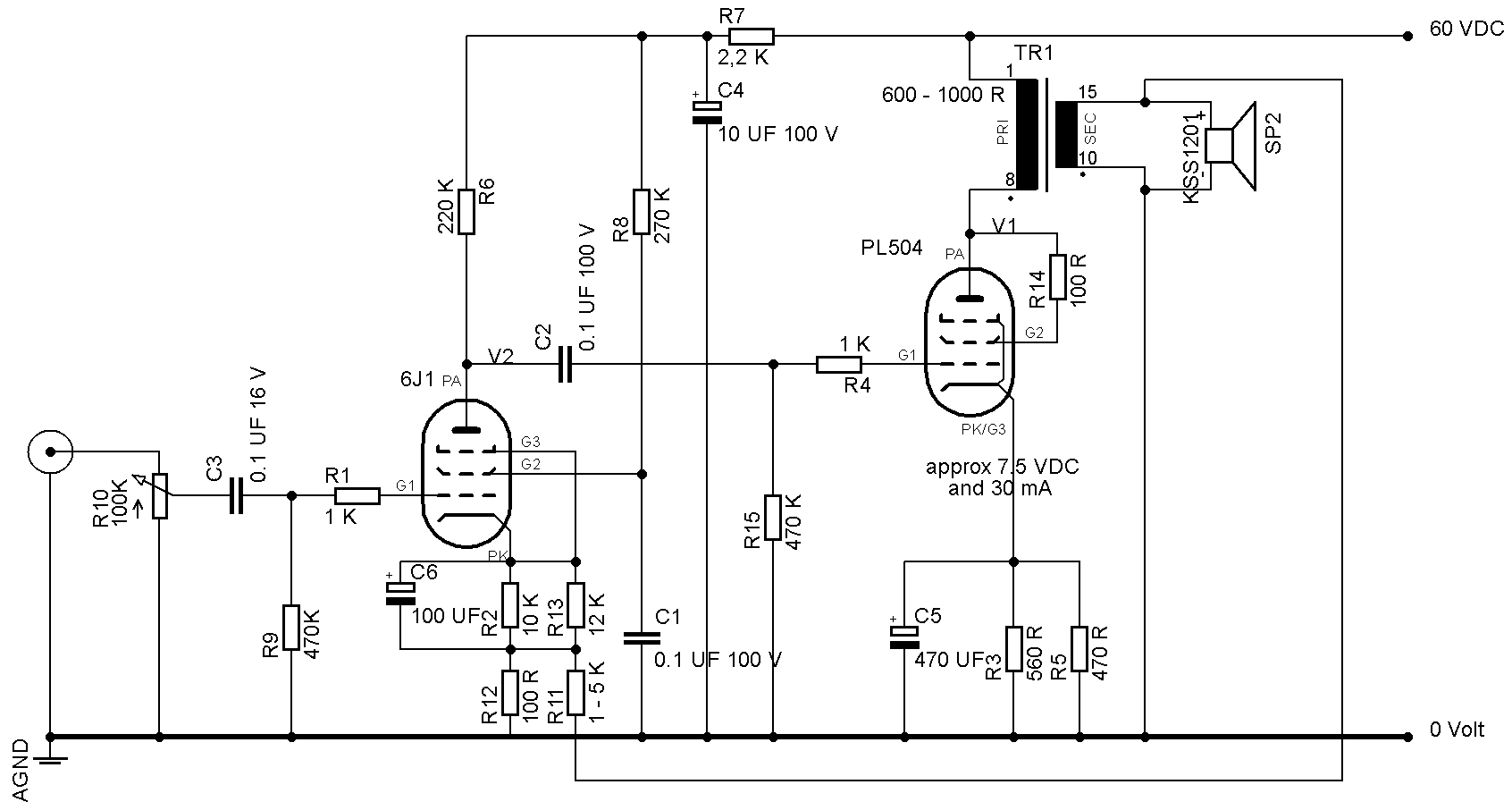

Below the schematic I suggest you have a look at.
This is based on the 6AK5 tube data for high impedance inputs at 90V HT
Page 1.3. The resistor values are rounded to the next commerically available value.
https://tubedata.altanatubes.com.br/sheets/020/6/6AK5.pdf
The PL504 is connected as triode. That means G2 is connected to the anode. The 100 R resistor should help to reduce oscillations. Connect close to the socket. A graph of the working point of the PL504 as triode on the last page of the PL504 tube data sheet.
https://tubedata.altanatubes.com.br/sheets/010/p/PL504.pdf
The working point of the PL504 in triode can be found by drawing a horizontal line at 30 mA. This line crosses the vertical line you draw from 60 V. This gives a G1 voltage of -7.5 Volt. Or 7.5 Volt on the cathode, when the G1 is at 0 volt. This implies an anode current of some 30 mA. This might be much for a small output transformer and possibly lead to saturation e.g. distortion. If that is the case you need to increase the value of the cathode resitor, which will lower the current (and the output volume) as you can see from the grapgh.
The 100R and 1K grid resitors (connected to G1) should be soldered as close as possible to the tube socket. They are there to avoid oscillations.
The cathode resistors of both tubes consist of 2 resistors in parallel to get the right value.

The feedback resistor of 1 to 5 K may be too small resulting in too much feedback. In normal amplifiers I would use something like 15K, but then thgere is a more output signal. Suggest you first try the amplifier without feedback and later add it. You can then experiment with the value of the feedback resistor.
Many thanks. Will try to wire it up and update you.one more query. Can I series one 6j1 filament and one pl504 and power it with approx 31 volt AC? I take supply from o-24 secondary of my mains trafo,and it measures 31 v ac.
Theoretically possible. All "P" tubes have a filament current of 0.3 A and can meant to be stringed together in the fillament supply.l For the 6J1 or EF95 this is different. This tube is meant to be used with a fillament supply of 6.3VAC. You also have to check the Vkf value on the data sheet. This is the max alklowed voltage beteen the filament and the kathode. For the EF95 this is 90V. The 6J1 has a filament current of 0.17 A. So if you want to make a string you have to put 2 pcs of 6J1's in parallel. This will give you 0.34 A. You can put that in series with the filament of ONE PL504 (0.3 A). So 6.3 + 27 = 33.3 VAC. This is more than the 31 VAC you measure on your unloaded transformer. When the transformer is loaded this voltage will drop considrably and this solution will thus not work. Another solution is thus needed.
For the filaments you could make a string of resistor 22 Ohm 4W - PL504 - PL504 - 2 pcs 6J1 in parallel. This will suit a supply of 67 VDC. You must carefully check if the voltage from your transformer drops down under load. If that not the case the resistor in the filament heating chain needs to be larger.

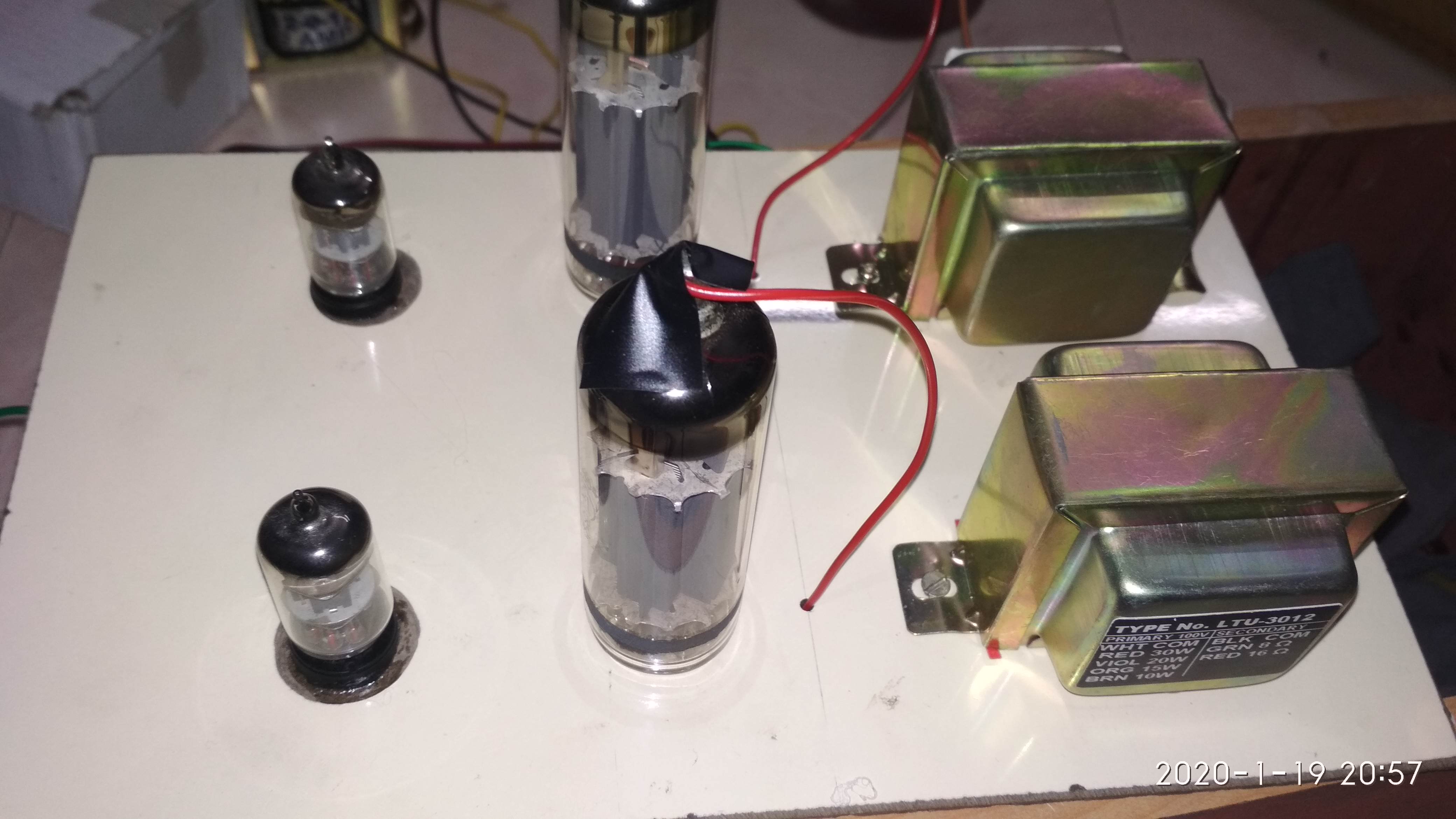

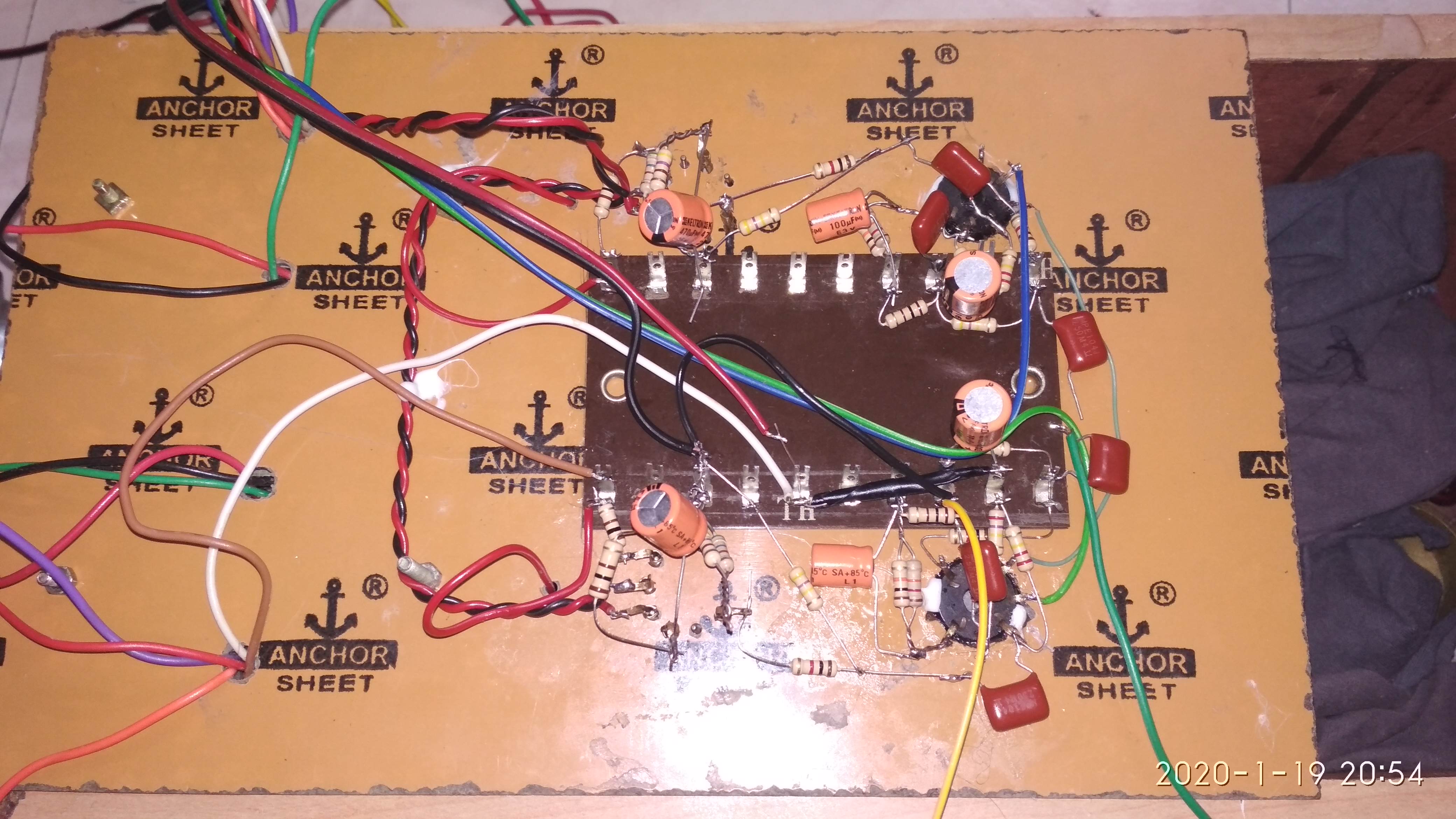

I tried your 6j1 Pl504 schema, as a rough prototype. I don't have sockets for 504, So I drilled on mica sheet and fixed the valve. I immediately got sound on powering on. However,the sound is very much distorted. I removed the cathode bypass cap from 6j1. It dramatically reduced the volume,but the distortion was still present. I tried various cathode resistor with and without cap bypass on PL504. With a value of 100 ohms, and with cap, the sound is little clear, but even then,it's distorted.i tried a feedback resistor of 10k from OPT trafo. But there was no improvement in the sound.
Btw, I get 31VAC from trafo, and when I used a 10 ohm,10 watt series resistor for pl504 filament,the resistor burnt .I ran the filaments at 31 volt,but I am worried about the tube longevity.Any help in fault finding will be much appreciated.The output trafo is a 100 volt line matching trafos, and it gives good mid and high frequencies response. But rolled off lows.
It hard to make up what you have done with your wiring form the pictures you send me.
However I'm a bit worried with the fillament supply. If you run the PL504 on 31 volt than I assume they are both in parallel and thus consume together 0.6 Amp. 31-27 = 4 Volt. You need a 4/0.6 = 6.6 Ohm resistor in series with the PL504 filaments. So a 10 Ohm resistor should be okee. The VA rating is V*A= 4 * 0.6= 2.4 Watt. I double this to be sure. So 5 Watt should work fine. If the resistor burns, you have a short somewhere. If you power on and you see smoke or smell something odd kill the power immediately and start checking your work. Happens to all of us. How do you feed the filamenbts of the 6J1's? 6.3VAC?
I suggest you check (measure) all resistors to see if they are the right value and connected at the right spot.
The other issue may be the way you have connected the Line transformer.
A wrong ipedance matching will distort heavily.
Need to go for dinner will explain later how you have to connect the line transformer.
To see how the impedance of the primary winding of the line matching transformer is calculated see:
http://home.alphalink.com.au/~cambie/6AN8amp/M1115.htm
I've done this calculation for your line transformer on the enclosed spreadsheet.
The connections to use are: 0 - 10W for the PL594 anode and 0 - 8 Ohm for the speaker of 8 Ohm or 0-16 Ohm if the speaker is 16 Ohm. This will give you a primary impedance Z = 1000 Ohms. Which should be fine for the PL504 in SE.
You can verify the speaker impedance bij measuring with an Ohm meter over the speaker terminals. Don't use a speaker box with high mid and low filters. You don't have enough power to do so. Best is a plain 8 Ohm speaker.
First make sure the filaments of the tubes are properly working. To low filament power can also lead to distortion.
