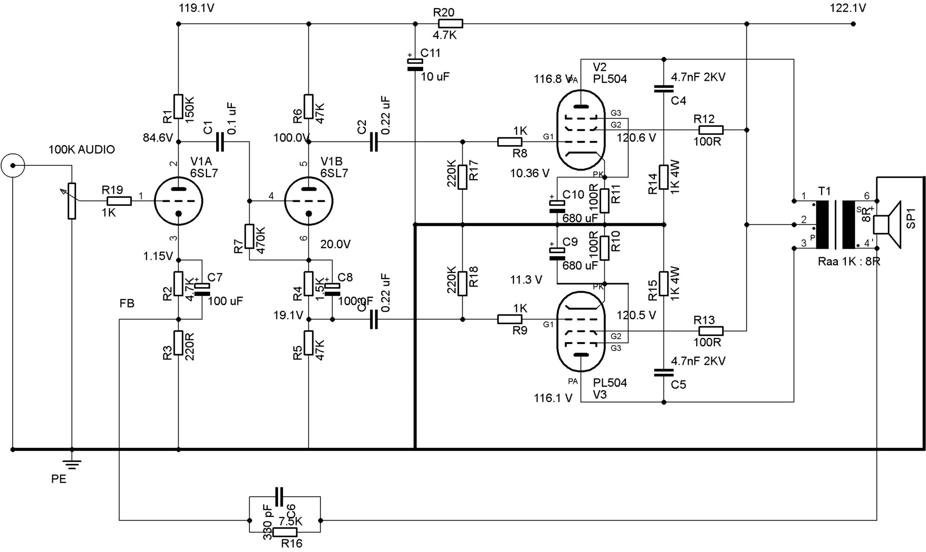

As I wanted to test an 1K Raa output transformer, I decided to quickly built an amplifier which requires a low impedance output transformer. For this I adapted the schematic of the PL504 SE, proposed by Pilovis, for use in a PP amplifier. I used one half of the 6SL7 as pre-amplifier and the other half as cathodyne phase splitter. The PS is more or less similar to that of Pilovis and supplies 120V.
After some experimentation, the anode resistor of the first half of the 6SL7 was set at 150K and a cathode resistor of 4.7K was used. This setting allows for 30 fold amplification with V out of max 9.1V. This gives enough amplification to allow for feedback as well.
For the cathodyne phase splitter (V1B) a number of different resistor settings were tested (see table below), but the best results were obtained with an anode and cathode resistor of 47K, a grid resistor of 470K and a cathode bias resistor of 1.5K. In this setup the DC voltages over the anode and cathode resistors were both equal, each being 19.1VDC.
6SL7 Cathodyne Phase Splitter Test Results with 119V Supply Voltage
Ra and Rc 47K 47K 47K
R cathode bias 4.70K 2.35K 1.57K
Voltage over Ra and Rc 12.5 13.2 19.1
The PL504 tubes are pentode connected and have a cathode resistor of 100R, which is decoupled by an electrolyte of 680 uF 16V. The 10 – 11 VDC on the cathodes implies that each tube draws between 104 – 113 mA.
The G2’s are connected with 100R resistors to the power supply and draw some 11-12 mA each.
The feedback resistor was set at 7.5K (two 15K resistors in parallel).
The amplifier was tested using a function generator set to produce 1000 Hz square waves, which were verified with an oscilloscope. Ringing could be effectively suppressed by adding a 330 pF capacitor across the 7.5K feedback resistor (64 kHz) and a Zobel network in the anode leads of the PL504 connected to ground, consisting of a capacitor of 4.7 nF (2KV) and a resistor of 1K (4W) resistor in series (34 kHz). After these additions the square waves looked good for such simple amplifier.
The amplifier sounds surprisingly well, has a nice punch to it and can play rather loud. It should be able to produce some 4-6 Watts of audio power before distortion kicks in.
As an alternative output transformer one could use a toroidal power transformer of some 10 – 15 VA capacity with two 110 VAC windings used for the 2 primaries and two 9 VAC windings, which are placed in series, to connect the 8 Ohm speaker. This will result in a primary impedance of 1200 Ohm.
Enclosed the schematics

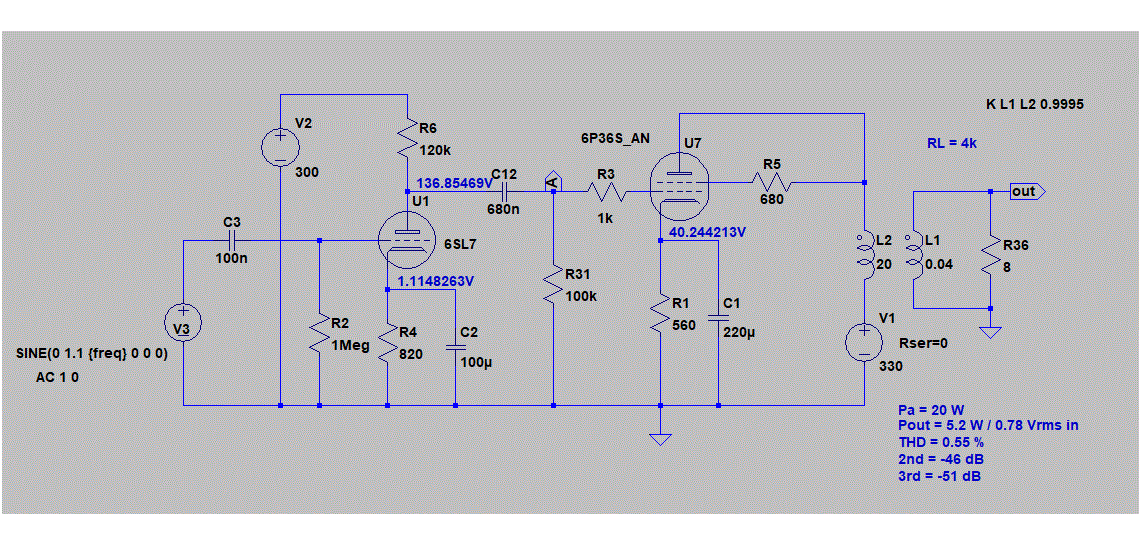

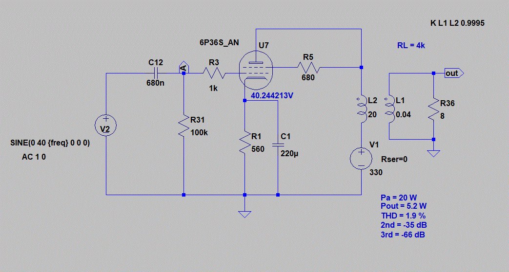

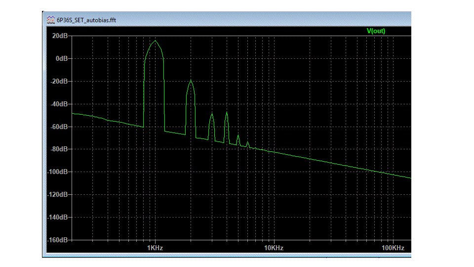

Concerning the triode output stage, here are the simulation and schematic.
Does not that distortion spectrum look musical ?
Thanks!
How would you drive this stage?
The 5th harmonic a bit higher than I like....😀
Yes! Looks a typical SE Class A ...Does not that distortion spectrum look musical ?
This way.
But now 2nd harmonic is canceled so that THD is only 0.55 %. Is this already too low ?
of course not!But now 2nd harmonic is canceled so that THD is only 0.55 %. Is this already too low ?
Perhaps it will not be too sterile sounding....😀

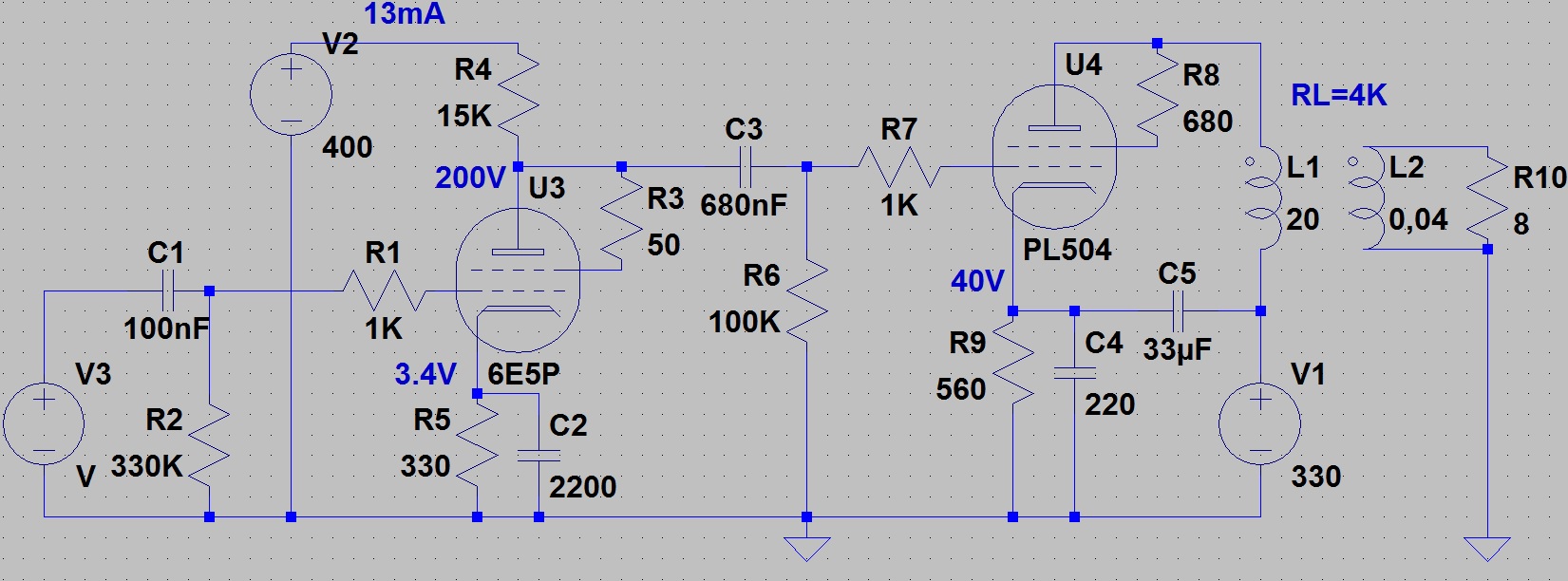

Hi Artosalo! Happy new year!
Could you please check this design? If possible, post the Ltspice tube data for later attempts?
Thank you!
Well, this is very nicely done, since I have a lot of PL36s and few of 6H9C I want to attempt this, but can you generally give me advice how to avoid oscillation in any amp? Because, whenever I build something with tubes over the weekend quickly it oscillates and makes funny noises, my soldering skill is ok, but element layout under the cover is just awful, and how to correct it, and how to connect it so that I avoid oscillation?
