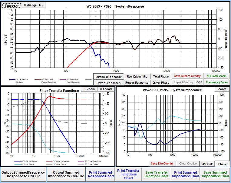

So while I am going with an active crossover, I've decided to test a passive crossover as well. The speaker will have four binding posts... allowing for Linked Passive Crossover, Passive Bi-Amping, or Active Crossover.
So im still deciding on a Series or Passive crossover. Which of these responses look best? Im leaning toward the one with the highs attenuated as Im afraid the upper end will sound too fatiguing / loud. I'm trying to consider the loudness curve as well... my reasoning is attenuated highs should balance out with the lows due to human ears perceiving higher frequency sounds as being 'louder'. Thoughts?
It's very subjective - some people prefer warm to clear and vice versa. What most people agree on (except someone now to disagree) is that sharp peaks in output are more noticeable than troughs. So, the curve on the left has a strong peak at 1.8kHz - shouty/forward/squeally vocals. The curve on the right might sound warm. Room interactions means you won't get either performance anyway, especially below 350Hz.
Have you got all the parts yet? Build it and listen to different configurations? Don't forget to run the drivers continuously for a few days to loosen up the spider etc and break them in.

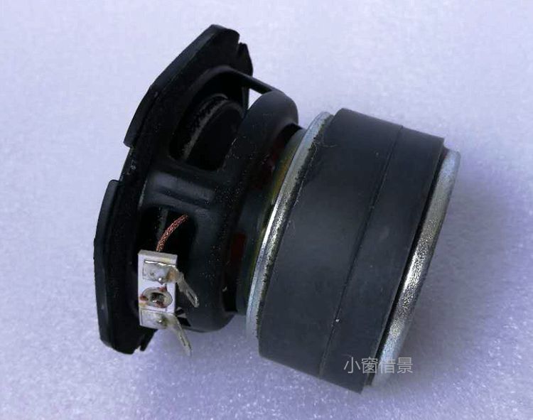

This is the woofer - the code on the back suggests it is a Samsung part - perhaps from their R1.

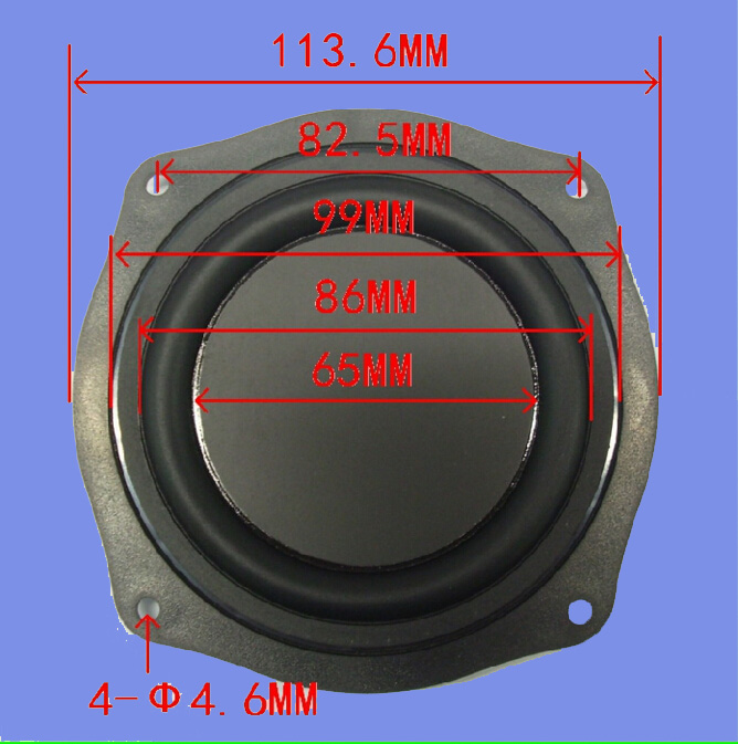

This is the 4"passive radiator
https://item.taobao.com/item.htm?spm=a1z09.2.0.0.57322e8d4J1PmO&id=532029550839&_u=o10d5b0g1cae

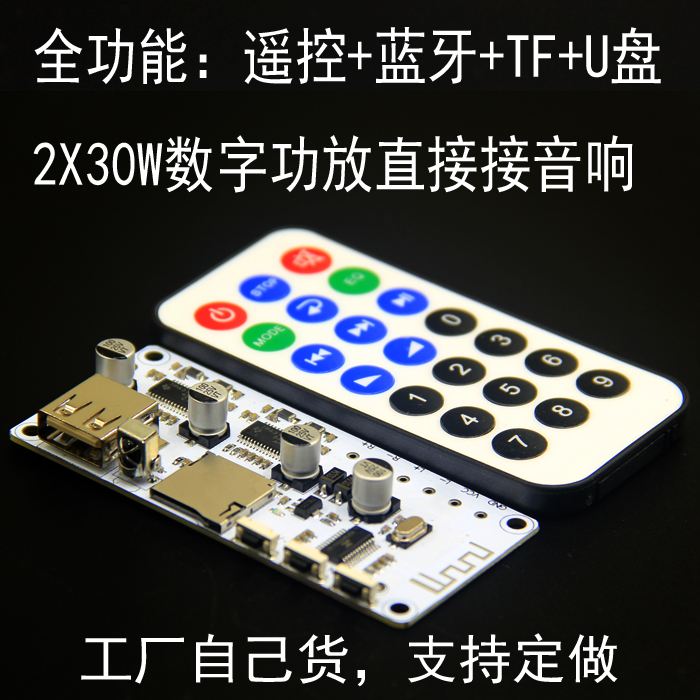

This is the bluetooth dual TPA3110 remote control amp
https://item.taobao.com/item.htm?spm=a1z09.2.0.0.57322e8d4J1PmO&id=553435876716&_u=o10d5b0g15c7

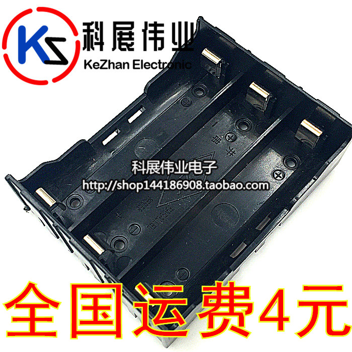

A battery holder
https://item.taobao.com/item.htm?spm=a1z09.2.0.0.57322e8d4J1PmO&id=538946614813&_u=o10d5b0g7ab0

This Bluetooth board does not work - usually boots with nothing, sometimes as ssai 02, always refuses to pair. I've tried 3 phones and all my tricks. It's crap. Don't buy it. It's a shame cos it's almost ideal for this project and I haven't seen any the same.
