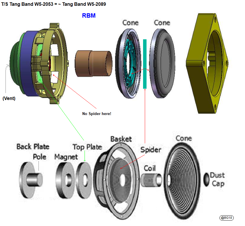

T/S Tang Band W5-2053= ~Tang Band W5-2089

Nothing isobaric except pix. I'd say the similarity is minor.
I see what your saying but I think they argue that there are two cones and the air pressure between those two cones is constant, hence, isobaric.
I've built isobaric driver arrangements so I know from experience as well as the science that they reduce THD. I just don't know how effective this patented design is - so I've bought one to try.
The isobaric concept, as I understand it, uses two identical drivers wired in reverse or mirrored. That way any error introduced in one direction is addressed (cancelled or duplicated?) by the driver in the reverse/mirror mounting. Sort of. There is also the possibly mistaken notion of doubling some parameters by capturing an entrained bit of air.
Here we have a just a single mechanism. The only element connected in reverse is the dual surround that also serves as the total cone suspension, at least as I see the picture. Yes, smart to have the two surrounds mounted in reverse and maybe you get a more linear suspension than using starched fabric (or whatever spiders are made of today).
Yes, there seems to be two "cones". But that may be necessary in order to work properly with the two conventional-looking foam rubber surrounds, eh. I doubt any wee bit of entrained air has any influence.
All I know is the pretty picture and I could be wrong about everything.
B.
Isobaric cones reduce distortion because the rear cone does the work against the air in the cabinet, like compressing a spring of sorts, but the front does very little due to the isobaric air behind it and a large room of air in front. What the ear hears is the front cone which has much lower distortion, esp at low frequencies and high excursion. I don't know if Tang Band's design fully exploits this because it is one speaker, not an inverse pair, but I see no reason why that front cone won't be having an easier time of it thanks to the rear one. And then, no spider. I can certainly see why they got a patent. But hey, proof of the pudding is in the listening!
Thanks. Here's my updated take on it: only the lower "cone" is attached to the VC. The entrained air motivates the face cone (upper cone) uniformly. Maybe T-B feels that makes the face cone move more accurately (but might have no effect on the sound coming from the lower cone).
