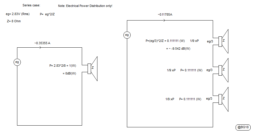

Just punched some calculations for the arrangement you posted. If each Dayton tweeter is punching 20 Watts... R1 will expend 55.17W (6.7Amps), R2 will expend 40.2693W (2.0375Amps), and R3 will expend 33.749W (4.7434 Amps).
For the series design, the 25 Ohm resistor will expend no more than 60W. BUT the impedance curve is not as nice... rising to just under 15Ohms at the high end and almost hitting 30 degrees in phase. Which trade-off makes more sense? Have the resistors in the parallel arrangement chew up power or throw the amplifier a more wonky impedance curve. Something tells me it might depend on the amp that is driving it.

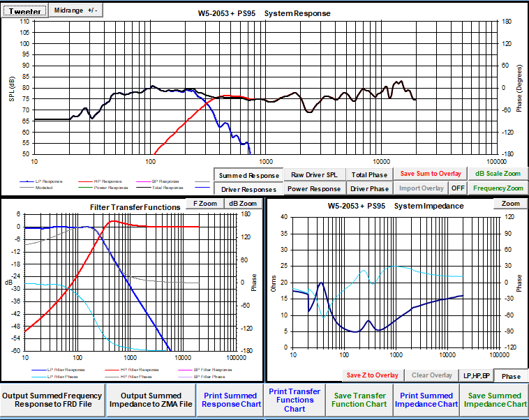

I'm really not sure which way to go here. The first plot below is of the arrangement Nanoloop described, I was unable to reflect the SPL drop in the full range that would result from adding a 1.5Ohm resistor in series however the impedance is accurately modeled (Hopefully that makes sense).

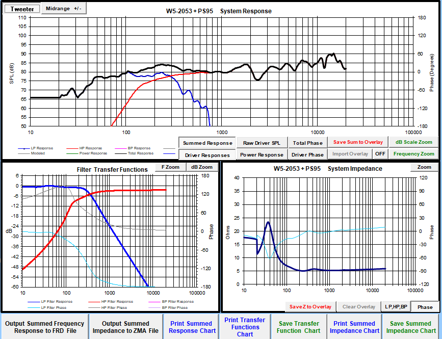

The second plot is a revised model of my previous crossover design (Back to the series arrangement with the 25 Ohm resistor in parallel with the full range drivers in series. The crossover (To clarify) is as follows:
LowPass:
-5mH
-147uF (This can be lowered to 47uF BUT the impedance plot gets thrown slightly more out-of-whack)
HighPass:
-47uF
-3.5mH
-25Ohm Paralleled with Full Range Drivers (Linked in Series)
Points to consider. The impedance curve on the PARALLEL arrangement is much smoother and nominal... hovering at around 4 Ohms. The crossover doesn't look as 'nice' and Im going to tweak it to see what I can do. When maxing out the PS95, there is a loss of 130 Watts across the resistors in total.
The SERIES arrangement sports a smoother crossover (At least in modeling) but employs a 147uF capacitor, has a loss of 60 Watts when maxing out the PS95 and has an impedance curve that rises to just under 15 Ohms at the higher frequencies. I appreciate the help so far as I'm really unsure what the best solution is here.

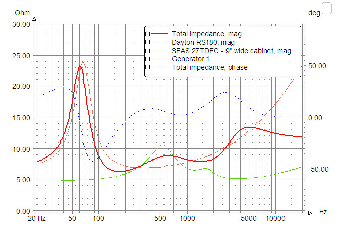

For reference here is an attached picture of the Modula MT (Designed by Jon Marsh) impedance plot. Based on my short conversations with Jon Marsh, I definitely feel his audio related judgement is on point. I notice that his impedance plot isnt too far off mine in terms of the behavior. Is there something I'm missing? He made these two statements regarding the impedance plot below.
""Here's the impedance curve- if your receiver can't drive this, it hasn't got a pulse..."
And this
"Last, the impedance curve. Pretty much anything should be able to drive this, except a crystal radio."
Learning a ton about impedance curves right now and how it's intertwined with crossover design. I find its really interesting looking at other loudspeaker build impedance plots but it can be difficult to distinguish what is good or poor behavior. Also I apologize for hijacking this thread! The build has a W5-2053 in it however... so I supposes it's related. I can take this somewhere else on the forum if this starts to get annoying

... this means that each full range driver receives 1/3rd the power that it would have originally (Versus if there was only 1 full range driver).

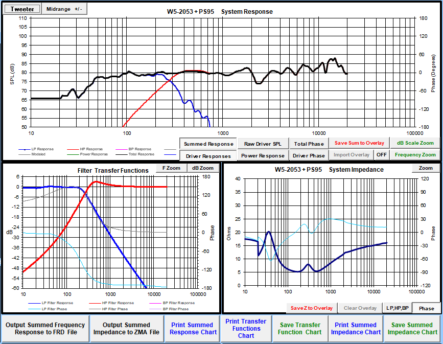

So the plot on the left is the new Series crossover plot. The plot on the right is the best parallel plot I could get.... Both crossovers use the same components (Im not limiting myself to that but I found the best response to be with the same components I ordered for the series crossover - so thats pretty cool). Im going to mess around more but bjorno's correction puts a damper on the series impedance design. Its starting to seem less realistic now.

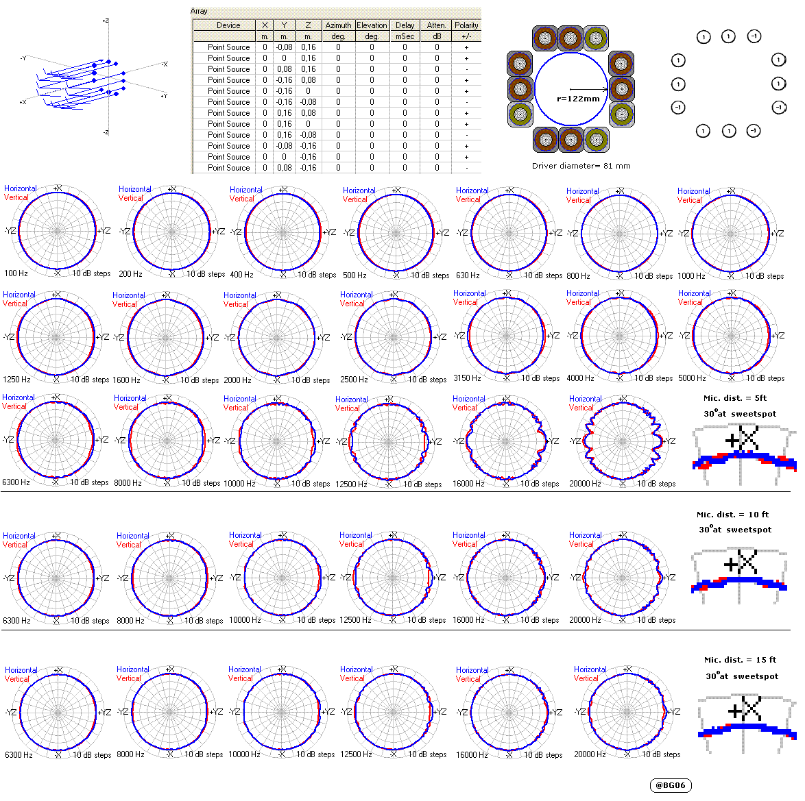

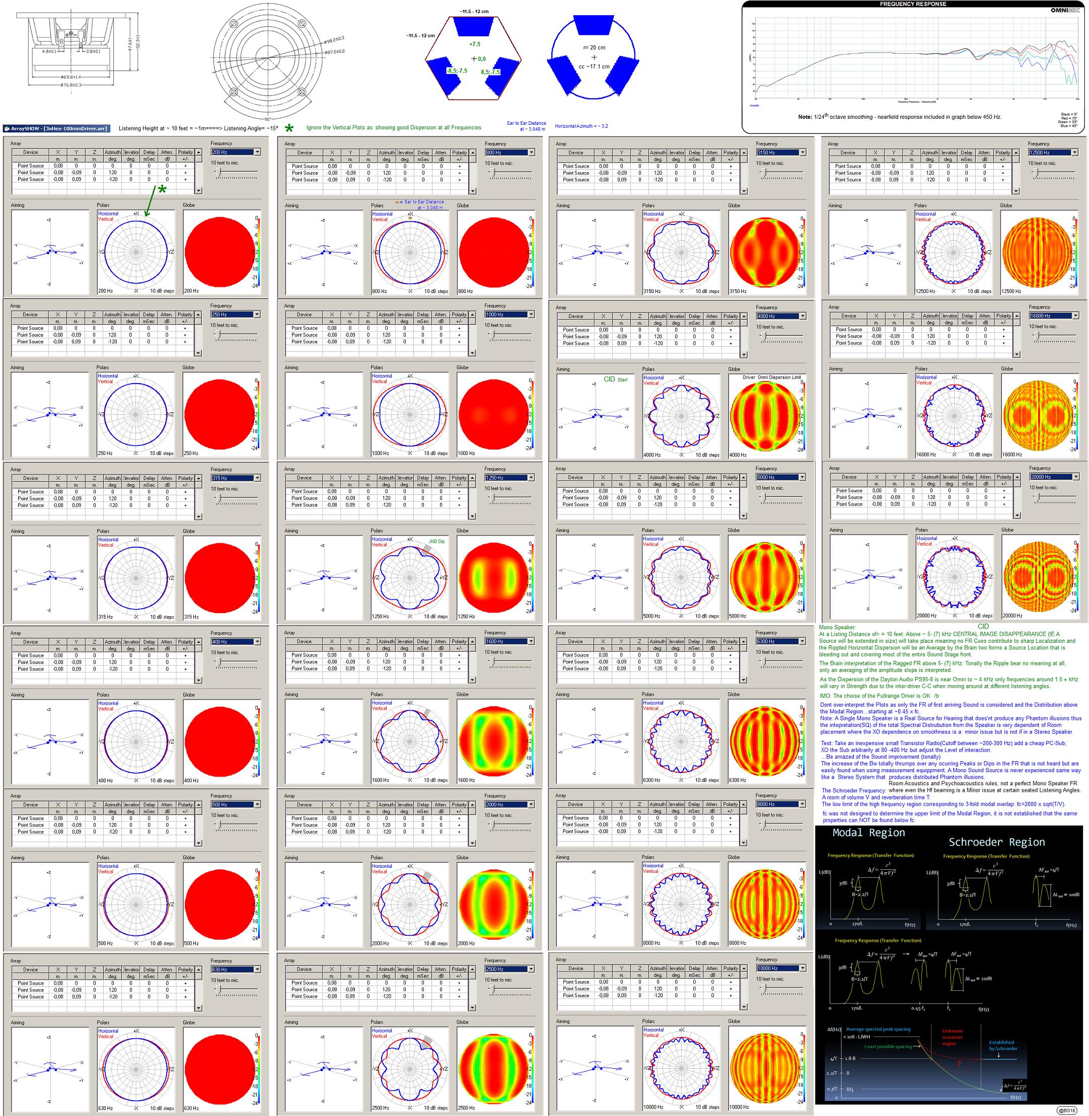

Hi WaveCarver,
OK to XO at 250 Hz provided the mean C-C from 3 x PS95 to the Sub Driver is around a ft or less.
You can easily adapt the Plots(Driver C-C= 17.1 cm) to your actual Diver C-C Distance by multiplying the Plot frequency with C-C old/ C-C new.
Minimal C-C is returns best summed FR but I think it becomes a Moth point for a Mono Speaker when the mean vertical C-C Distance is less than Lambda/2(I prefer <=Lambda/4 as a limit) at the XO frequency.
If your measure of the actual C-C is e.g. 13.68 cm, then the Plot for 2000Hz is valid for the 2500Hz Plot as 2000 x 17.1/13.68 = 1.25 x 2000= 2500Hz.
I only use Trade of Tool Programs when Posting Here at diyAudio thus the Arrayshow.exe is a free Program to download.
Note: Will only open in WinXP or older. I use Oracle VM VirtualBox when in Windows 10.
CareySound Software ::
You can also search for more information: ArraySHOW from Mark Ureda and EVI Audio
Low-Frequency Directivity and Arrays
b
PS: If you need a Mono configuration with very small Dispersion error: See my (Bessel) 12ringarray81mm.gif using 3” Drivers, here a Wall Mount Layout that at Distances above 1.5 ft provides Omni dispersion but of course only limited by the choice of Drivers.
Awesome stuff bjorno - it seems mono is the key Which 3" drivers did you use? My belief is that a 3" coaxial will work better than a 3" full range for dispersion. Have you ever modelled that? Just curious since there are some available.
