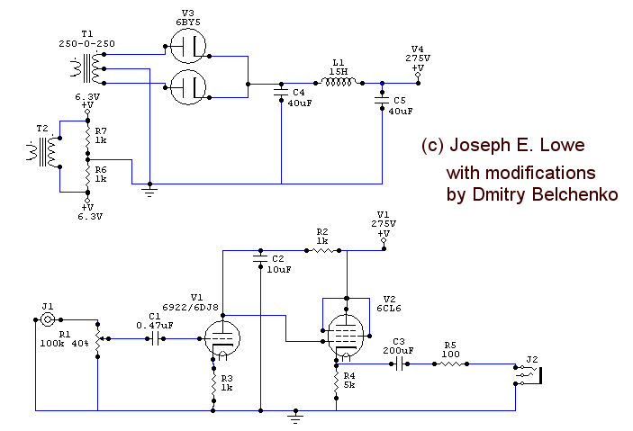

As for the heater supplies,I'd rather feed the 6AS7G 2.5A + AC from a dedicated xformer and use another xfromer to feed the 6DJ8 from a DC regulated supply.
Don't worry about the seemingly low 150 VDC B+ voltage,both tubes were designed to operate at low B+.
If you want to use this circuit as a line stage as well a nice regulated PSU would certainly pay off.

trespasser_guy said:I, too, thought it was a bit low...
150V is in the right range for a 6AS7. I didn't realize that was the tube you were using.
And in the notes about this amp, it says C1, C2, R5 is shared between both channels.
Yes. What's wrong with that?
It is nice to know I can use higher amp ratings... I found many transformers that could have been used that I ruled out because the A was wrong...
You will never find the exact specs you're looking for on any given project! Designing a power supply is a lot of educated guesses.
Doesn't the heater supply need to be regulated?
Why? You're using AC on these, right? so keep it simple.

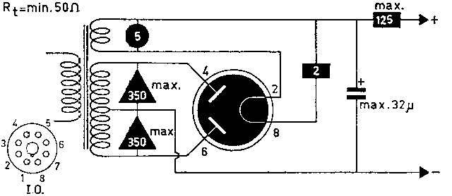

Also, a question I have about the rectifier... Which pins do I connect to what? Your scems don't have the pin layout-- I think I could guess, but I don't wanna blow anything up unecessarily... 🙂
5Y3GT
No problem.
See pic:
Cheers,😉
See pic:
Cheers,😉

1) What is the purpose of C1?
2) You should not present the junction of two DC coupled tubes with any reactances, ie. C2.
3) What is the purpose of R5?
4) Not familiar with the 6DJ8, but 1k is a very small load. Do you get any gain?
well yes C1 is not necessary, C2 and R2 are basically another drop filter for the 6922/6DJ8, and R5 is can vary depending on the impedence of your headphones so can be adjusted up to 500 ohms.
R5
If so than it should be shunted across the output,not in series with it.
Cheers,😉
Cheers,😉
