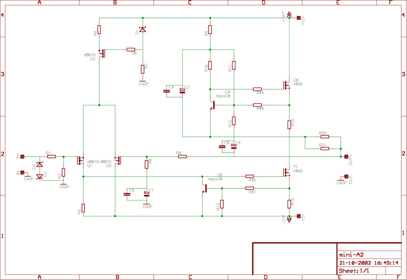

I am asking about the caps after the 500-ohm resistors... DO they affect the voltage in any way?
The amp requires +150VDC, and I don't know what the rectifier (5Y3GT) requires because I don't know anything about it... or most other tubes for that matter. What is the minimum mA rating I should have? In the circuit, it says 100mA, but I am driving a much lower voltage, so does that matter? In case this matters, the amp tubes are one E88CC and one 6AS7G.

I did try using these formulas for this, and ended up needing about a 250-0-250V transformer with 57VA @200mA. I think I am wrong.

I, too, thought it was a bit low... Here is the scem:
It is using the E88CC and the 6AS7G, and I am not a fan of the original power supply, so I was trying different ones, and really wanted tube rectified, and yours was nice looking to me. And in the notes about this amp, it says C1, C2, R5 is shared between both channels.

Doesn't the heater supply need to be regulated? Just a thought...
