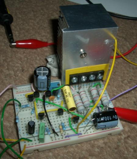

Well, I have the complementary version of post #39 running only with 2 pairs of BD139 and 1.2r emitter resistors.
Bias is set to pull around 50ma from the + rail (16v), 12mv accross each 1.2r. No noise or oscillations, just about 2mv RMS of random noise on the output as is expected.
Offset if about 15mv, I will try matching a pair of MPSA18s on the input and see if I can get it any lower.
A photo of the breadboard is attached. I have a Hammond heatsink box I'd like to put this in when it's ready, it should provide adequate cooling for any normal listening level. I'd use a bar clamp mounting instead of individual hole mounting as on here.

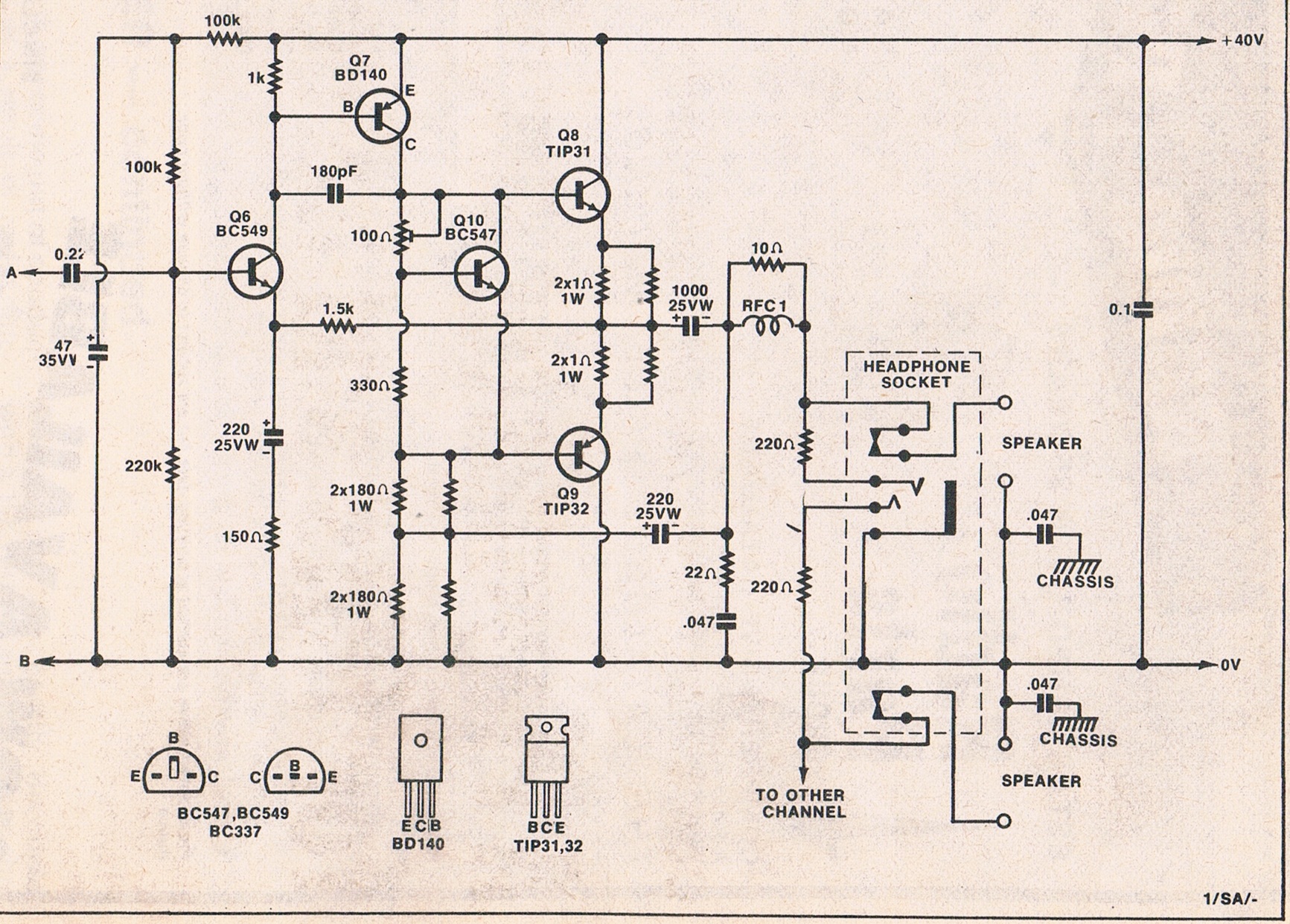

Yuck, capacitor coupled (better unplug your speakers before turning it on/off!), no differential! 1979, I thought those things went away in the 60s. 😛
Guess you can't argue with the simplicity. Having all of five transistors, it would be very cheap to make. Hence why it's often seen in cheap consumer electronics of the period. 🙂
Tim
Interesting design, but capacitive coupling is to be avoided, especially seeing as I have the +/-18V supply already!

So, I built Sch3mat1c's design on stripboard:
and it seemed promising. I powered it up (it's one half of a would of been stereo board) and got 8mv offset at output, minimal noise showing on scope. I then connected a test speaker and got buzzing when I touched the input, so that was promising too. I then tried to set the bias... 😱
I've done it on many amplifiers before without issue. I attached a block of aluminium to the outputs as a temporary heatsink and advanced the multiturn pot with a multimeter connected accross one of the 1.5R resistors. I kept turning it, it's a 25 turn pot and I knew it had to go quite a way, still 0mv showing on the meter. I think that a crocodile clip lead I was using to connect the meter to the resistor was at fault, they have been intermittent with other applications too; it's not a good show when you can't trust your test equipment! So, I never got any reading but I caught a slight 'hot' smell and touching some parts confirmed this, I can only assume the wiring was correct but the bias was inadvertently set way too high.
I now get the same readings for any setting of the bias, different values accross each 1.5R output resistor. Something like 54mv, 10V 🙂eek🙂, 6mv and 0.1mv! I think the words 'beyond repair' spring to mind :RIP:
