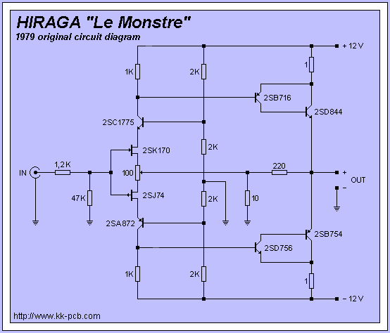

Yuck, capacitor coupled (better unplug your speakers before turning it on/off!), no differential! 1979, I thought those things went away in the 60s. 😛
Guess you can't argue with the simplicity. Having all of five transistors, it would be very cheap to make. Hence why it's often seen in cheap consumer electronics of the period. 🙂
Tim
