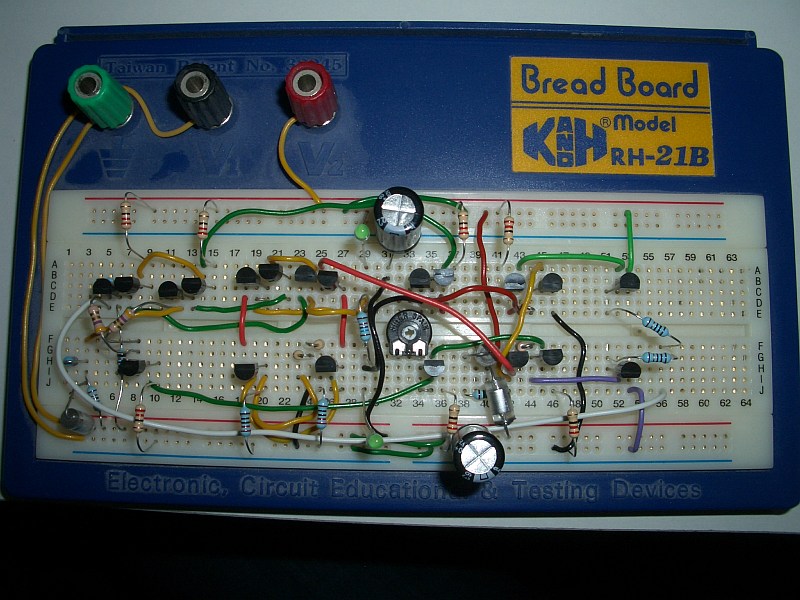

I have been trying to get the Diamante design working, firstly in its normal configuration but then with the aim to get it driving speakers. Unfortunately, my breadboarded effort (attached) has about -1V offset and I'm at a loss for seeing an error. I did have a transistor in upside-down at first, which caused 11V or so offset, I had wondered if surrounding ones had been damaged due to this error but having replaced them I got the same result. I still want to persue the design as it seems it has the potential to be very high performance.

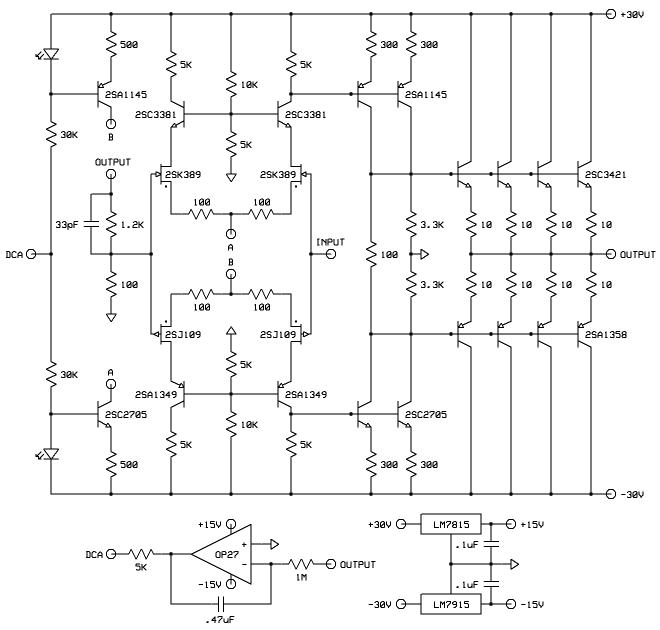

Thanks Miles Prower for the schematic, it's another design I will consider though I don't currently have the specified outputs. I have loads of BD139 though if they can be used!
00940, another high performance design it appears. It looks very good, Not sure I could get it to work on stripboard and some of those devices might be a bit costly, but I'll keep it in mind.

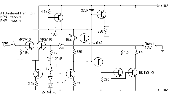

Sch3mat1c, a nice and simple design, simple enough for me to try out, assuming it can be tested with 2N5551 and 2N5401 transistors and BD139 output devices? I may have a pair of TIP31s though, but one's a TIP31A and one's a TIP31C, probably not an issue but I do have lots of BD139 so it'd be nice to use them! If required, how would I use 2 pairs of BD139 outputs? I also have loads of MPSA18, but no complimentary devices. Any idea of the performance of this amplifier?

SS amps are very noncritical, only the differential pair should really be matched. 2N5551 and 5401 will do fine. BD139 is rather small (12.5W max.) but will do a fine job if you keep the current down (16 ohm speakers, settle for <5W output?). Otherwise, you can connect several in parallel, adding seperate emitter resistors for each.
Open loop DC gain is around 60dB, bandwidth ends around 100kHz, slew rate something like 10V/us, etc. Overall a very average discrete SSamp.

Sch3mat1c, I've breadboarded your amp and will test it (currently only 1 pair of BD139). Can you suggest a bias current (mv accross 1ohm resistor) and which way should I set the wiper initially?
Would 3 pairs of output BD139s be ok? Or will that be too much base capacitance to drive or something? I should use two 1ohm resistors per pair, how many watts should these resistors be rated at? I'd like to keep them small.

In fact, I'm testing Sch3mat1c's design and am having essentially the same issue! I managed to set the bias (guessed it at 10mv accross each 1.2R) no problem, but have an offset voltage, this time of 1.7V positive. No unusual noise shows on the scope. What would be a common cause of this, that's surely far too much to simply be from not matching transistors?
EDIT: hadn't connected the right hand input transistor's collector to +V 😱 . Now 25mv, ok but can be improved with matching I'm sure. On to real testing 🙂
Well, it's working quite well. Pulling ~30ma per rail idle, about right for bias current? It's dead quiet into speakers, no hiss or hum, which is certainly nice. Turn on pop is minimal too, which is also desirable since it'll be powering mini speakers. It is running from a regulated test supply currently though, should I expect more noise with an unregulated supply? How is the PSRR?
I hear some small amount of distortion with sine test tones, but then I'm using a small speaker free air to test so it could be the driver? If anyone could confirm this is enough bias current that'd be great. Still on one pair of BD139, I'll have to try adding another once I've prepared the heatsink for them (half an old CPU cooler). It stays completely cool btw 😎

Set the trimmer towards the top, so the Vbe multiplier is set to the minimum voltage (about 0.7V). This will set class C initially.
20mA = 20mV per resistor is a fine starting point. It only needs to be biased into conduction; how far doesn't matter, except that more class A = more power dissipation = more prone to thermal runaway.
2-3 pairs of BD139 would be okay. If using 3 per side, more resistance, perhaps 2.2 ohms per emitter, would be better.
This is getting a little more complicated, so I should draw it...
I moved a few other things around for clarity, and changed the feedback resistor to 22k for more gain. The old gain of 10 is a little low; 20 as shown should be just right for most purposes.
Tim

How much voltage? If as rated, then 30mA * 18V = 0.5W, enough to get those transistors pretty toasty without a heatsink, but not very noticable if you've got a good sized one.
Come to think of it, as much as 100mA would be fine. That's 1.8W per side, or 0.6W per transistor (once you get all three pairs in). As long as it's more than a few mA, and not so much that it burns up, it's fine.
FYI, you should probably build this on ground plane or something... even with emitter resistors, I've had paralleled BJTs play badly together without any apparent reason. Have you checked for parasitic oscillation or squegging yet? I found the 33pF B-C capacitor necessary to keep the darlington stable, YMMV.
The prototype model has an ordinary iron power supply, so at idle there will be a little supply ripple. I don't hear anything. On the scope (i.e., if I can't see it, there's less than 5% of it), PSRR only shows up in clipping, which you'd expect.
The turn-on-pop resistance is quite nice, I noticed that too. I guess bias settles quickly. The turn-on pop itself is minimal, and I think most of the noise I hear comes from the power switch (i.e., RFI), rather than PSRR directly.

A little concerned at the mention of a ground plane, I fully intend to build this on stripboard, though I guess it'll be mounted over a grounded aluminium box. The single output pair version is working fine on breadboard/plugblock, no oscillations on scope, clean looking sine output. I guess I'll need to see how 2 pairs get on. If that causes trouble, I guess I'll have to invest in larger transistors and stick to a single pair, which would be a shame. I'm thinking 2 pairs will be sufficient though, so mabye 1.5r in each lead? I'll have to use 1.2r to test though, all I have. Are the 1r resistors after these not required then? Are 1W metal film resistors sufficient here in the long term?
I'm using ceramics for the small capacitors on this breadboard version, they are all I have. Is it ok to remove the 18pF capacitor in the feedback loop? Not sure if I'll want to increase the gain too much in this application, I'll have to check how it gets on with the output from a PC and a 10K pot at the input. I suppose I need a capacitor to couple the pot's wiper to the input of this amplifier?
I could go for a complimentary pair, I have a few BD140s too, if there is any advantage to doing this?
I'll be trying out replacing the input stage with a pair of MPSA18s. I have about 90 so I should be able to match them quite well from these.
remember to match using the same Vbe and the same operational Ic for the devices while holding Vce, Pq, Tc, Tj, at equal values during the testing/matching.
You will achieve little by comparing hFE using a transistor hFE function integrated into a DMM.
You will achieve little by comparing Ic & hFE if you do not hold Vbe at a known constant voltage.
If you let the device temperature change all your results are wasted.
That sounds quite in-depth! I remember matching the transistors in my Symasym amplifiers just using a DMM, with hFE test and the diode tester for Vbe. The offset voltages are all below 3mv, I checked one recently as it had been out of service for a while and it was literally 0mv! It did drift to 1 or 2mv after a while though. I'll see how I get on, I certainly remember I think Vbe drifting a lot with finger heat, I had to let them sit for a while to get useable values.
