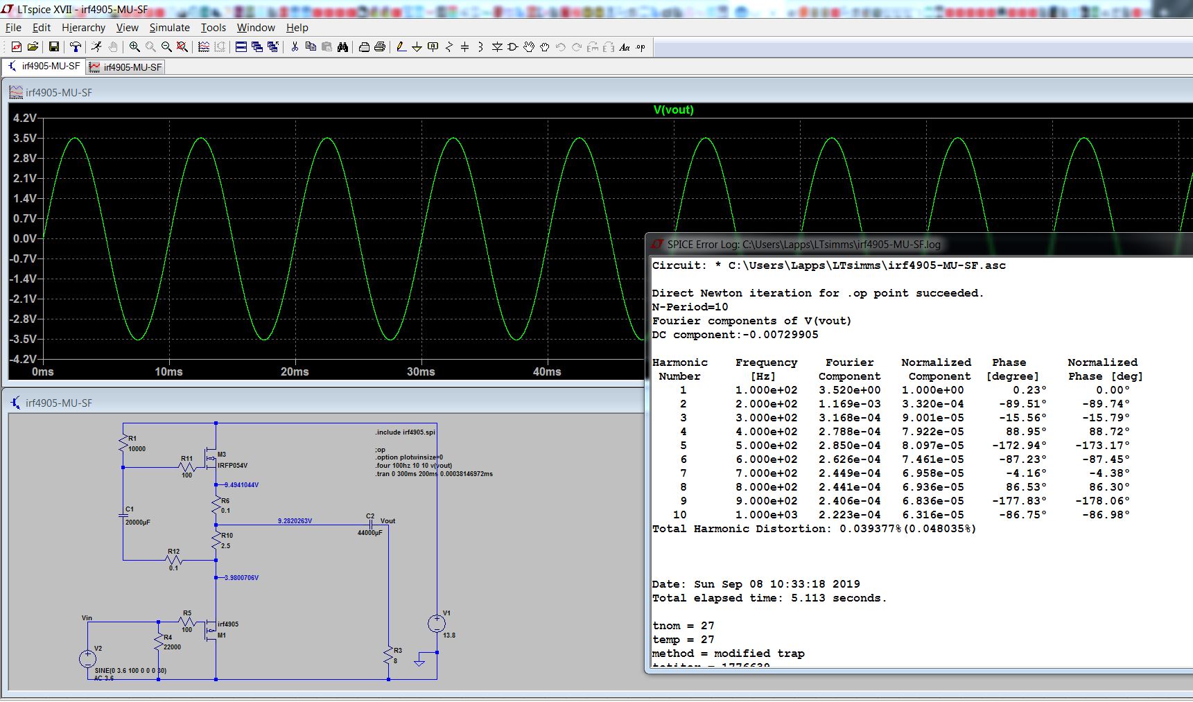

Superb harmonic profile:
649041d1512252857-build-mofo-mofo-67mh-1-7amp-2-83vrms-8ohms-fft-png

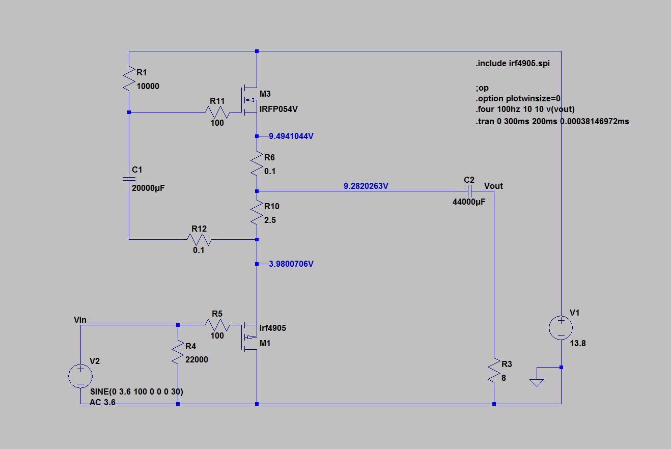

A simple powerbuffer with low distortion and very low noise due to the lack of voltage gain. Can be powered from a cheap 13,8 volt 150 watt Meanwell SMPS.
I would add a 1 mH air core coil and a 10000 mF filtering capacitor to each channel to lower the switching noise from the SMPS.
C1 and C2 does not need to be that large in real life. If you are using the amp to drive a high frequency compression driver then C2 can be 22 - 47 mF or so.
I would use at least a 1000 mF capacitor for C1.

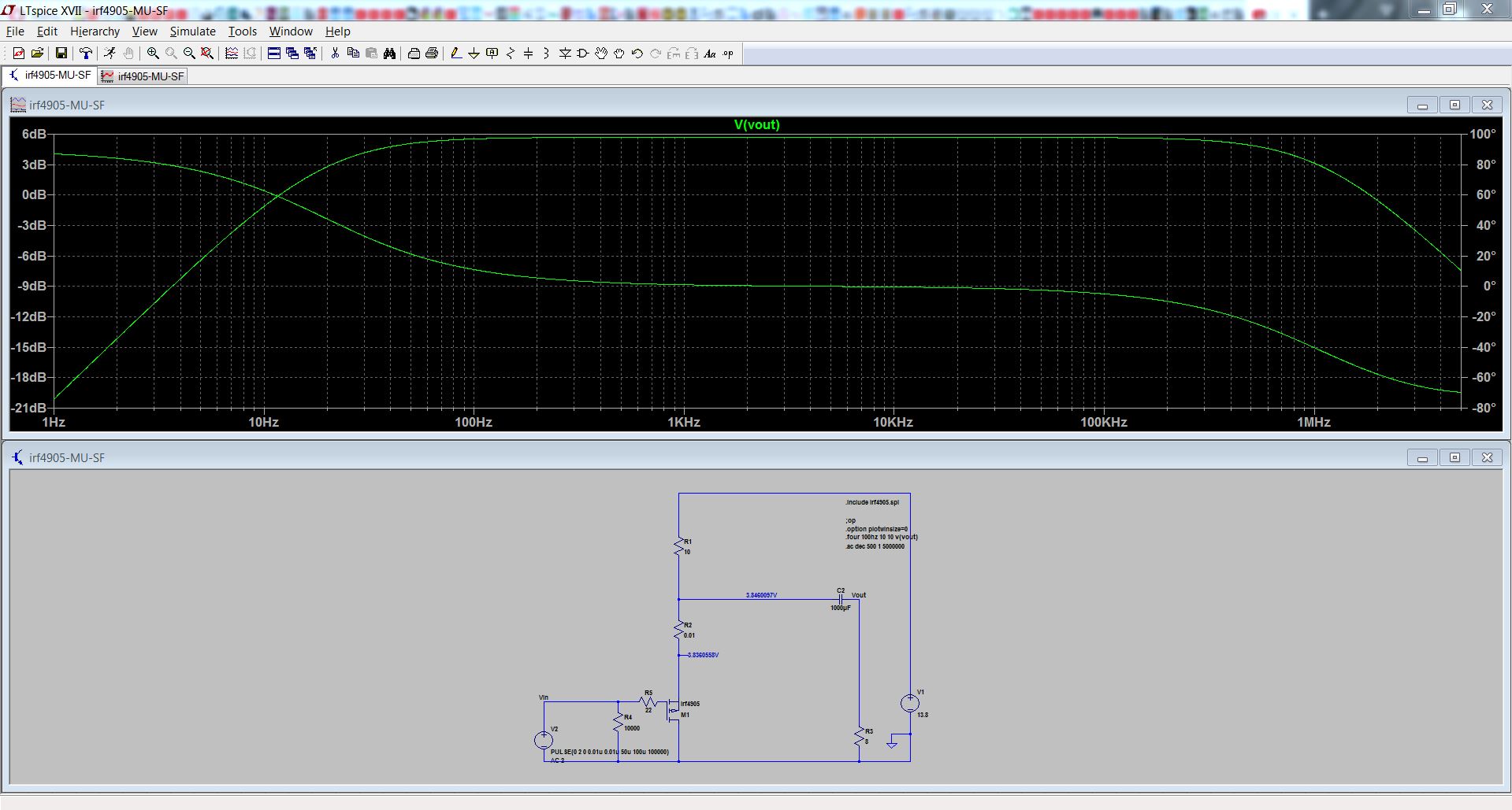

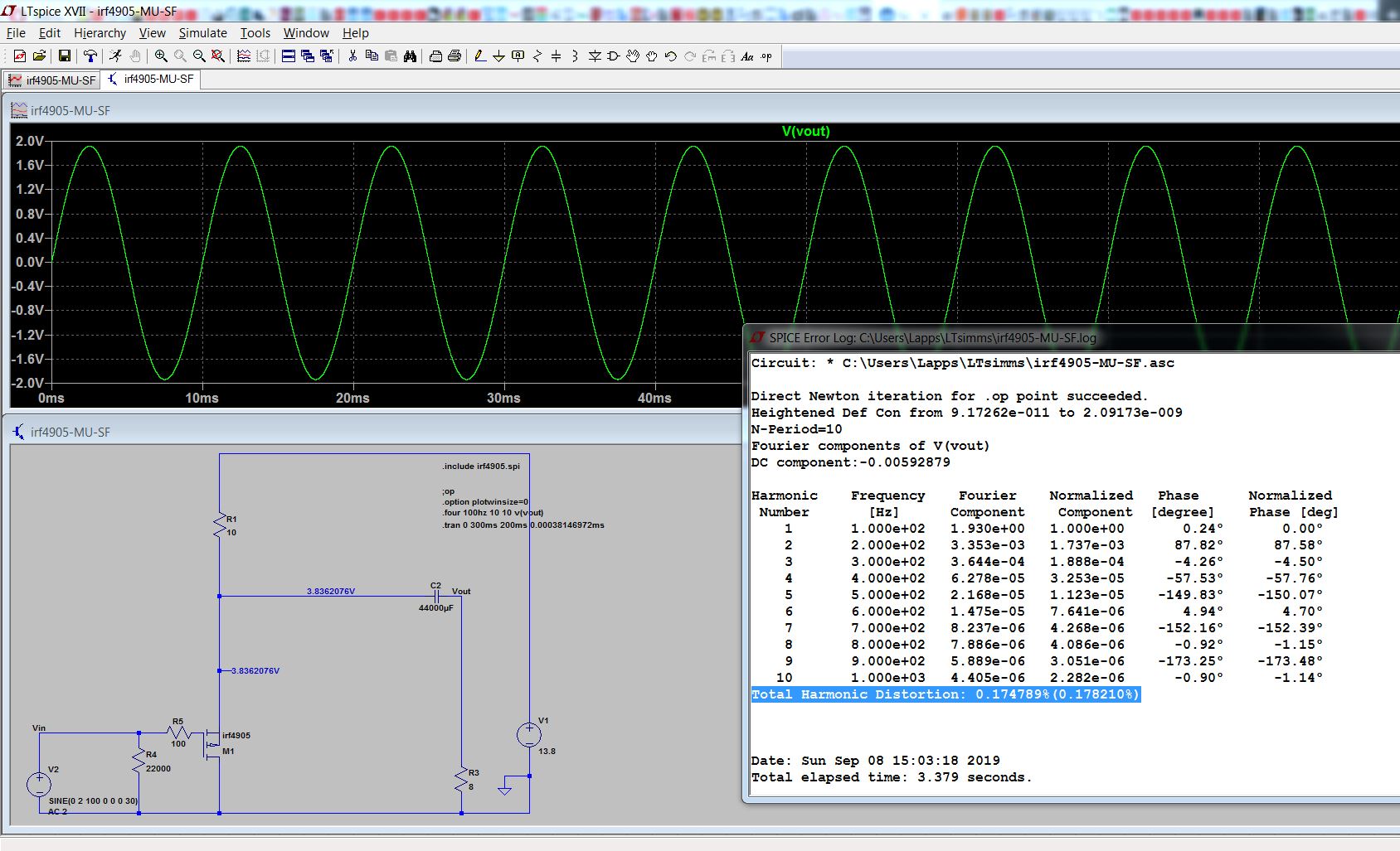

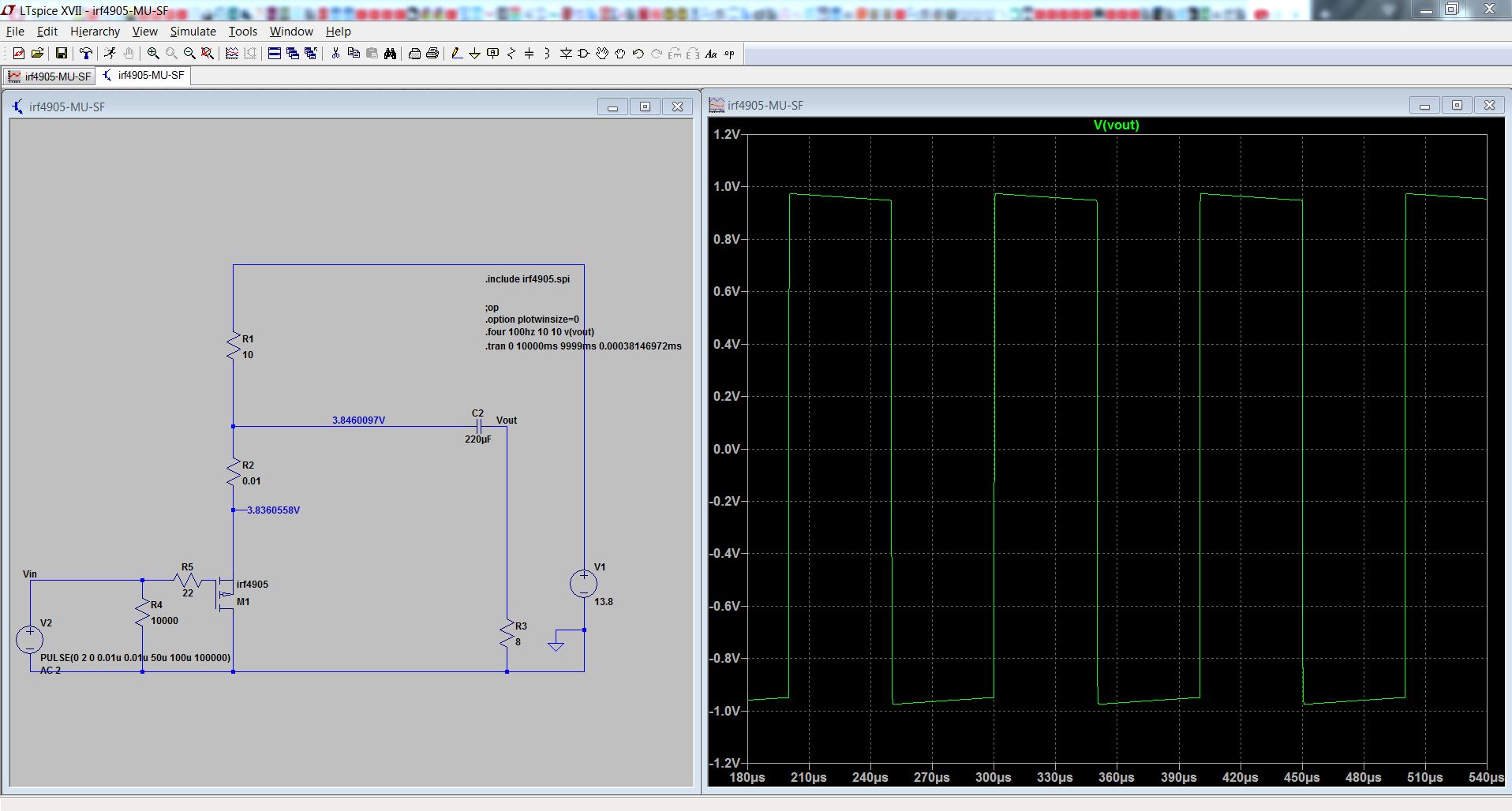

With a simple power resistor instead of the SRPP modulated current source you get more distortion and less voltage swing, but the amp is very cheap and easy to build with point to point soldering of the components. R1 can be a TO-247 thin film 100 watt power resistor.
The slightly increased THD is mostly a positive going second harmonic making the amp sound more like a nice tube amp with a more forward and vivid presentation of music.

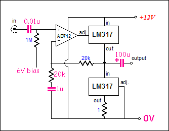

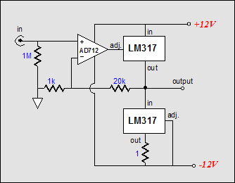

Since my power requirements are low, I decided to try a follower powered from 12 V. It will work with a 5 mH inductor or a resistor and a relatively small heat sink.
What gain stage would be recommended when I will need more Watts?
cumbb, I meant that the gain stage would be inside the same box and powered from the same supply as the follower.

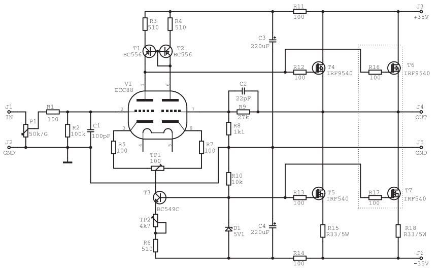

Actually I built this hybrid ECC88 (for gain) + Mosfet Follower amplifier a long time ago (as a school project, designing the PCB and building a prototype), I need to dig it out, it never made it to a final product - especially due to the crazy cooling and power supply requirements.
I meant too;-)
The school project is too complex to get a clean tone, sound. And never a complementary-transes-pp and not "complementary-psu's". My mind.
A valve for gain is a good idea.
You could use an ECC182, 13P1S, ECC86, EF98 ... driven by 12 Volt.
Should be possible.
