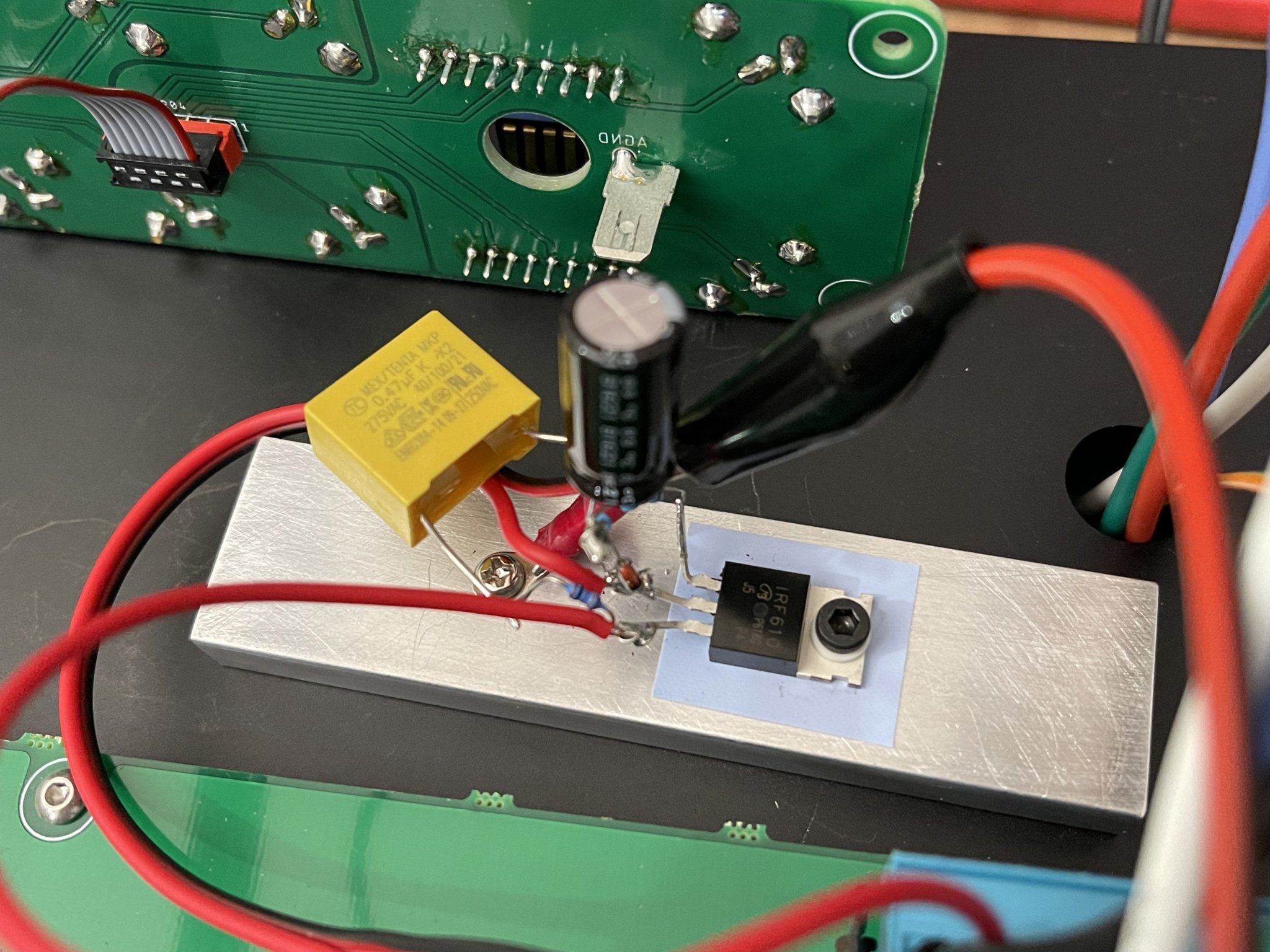

Use Juma’s Easy Peasy cap multiplier for PSU. Simple and reduces ripple by 50dB. Can make as dead bug on mosfet legs.
Yes, that one would be definitely a part of the PSU, when it comes to that stage. I already have some parts and some nice heatsinks.
Attention: The most MosFets do sound not very well. In PSU too.Yes, that one would be definitely a part of the PSU, when it comes to that stage. I already have some parts and some nice heatsinks.
