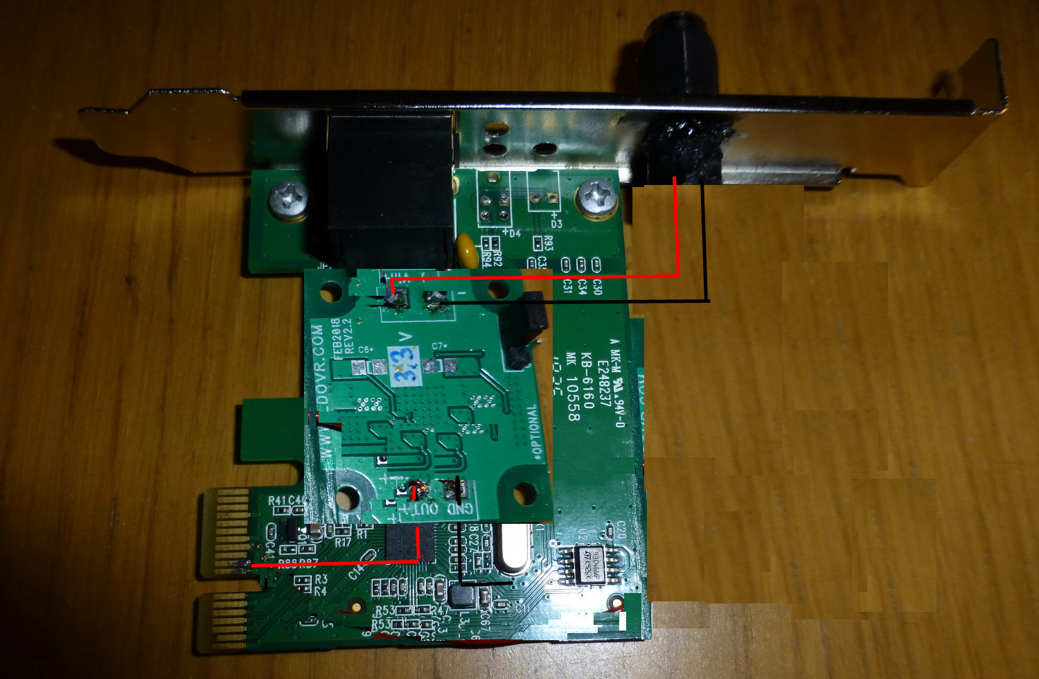

Here is my current little DIY project, not very advanced 🙂
I took a cheap TP-Link PCIe network card, cut the 3.3v to PCIe/motherboard and replaced it with external power through a linear voltage board. The result so far is very good, sounds better than my battery driven switch.
I haven't cut the ground to PCIe though, I'm afraid it might prevent the card from functioning, but it would be preferable if it was possible.
However, to complete it I would like to replace the clock as well, so does anyone know of a low-phase noise quality clock for 25Mhz that can be ordered online and in quantity of 1?

Have a look at what I attached...
1. the photo shows how to position and wire up the LDOVR 1A 3.3V regulator
a) solder solid core copper wires to +3.3V DC rail and to the ground fill.
b) slide (open the eyelets first!) the LDOVR reg on to these wires, and then secure the reg on that big black IC. Solder the wires to be as short as possible.
c) use one of these: 35SEPF22M (22uF/35V). Solder this cap to OUT+ and OUT- outlets on reg board. Keep the legs as short as possible. You could actually, slide both the capacitor legs and the copper wires at the same time, through the eyelets, and then solder the whole lot in one go. The eyelets diameter is large enough. This will ensure the shortest wiring. NOTE: that LDOVR reg needs to see some capacitance at its output to perform at its best. Just be sure to keep the capacitor legs as short as possible.
2. Once you move to DAC xtals/ oscillators, always go with NDK; much better than the competition. See the document I attached. Also, go straight to SDA types, which have much better phase noise at crucial frequencies of 1Hz, and below. They are difficult to find in quantities of 1, but search the net and you'll find them. See the pdf attached!
The above will keep you occupied for a while. Continue playing, experimenting, reading and...learning. The mod I suggested will give you very good results. Let us know what you think...
Good luck,
Nick

I just saw mterbekke's post... do not cut any ground copper fills...

Cheers for the help, I will do the capacitor fix but think I will leave the reg board as it is (its so nicely glued there on the top) 🙂 I use solid OCC coppar (Neotech), leftover from some cables I made, awg 18, so its not like an inch of extra cable will matter much
I use an NDK already, in my DAC (RME ADI-2 has this one NZ2520SDA(Ultra Low Phase Noise Type)/Crystal Clock Oscillators/NDK ) but I could not find the SDA in 25 Mhz, but NZ2520SD (without A) can be ordered from Japan though, see link below:
