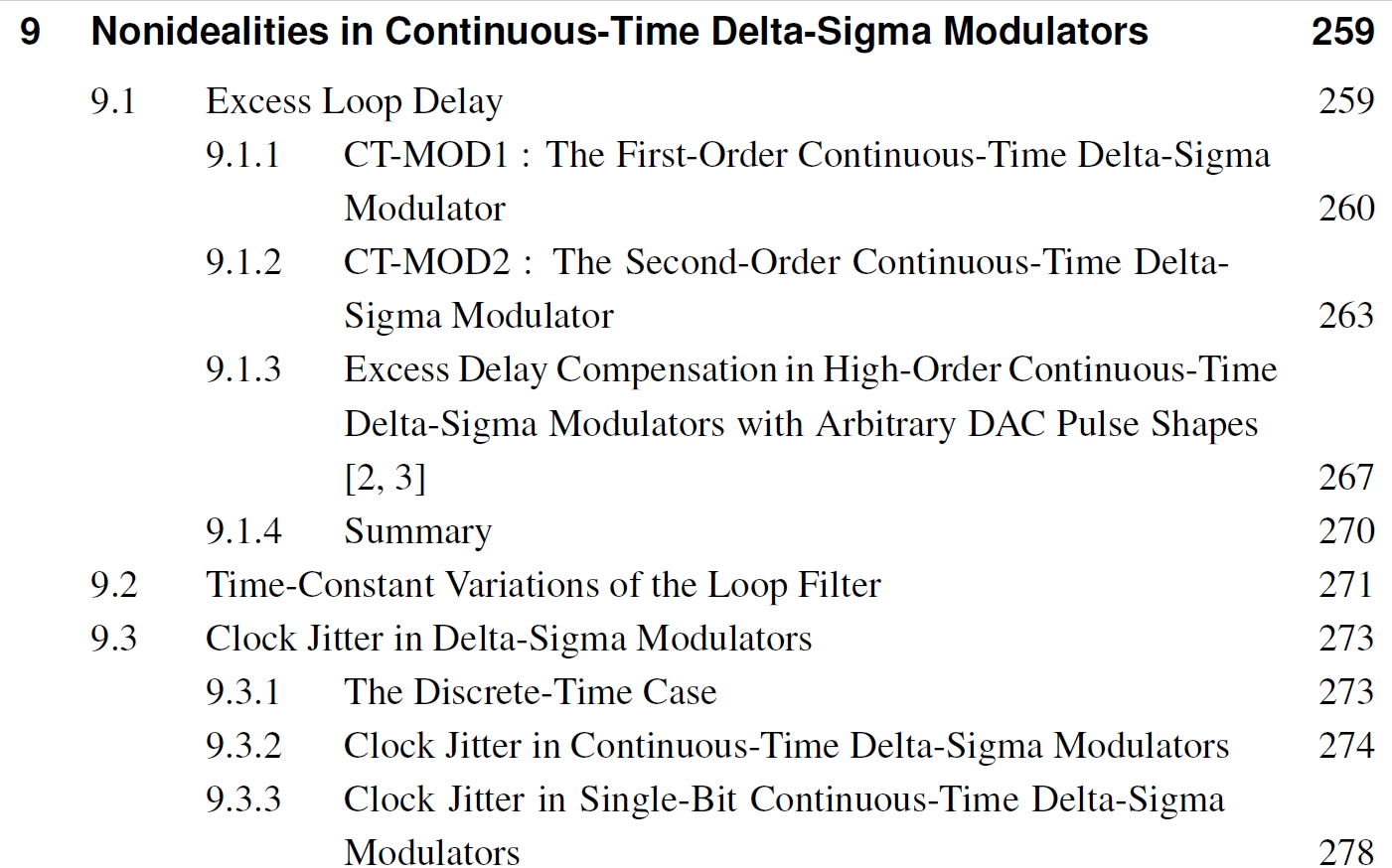

No they are not. DAC literature is written to market a product.
Please see Understanding Delta-Sigma Data Converters, 2nd Edition: https://www.wiley.com/en-us/Understanding+Delta+Sigma+Data+Converters,+2nd+Edition-p-9781119258278
Chapter 9 table of contents attached below.
That (in bold) is the key word which many unsuspecting consumers / diy-ers fall for.
