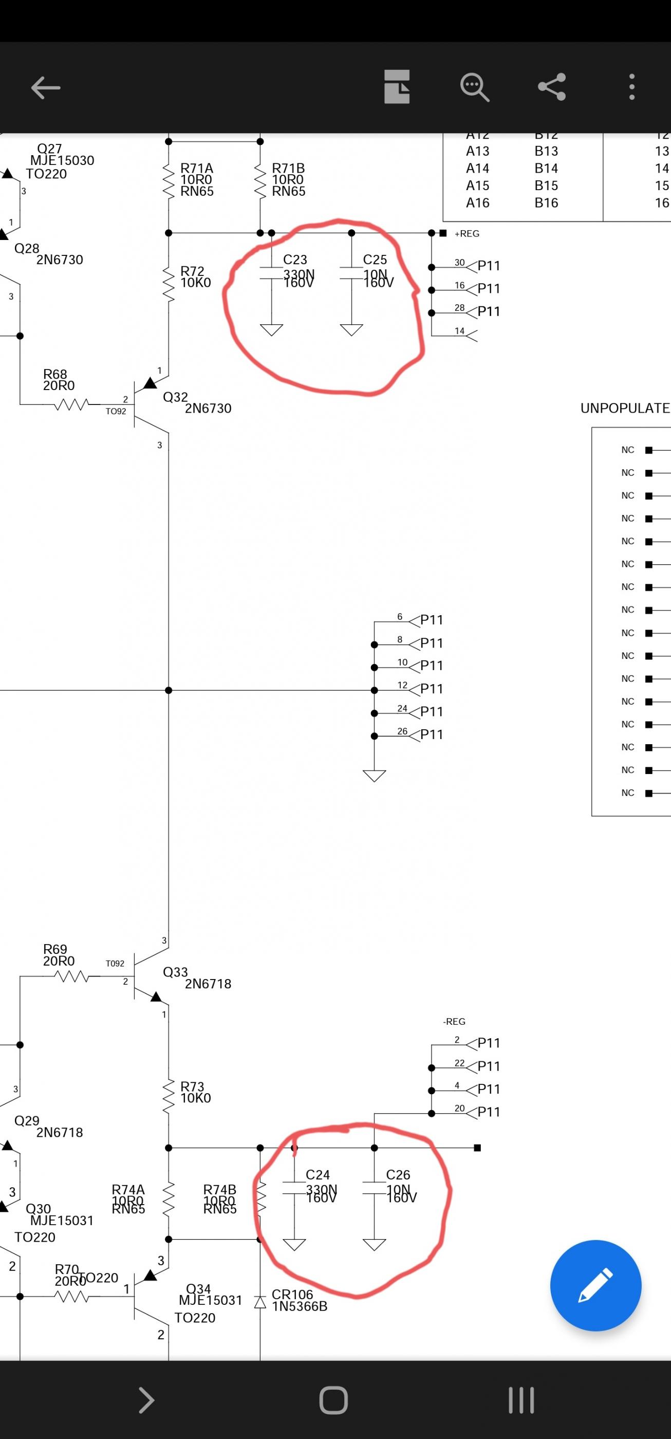

Hi guys
I need your help in order to understand something
I tried to understand the differences between the no 33 and the 33H
And one of the differences is in the voltage regulation circuit that supply the input stage
At the end of the circuit you can see 2 electrolytic capacitors of 100V 330uf while in the 33H there isn't any...
Why is that ???
Why is that ???

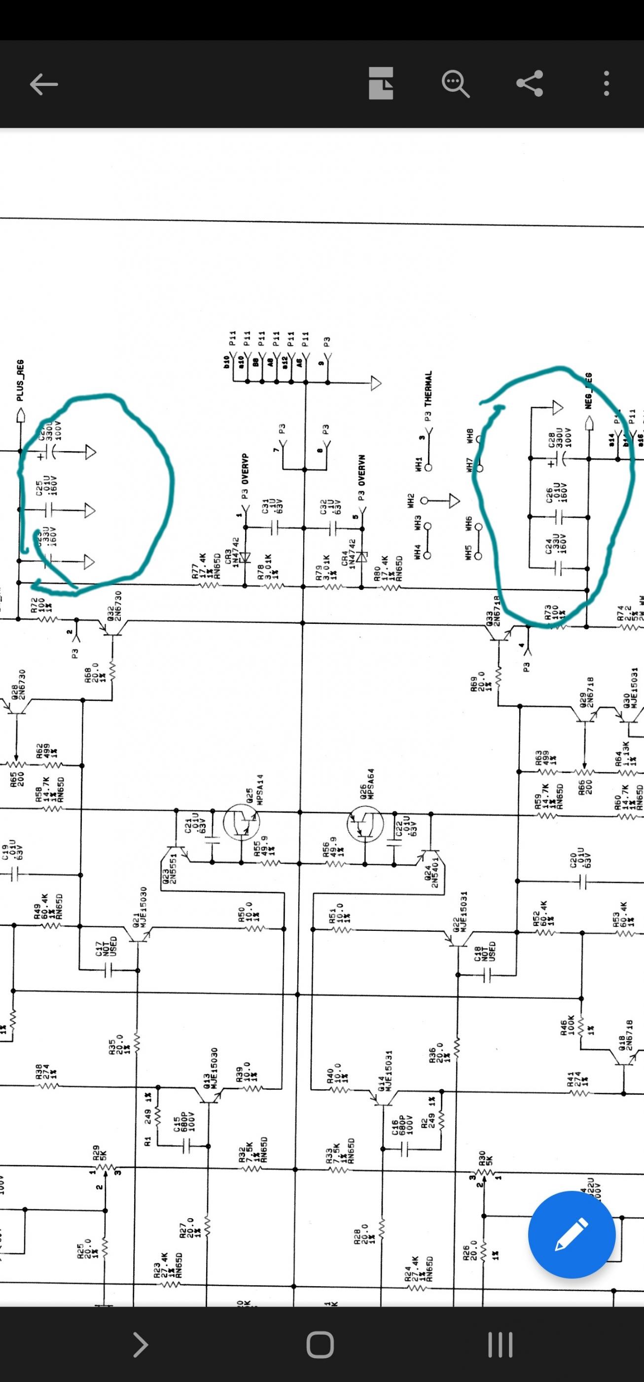

Hi Chris
Thank you very very much
I have marked the exact location
However the VR33JR file refers to the 33H And the REG 941031B refers to the 33
Hi Montana,
Those parts are completely non-critical in value. The small values provide low high frequency impedance and the large ones give you a low impedance across most of the audio band. If they weren't there at all the amplifier might motorboat or oscillate, butall you need are reasonable capacitance values.
You might see this as a running production change where the circuit doesn't match the schematic in this way. In any event, no big deal.
-Chris
-Chris
Hi nehoray,
Okay, no problem. They simply discovered they didn't need the large bulk capacitance and saved a little money by not installing it. The choice may or may not have been wise under all conditions, but I can't say without having one on the bench. Alternatively, a new board layout may have made the larger capacitor unnecessary.
There are any number of reasons why that part was excluded from the design. The smaller ones likely are what was needed to solve the problem. If the 330uF was in the earlier design, it was installed just for good design practice. If it was the other way around, they discovered they needed it.
In short, I wouldn't be too worried about it. Assume the design is stable since they are a commercial design unless you experience problems.
-Chris
-Chris
