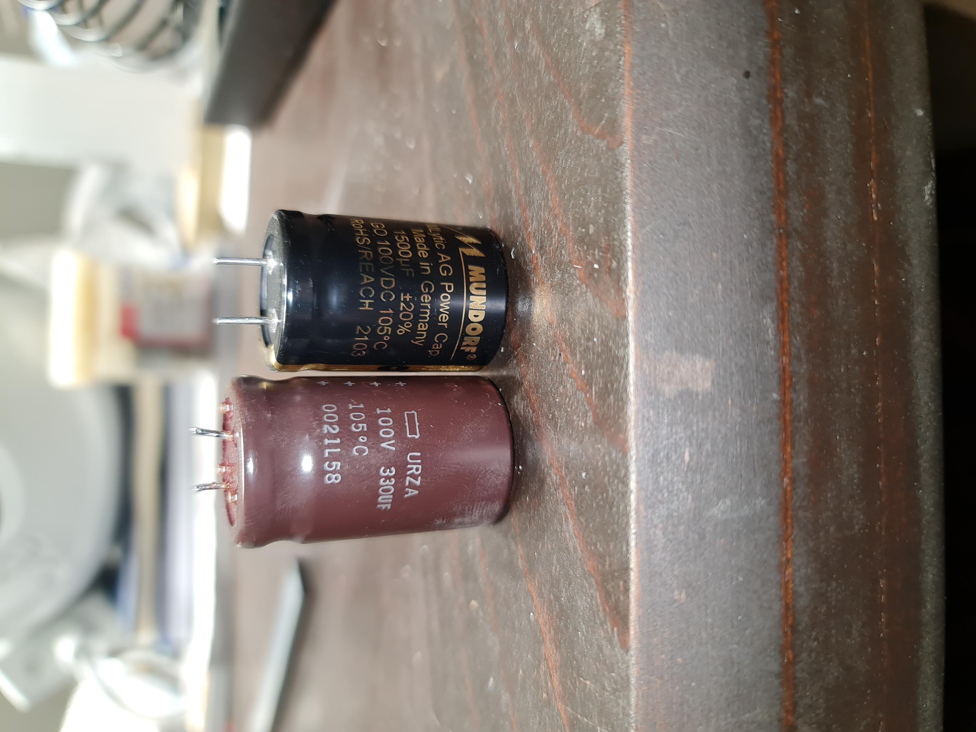

I don't lie to you I did increase the capacitance at two points in the amplifier.
Hope they will not cause any problems...
Regarding to the original capacitors, all the originals are ultra low esr
So I uses panasonic FS and nichicon UHE
The biggest increasment of the capacitance was the electrolytic on the output stage board the original was united chemi-con URZA
Real ultra low esr and huge size !!! And 330uf
Unfortunately those capacitor are no longer available
So I turn in to mundorf 1500uf
Peufeu in this amplifier there isn't any bunch of electrolytic only 4 units of 330uf.

I would have to examine the schematic and know exactly what you increased to make any comment. Suffice to say, I hope they physically fit on the PCB properly in the space provided. If they don't, remove them and install something that does.
All good capacitors will perform well. You can't hear a difference between them because they do not develop a voltage across the terminals - unless they are defective. In audio circuits, ESR is totally unimportant. DA is what matters. ESR is important in power supplies and supply bypass applications.
I would say that people who can hear the difference between good electrolytic capacitors are hearing things, because evidence does not support that claim at all. I've also tried, and I do listen to my work as well as measure it.
Also, capacitors are not necessarily bad in the signal path. Bypassing or not installing a DC blocking capacitor from an amplifier input, or preamp (or signal source) output is completely irresponsible. I'll go further and claim it is stupid. I have had preamplifiers go "DC" on one channel, and the amplifier successfully destroyed a woofer by burning it. It was a well known brand that didn't use blocking capacitors in preamp outputs or amplifier inputs. The DC servo in the preamp went bad. These things do happen, expect trouble. For the sake of some ad copy, one person paid for a new woofer and amplifier repair that didn't have to happen. The speaker could have caused a fire, but it didn't. The woofer did burn.

United chemi-con URZA are very lage cans, as a matter affect they have the size of snap-in capacitor, just that URZA has called radial because of its legs.
The legs spacing and the holes in the PCB is 100% feet
The funny thing is that the URZA is even larger by it height
Yes those capacitors placed in the power supply Rail. So such low esr will do make a difference.

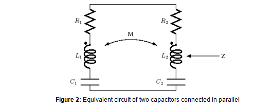

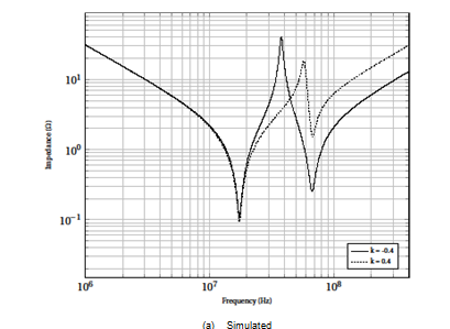

If you put two capacitors in parallel, they each have an ESR (equivalent internal series resistance) and some inductance due to the capacitor construction and the PCB traces or planes connecting them in parallel, so you get this:
If you squint a little bit, it is apparent that while the capacitors are in parallel to filter the power supply, to study how they will resonate, they appear as being wired in series. So, this is a series RLC resonant circuit, with:
L and R = sum of all the inductance and resistance in the loop
C = both capacitors in series, so if one is much larger than the other, it'll approximate as the smaller one.
So you can calculate its frequency response and damping factor (the formula for damping factor is in the link), and if there is not enough damping, you can get pretty nasty resonance peaks like so:
In the time domain, these peaks translates into ringing.
Note this is a high frequency example between ceramic caps, but it's the same in audio circuits, the capacitors have larger values, but the inductance is also much larger, since traces are used instead of power planes.
So, a dude sees a power supply board, and there is a film cap on the output. It is connected through some wires (adding inductance) to another board which also has a film cap on it. But both boards have cheap general purpose electrolytic caps on them, with enough ESR to provide enough damping, so it works fine.
Then, having heard something from the internets, he replaces one of the "not gold plated enough" electrolytic caps with, say, a Panasonic FC which has super low ESR, or even worse an enormous audiophile film cap which has like 1 mOhm ESR and an inductance as huge as its size.
And that low ESR nukes the damping and creates a high Q resonant circuit with the wiring inductance and the other caps, and that throws a nice burst of 1-2 MHz RF every time one of the rectifying diodes (or the output power transistors) switches which kicks the butt of all the analog circuits in the box.
And then the dude posts "I don't like Panasonic FC they sound harsh".
So yeah, if you don't know what "series RLC circuit damping factor" means, you should of course use high quality caps that will last a long time, preferably 105°C in hot places, but DO NOT use the LOW ESR/LOW Z caps or yuge audiophile film caps unless you do the math :D
