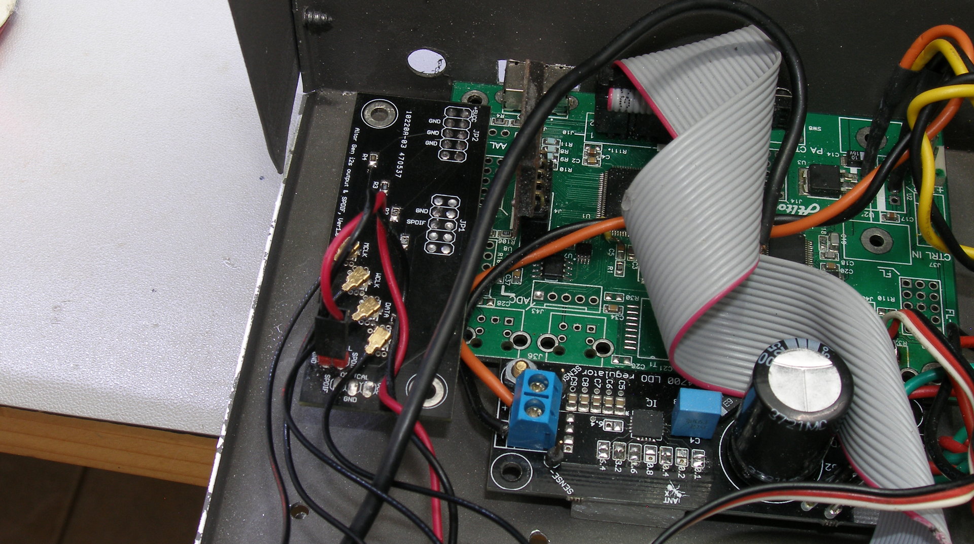

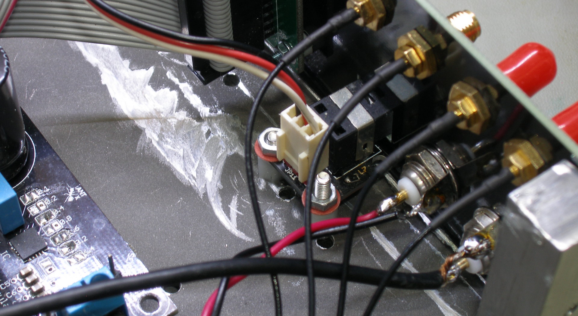

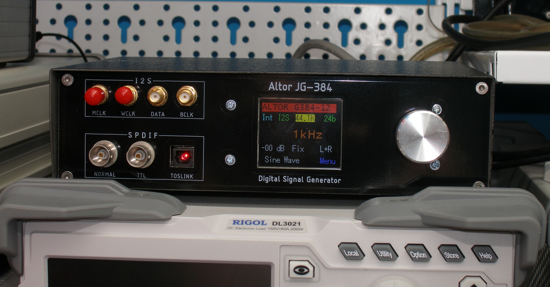

I had the JG-384 into a Low-Profile Aluminum Instrument Enclosure with a draft installation.
Because, I am owner of RTX6001 Audio Analyzer, I don't need the analogue JG-384 section.
For the new installation, I removed the DAC section and optical transmitter on it.
I made a small toslink pcb for the optical and an other add-on pcb connected on DAC's pins output.
I removed the front metal part of Low-Profile Aluminum Instrument Enclosure and set on it a PCB with a new layout. I changed the i2s outputs to sma.
