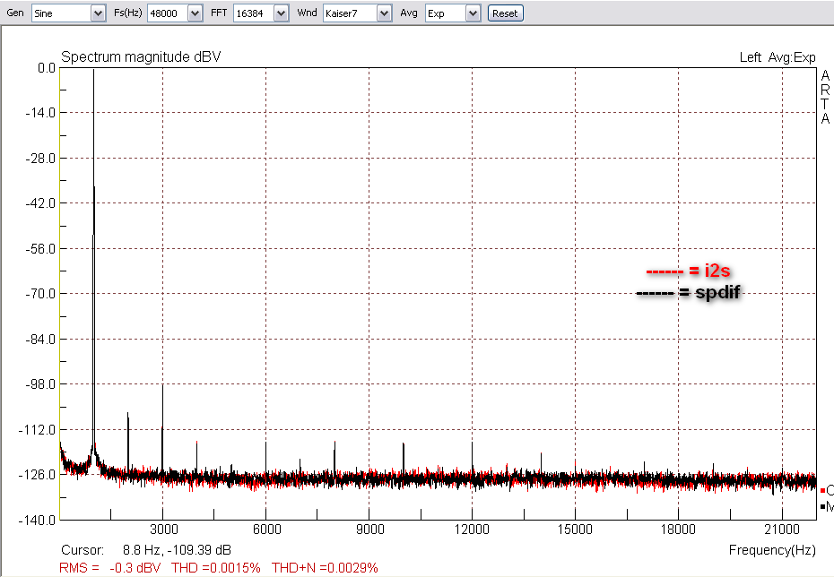

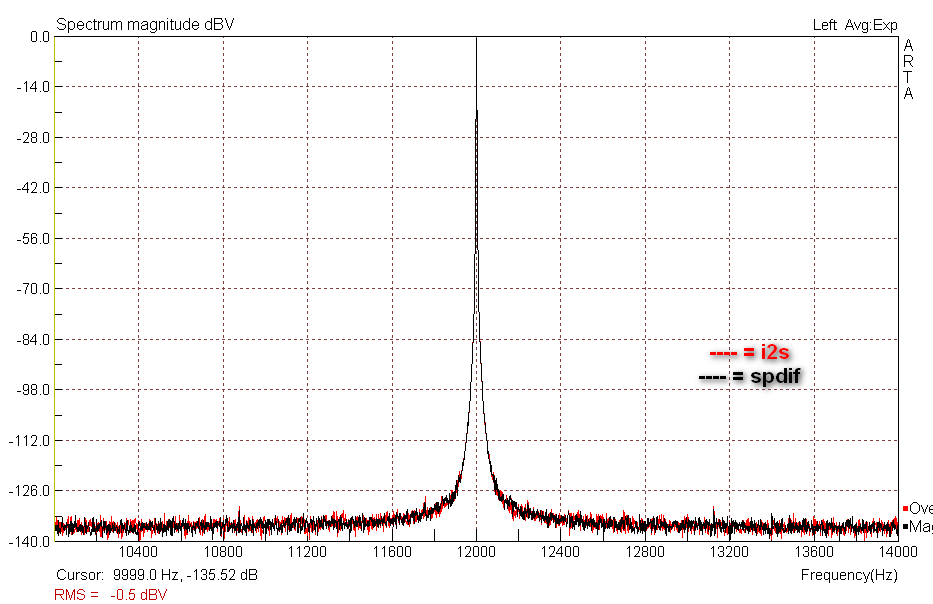

As a digital generator is very well. Here are some captures from an ES9023 based dac (THD, Jitter). They present two captures from either spdif or i2s input, the analogue to digital capture was done by EMU0404 (usb) with a 10K ladder attenuator.
I have attached another Jitter measurement from the same dac but the role of digital generator had a CMedia 6631A usb->i2s card.
As you can see the Altor JKGEN 384_12 has cleared jitter presentation.

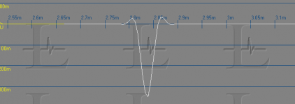

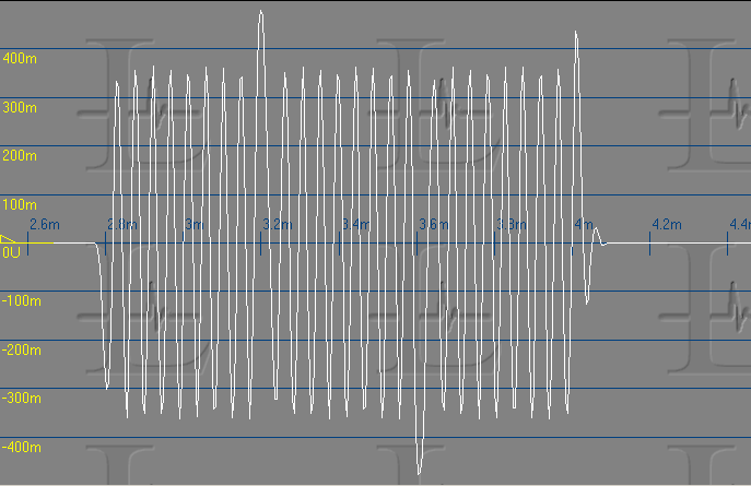

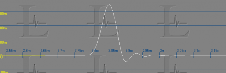

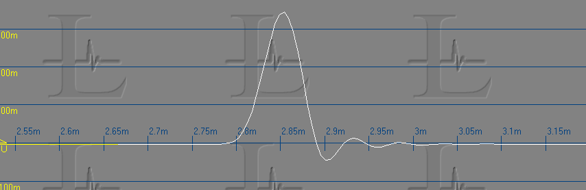

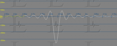

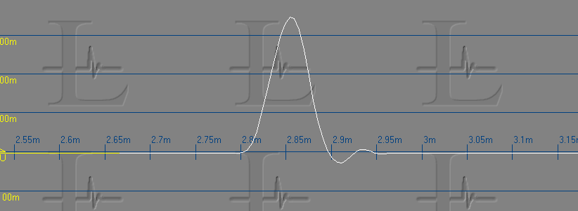

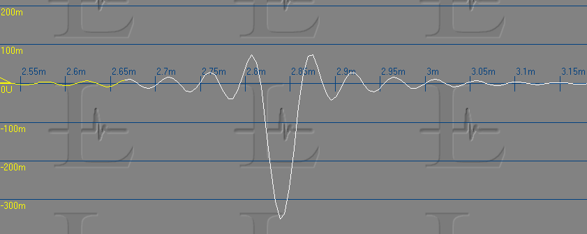

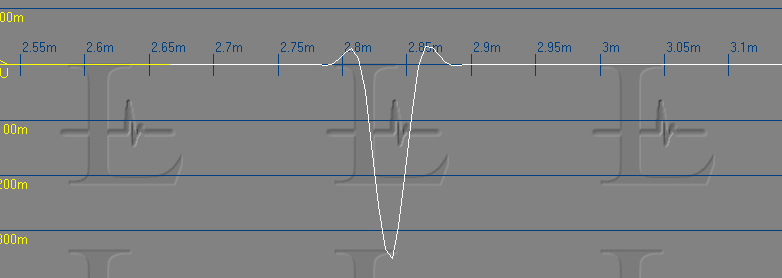

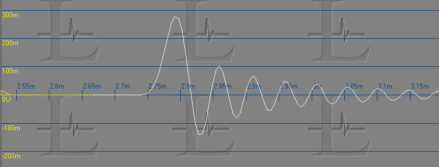

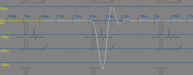

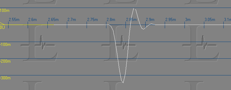

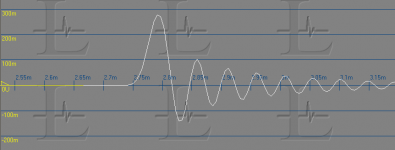

New waveforms tests
Here are some captures of the new waveforms using different filter options (AK4414 for the filter details short delay vs. normal and fast vs slow rolloff). The impulse tests are with a single sample pulse at full amplitude all at 44.1 KHz and captured at 192 KHz to not lose much detail.
First the impulse test, it will "violate" Nyquist in that it will have frequency content not possible to encode with an appropriate bandlimit. Essentially a recording should never have that encoded. The next waveform, sine squared (or raised cosine http://www.tsc.uc3m.es/~mlazaro/Docencia/DC/English-DC-T2-04-Raised_cosine-2p.pdf) is a valid waveform with the out of band info reduced (by 60 dB at least) so it can be recorded (which I did to show what the waveform is). Ringing on an "impulse" is not really valid but ringing on the sine squared would be an artifact worth understanding. Finally is the "cross sample" wave which is a burst with a 180 degree phase shift in the middle. This also is not valid with an infinitely fast change but it shows how some different filter solutions handle issues.
Some DACs actually clip on some of threse tests, it because the internal filter does not take into account the peaking of the low pass filter.

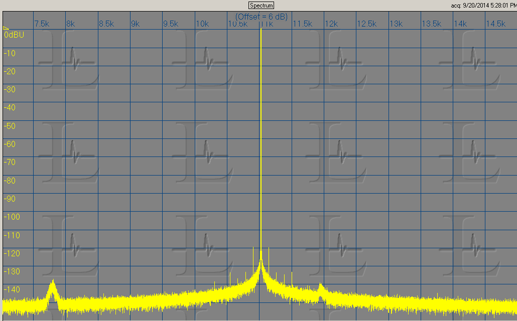

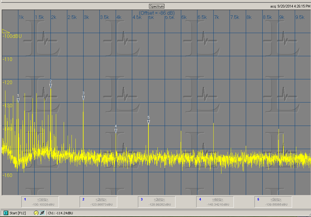

The generator just gets more capable. The issue came up elsewhere about getting DC out of an audio DAC. The miliHertz signals should help me see what is actually happening at those frequencies and effectively DC.
Here is a quick test of the new firmware (but not a new feature). Thsi is the AKM AKD4490 demo board connected to the JK1 via I2S running at 352.8 KHz sample rate -3 dBFS 1 KHz. The signal was routed through a Shibasoku 725 to remove the fundamental and scale the output. The distortion out was coupled to an EMU 1616M Line in adjusted for sensitivity and scaling in Praxis to get the correct output scaling of the distortion.
I will attempt the DSD setup but that gets really complicated since the demo board needs to be programmed via a USB port and program. Its quite involved and I may not be able to get everything to line up. The chip supports 1X, 2X and 4X DSD so it has a lot of things to tweak to get it working right.

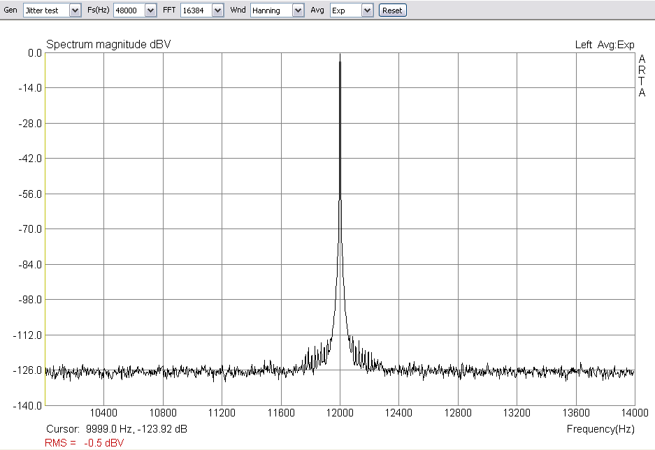

Also is a plot of the Jtest test at 44.1 over I2S. It probably would not show anything since there would only be the master clock to induce jitter and with everything synchronous not much is likely to show up. Still the only sidebands are at -120 dB. They at approx 120 Hz from the fundamental suggesting power supply modulation of the master clock.
