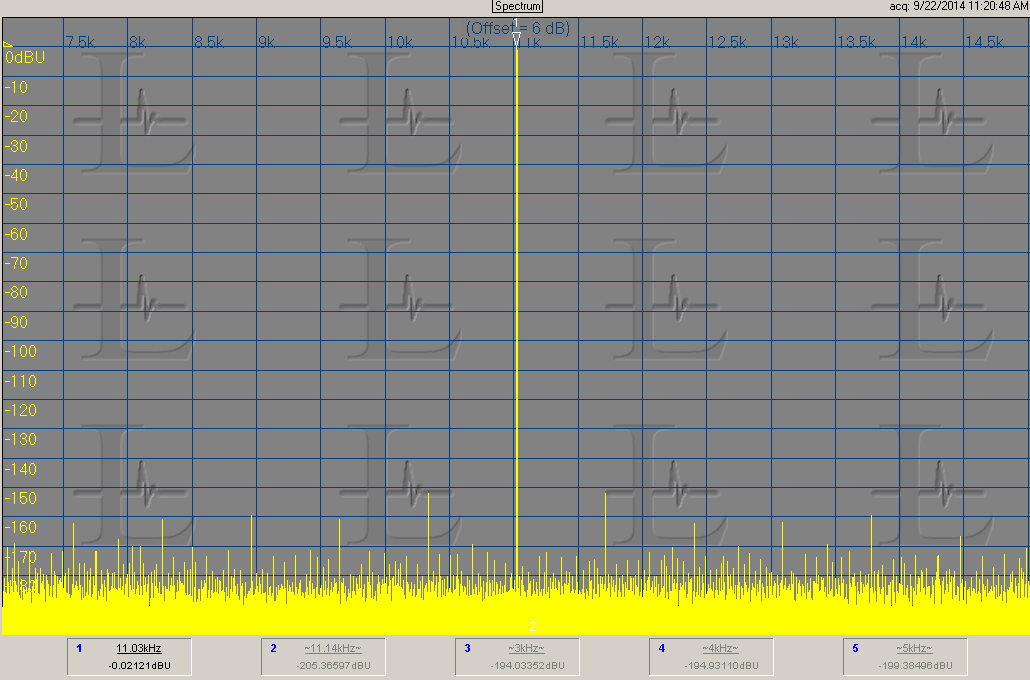

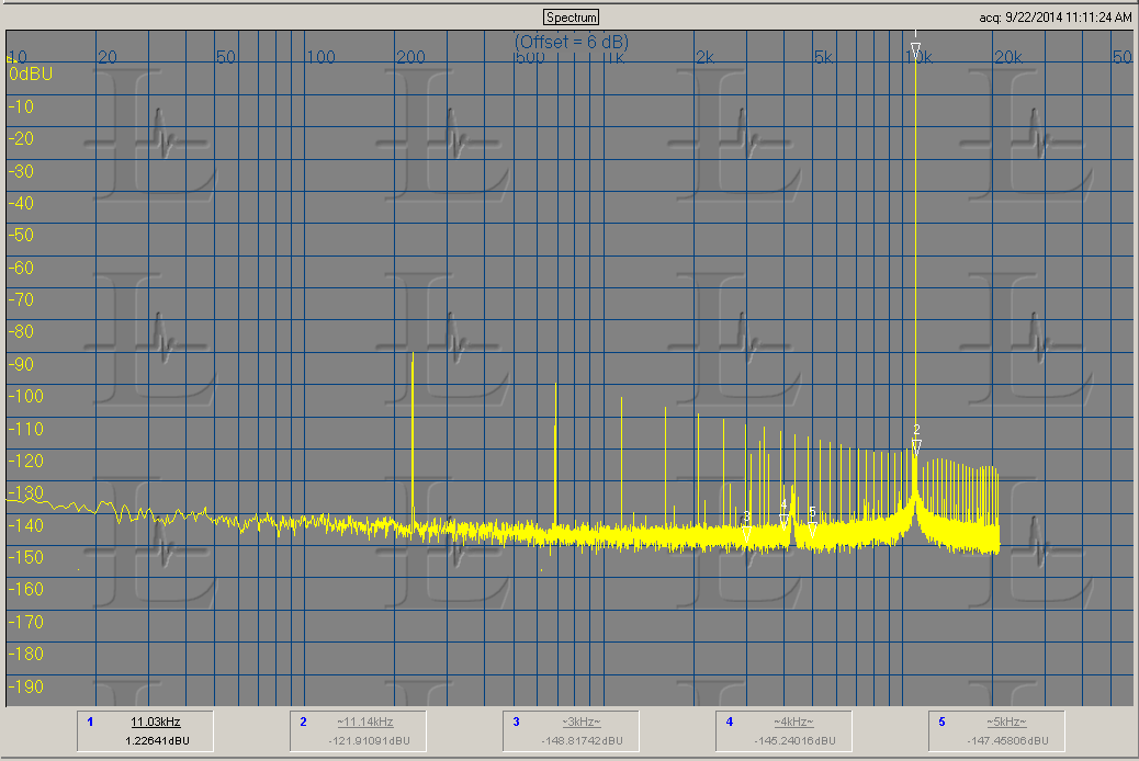

Also is a plot of the Jtest test at 44.1 over I2S.
Did you feed the JTest signal as an 16 bit? In my opinion may not..
Otherwise the LSB toggle signal is within marketing bits... 😀
Hp

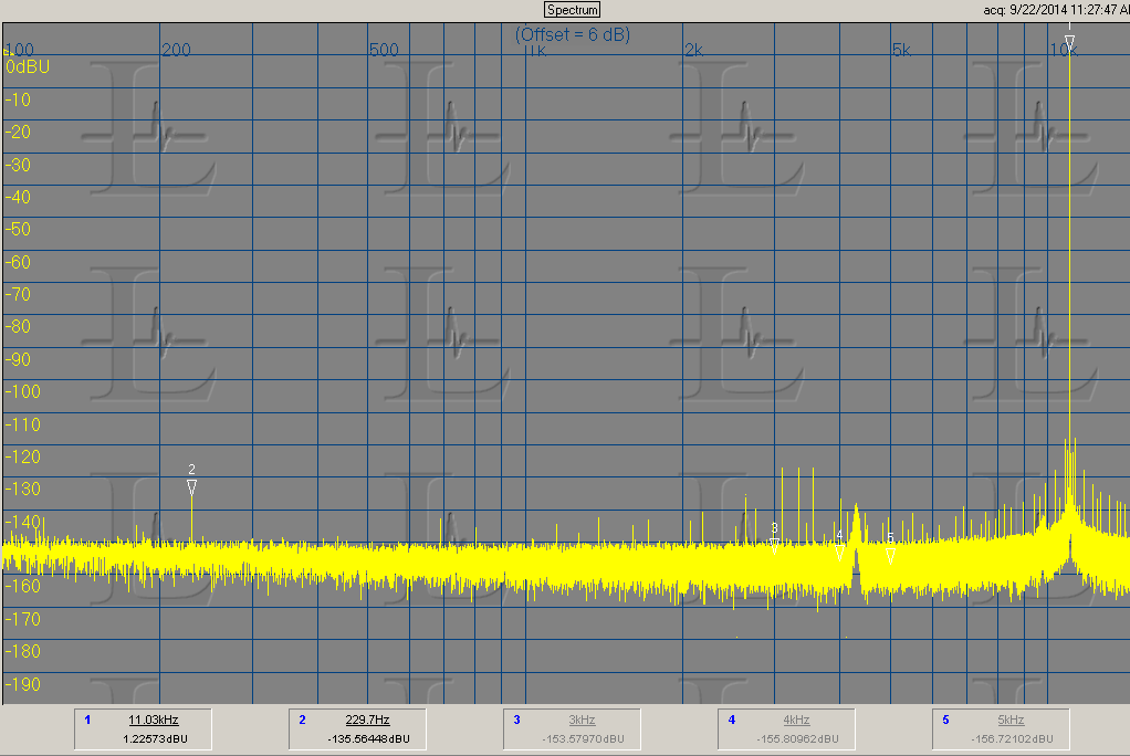

That is a question for Alex. I tried the 16, 24 and 32 bit settings and saw no difference. There is some activity at the 224 Hz region. We will need Alex's input to know what its doing.
I generate the following sequence for 32 bit:
0xC0000000, 0xC0000000, 0x40000000, 0x40000000 - 24 times,
then:
0xBFFFFFFF, 0xBFFFFFFF, 0x3FFFFFFF, 0x3FFFFFFF - 24 times.
For 24 bit the constants are 0xC00000, 0x400000, 0xBFFFFF and 0x3FFFFF and for 16 bit: 0xC000, 0x4000, 0xBFFF and 0x3FFF
for 16 bit.
I will check again what is really transmitted.

You may have a problem with the Jtest. Here is a digital link from the generator to the SPDIF in of the EMU 1616M. Source set to 16 bits. No sign of the LSB switching. It should have the 48K and a 1K LSB at 16 bits. Same at all the other options I tried.
1audio-
I will check with logic analyser I2S signals.
Meanwhile, if you are already have PC connection, you can make a record to file to see the data.

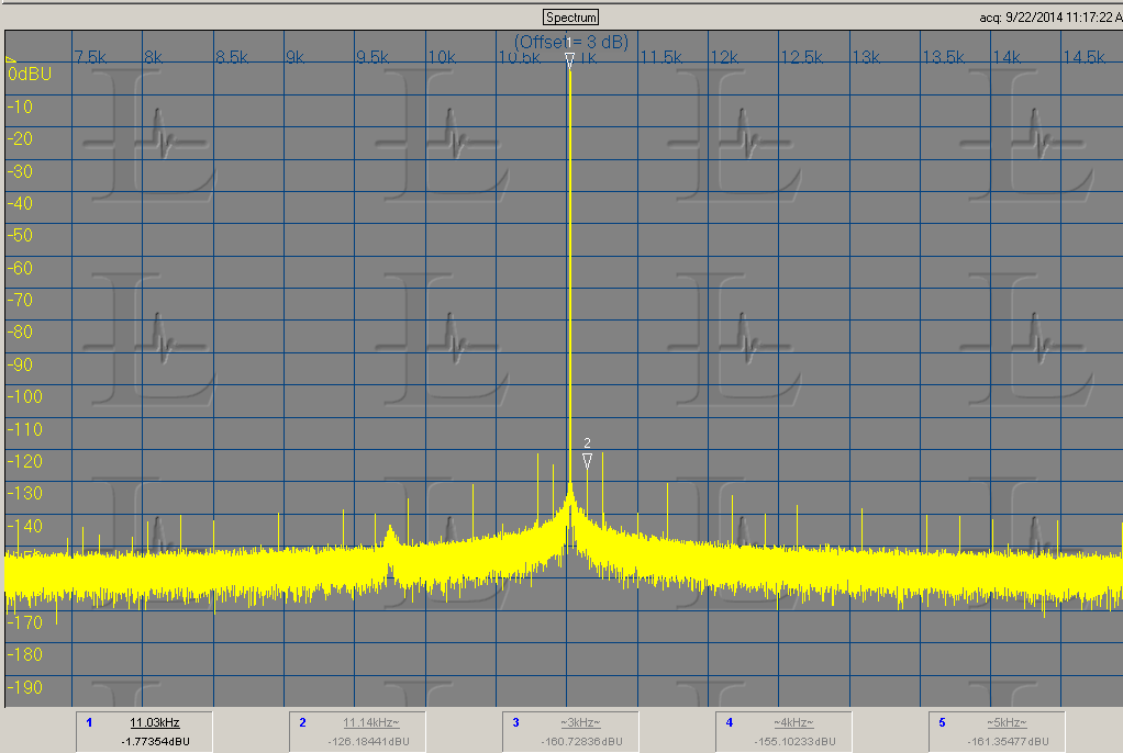

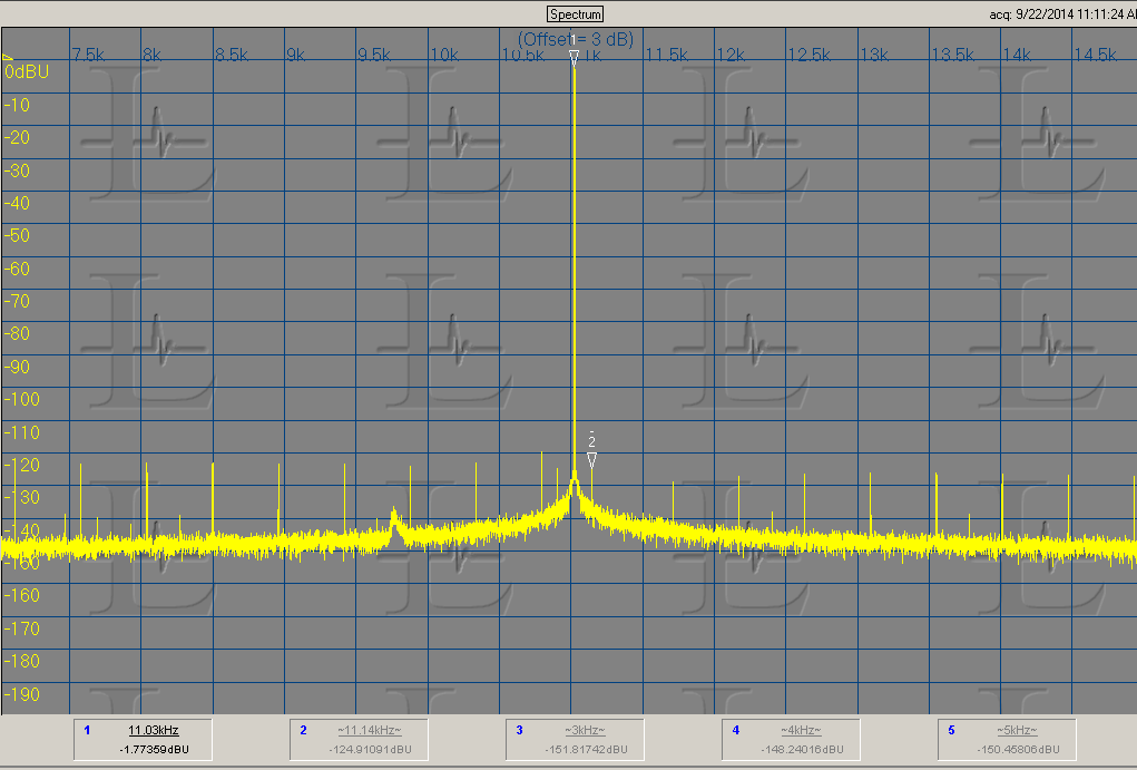

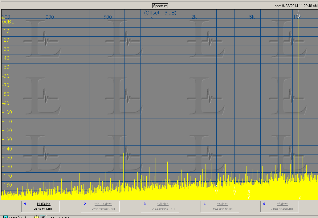

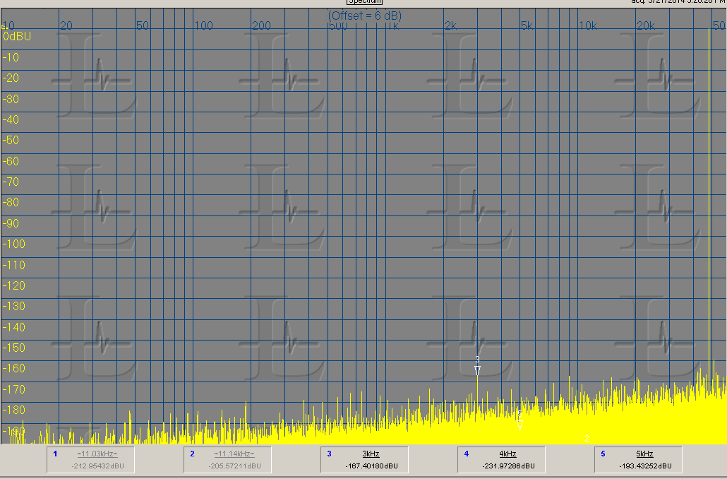

Jtest fixed. Alex found a bug and fixed it. Attached are digital and analog spectra of both 16 bit and 24 bit Jtest. The 32 bit is actually beyond academic for various reasons. This shows that even 24 bit LSB stuff is invisible.
The 16 bit tests were with a 100K FFT and 10 averages. The 24 bit were 1M point FFT's and 4 averages (I don't have the patience for 10 averages). The last plot is the AK4490 with the 24 bit Jtest. You can just see the LSB at 229 Hz and -135 dB. The harmonics will all be way below the resolution floor of a 24 bit system (and to my knowledge there are no 24 bit accurate DACs that can process audio, they are all too slow).
JK gen SPDIF 44-24 fixed to EMU1616m linear spectrum.PNG58.3 KB · Views: 101
Ohh, it was a shame bug - I simply comment the part of code when worked with new signal shapes, and forget to uncomment it....
