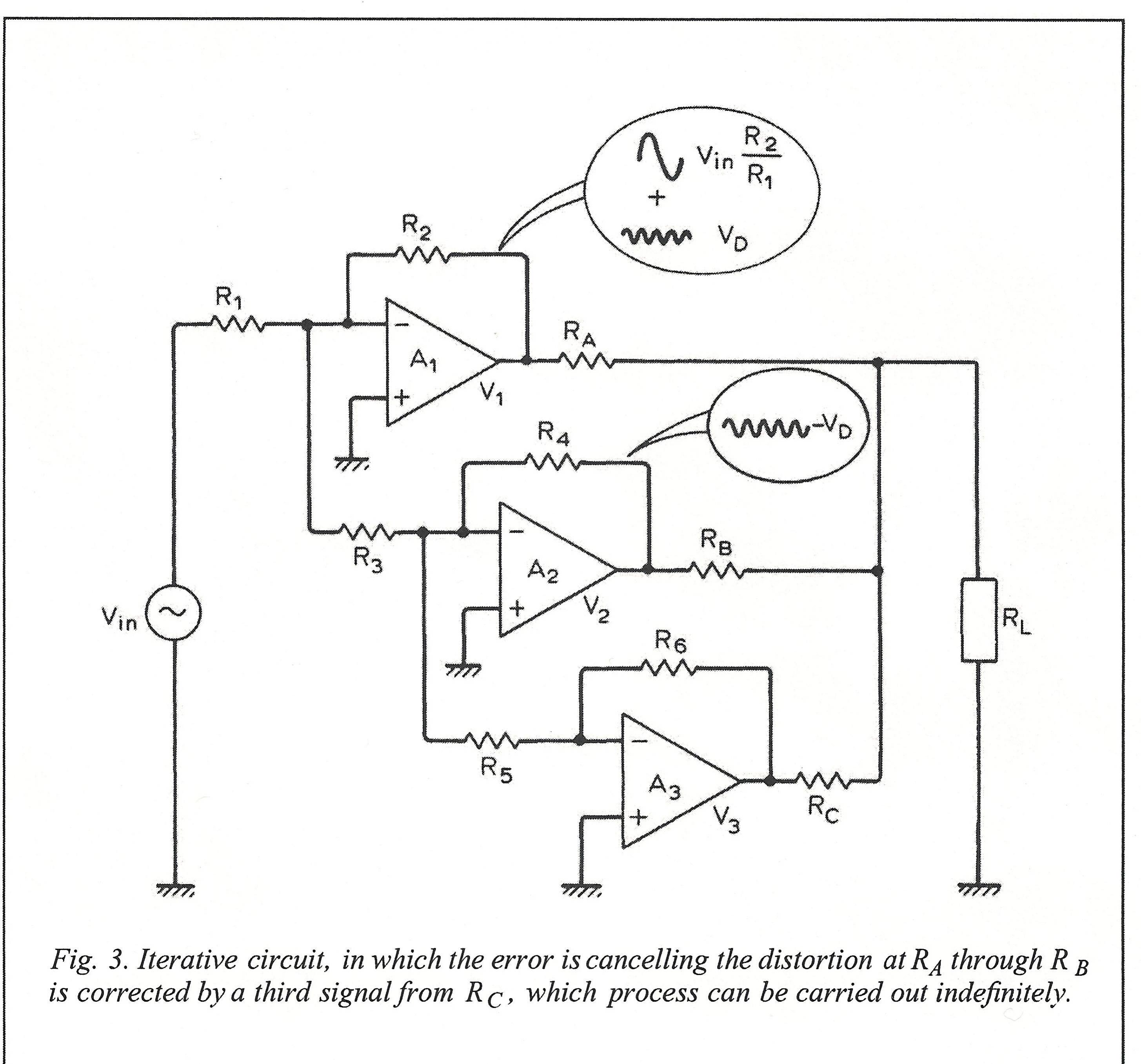

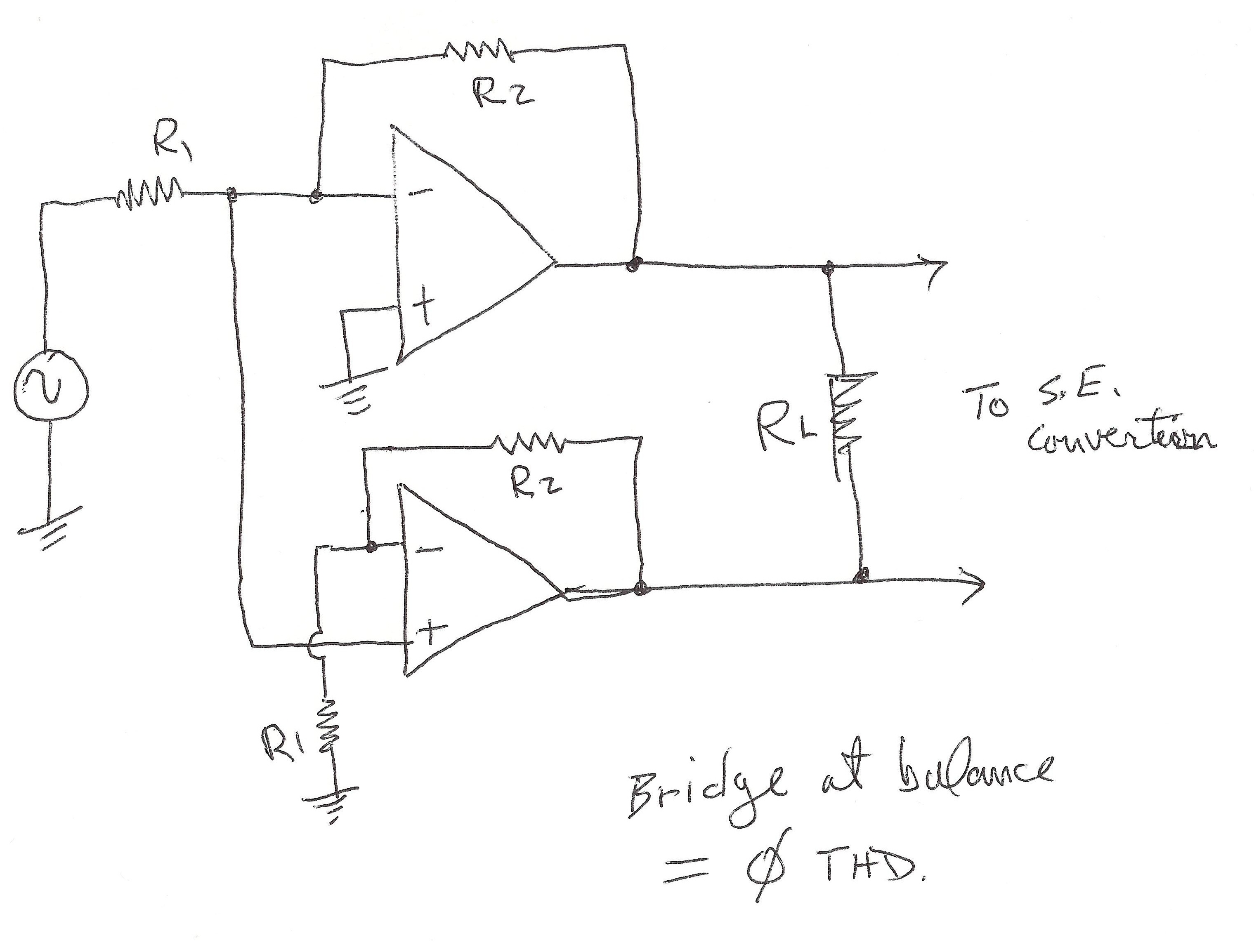

Awhile back i suggested taking oscillator distortion and inverting it and adding it back to cancel distortion. No takers. One way is as a unbal to bal converter using a bridge configuration to cancel thd... see below;
And the other is an iteritive circuit (using unbal/unbal). This can be used as the basis to make an oscillator of zero distortion. trim the values to null output thd. see below;
Pre-amplifier and power amp circuits can be made this way as well - using the error take-off point to cancel thd. It overcomes the basic limitation of neg fb which is - increasingly limited open loop gain with increasing freq. [Very low thd at very high freq can be accomplished this way]
[invented by A.M.Sandman] Thx RNMarsh
It might theoretically reduce amplifier distortion contribution towards arbitrary low levels, but it does nothing whatsoever about passives, layout effects, contribution from multiplier and level detector ripple... These are the real challenges.
