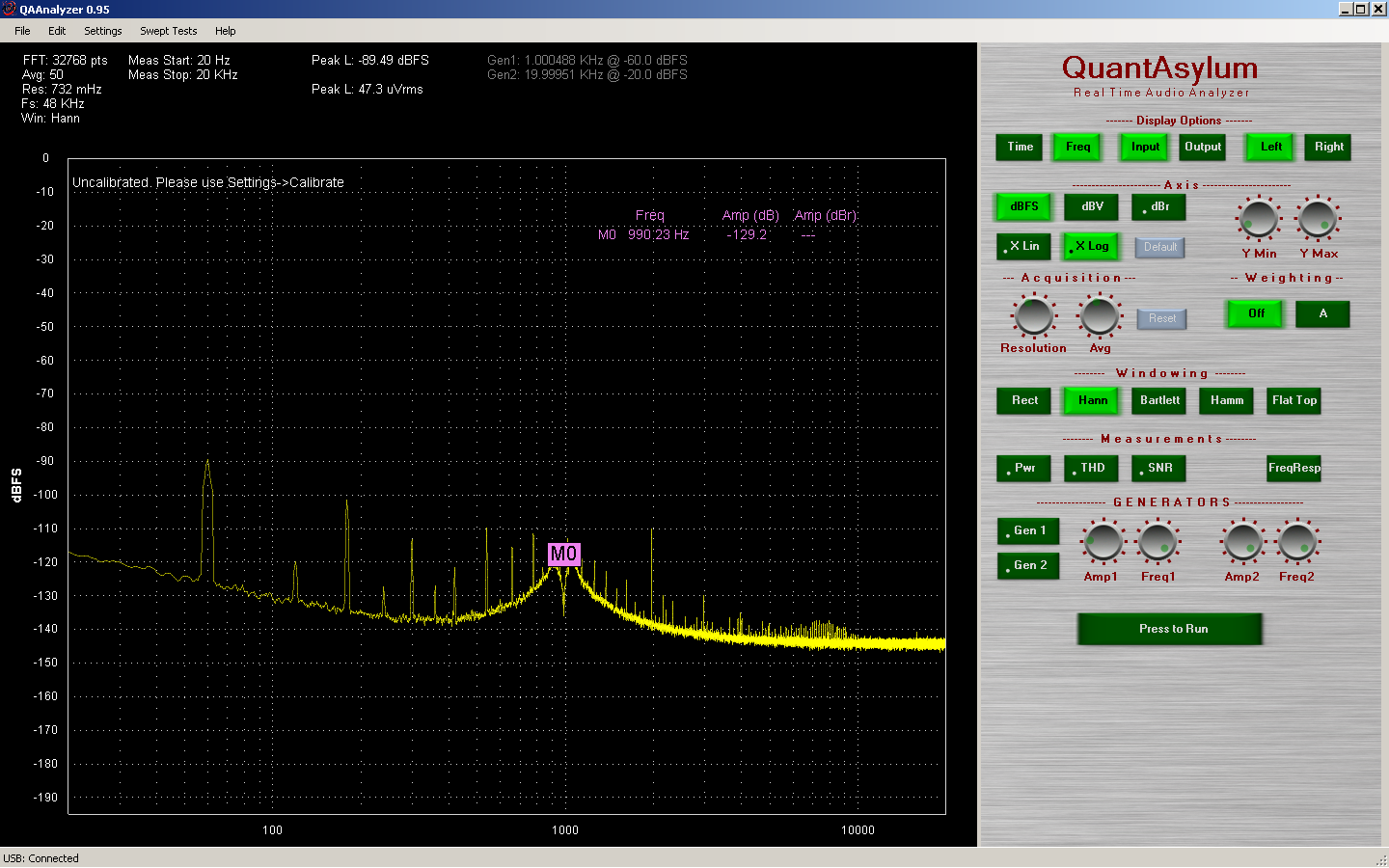

Hello davada,
Could you say what FFT software do you use for your screenshot ?
Regards.
Frex
Hi Flex,
Yes QuantAsylum is fine with me saying who they are.
You can check out there web pages here.
QA Blog - QuantAsylum Home Page
There are some videos there you can watch on the QA400 software and hardware.

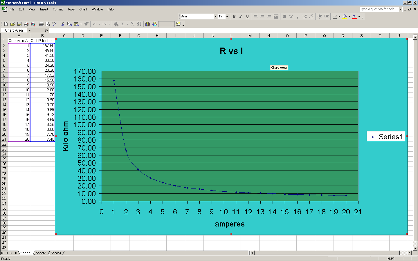

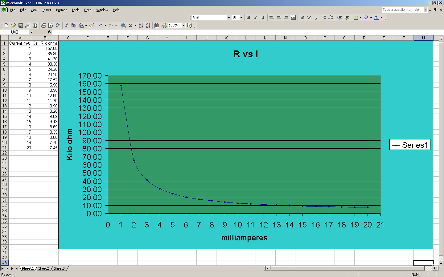

I hope that curve is in milliamperes. . .
Okay, Okay, I fix it.
The data columb says milliamperes.
I was wondering what that bad smell was.
so we shouldnt use it below 60K Ohms?? Adjust/scale it to be so??This better?
is Q of the notch high enough? More gain needed?
Can also measure THD of the LDR at different LED currents -- out of the box --- not in 339A circuit.

339a mod
Here is the latest.
I have averaging in the SW now so we can see more clearly.
I soldered a 50K trim pot across R48, the resistor to the non inverting input of the notch amp. The trim was adjusted so the total R is about 10K from the stock 15k. This forces the E2 LDR to operate at a lower resistance by increasing the gain of the notch amp. The auto tune has to compensate for the gain change. I also lowered the input voltage to the notch filter from 10Vrms to 1Vrms.
The effect of increasing the notch amp gain is a lower 3rd H and the 2nd H is about the same considering the scale change.
This is a what you see is what you get view.
The auto cal is temporarily non functional. The FS is at -0.5dB of dBV
Here is the latest.

The manual trim above is useful to me. -130 for 3rd is very good. -110 for 2nd -- only need find a few more db's there to get to the source oscillator level. 🙂
I am suggesting put external DC bias onto LDR to increase dc offset to the same as ac level or what ever level is needed to cancel 2nd. Thx-RNM
