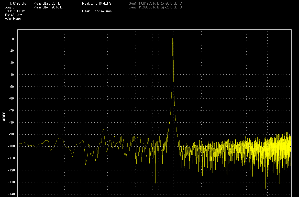

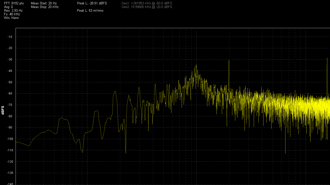

This first screen shot is with the 339a in level mode and the second is the same input level in distortion mode all from the monitor output.

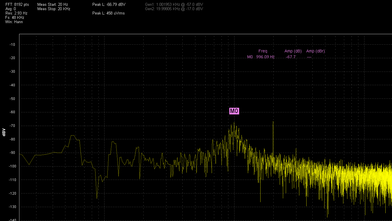

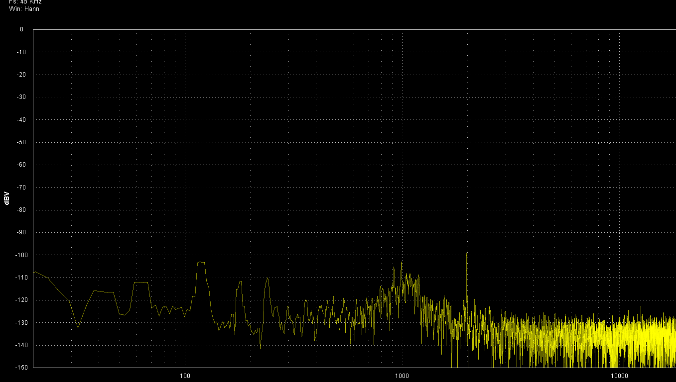

Test point 8 of 339a
With all else the same this is a screen shot of test point 8.
The output of the notch filter. As you can see the noise floor is much lower but
still has the x3 scaling from the input amplifier. With this scaled down 3:1 we have a nice spectrum of the input.
The second shot is with the input attenuator stepped up to the next 3Vrms range.
The harmonics change proportionally but the notch didn't change as much.
Definitely needs to be attenuated on the output side of the notch filter.
It looks like it needs to be scaled down about 45dB to get the true value which seems kind of odd. I'll need to see what the actual level is going in to the notch.
This is the residual noise floor of the input, buffer and notch filter. The notch won't go any lower than this. This is pretty much the bottom line for this analyzer as it is.
Overall this is much better.

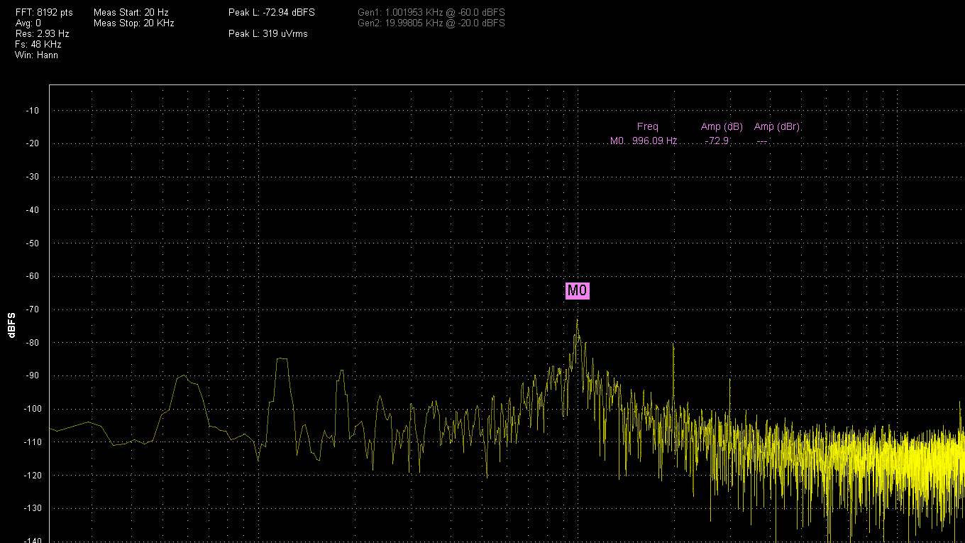

This is TP8 compared to TP9
The notch filter output and set level output respectively.
The levels are about the same but notice the cancellation of the 3rd H.
This is not good.

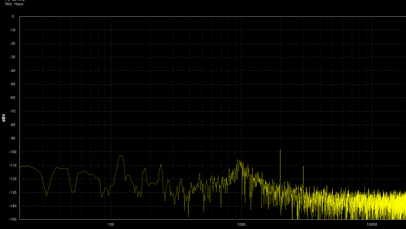

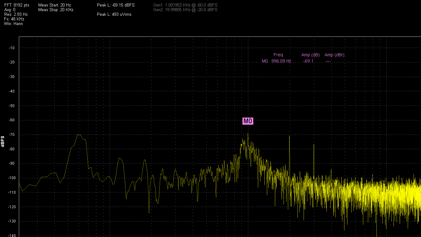

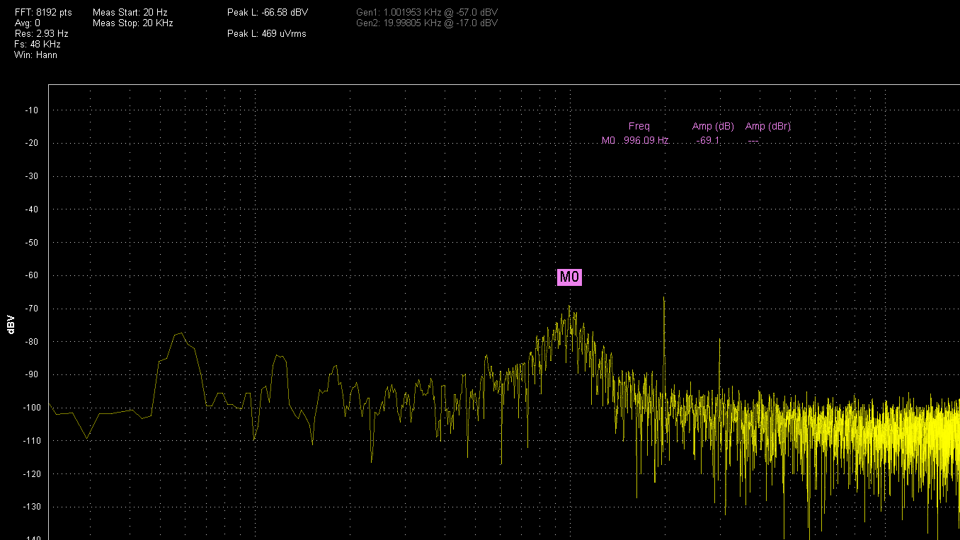

Wrong test point
It seem I was measuring off the wrong test point TP8 and TP9.
These test point are post distortion amp levels.
Here is 1Vrms input and 3Vrms input straight off the notch filter output.
These level are at +10dBV scale.
The notch filter has added to the second and third harmonic level.
This is not bad but still not as good as Dick Moore's Twin T.

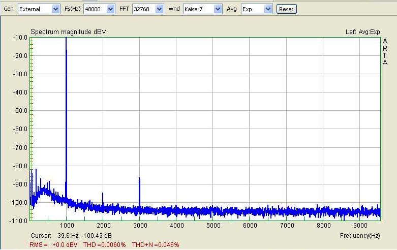

Two 339A monitor out spectra
These are taken from the monitor output; this 339 has not been cal'd in some time -- more than a year. Even so, at last cal I used two oscillators to verify the accuracy of the output levels for distortion readings down to -90dB, and I have no reason to think they are in any way inaccurate.
The input is from the 339 osc. at 1kHz, at 1VRMS, with a high-Z load of the analyzer only (not into 600 ohms), which means that the monitor output's 0dBV level of 1VRMS full-scale is referenced to 1VRMS at the 339 analyzer input (in analyzer mode, the THD read about 0.0013% with all filters in, but the actual THD of the osc. is more than 20dB lower).
The first plot is the full-scale signal at 0dBV, even though I've raised the plot 10dB to show the floor -- note the 0.0dB RMS reading in red. The 400Hz HP filter is in, the two LP filters are out -- they are noisy and have distortion even though they do clean up the meter readings. Note the 2nd H at about -94dB, and the 3rd H at about -86dB (I'll go back and turn the 400Hz HP off, too, and see if that changes anything -- I've just always left that in).
The second plot is the monitor distortion output with the distortion range set to the max sensitivity of -80dB, so the plot's 0dBV level is actually -80dB. The notched fundamental is about -35dB = -115dB. The 2nd H is about -100dB, and the 3rd H is about -111dB. I don't know where the high Hs are coming from -- I really don't want to tear the 339 open just now, as I'm bring a Fluke 343A DC voltage standard back to life. Davada may figure it out for us....
