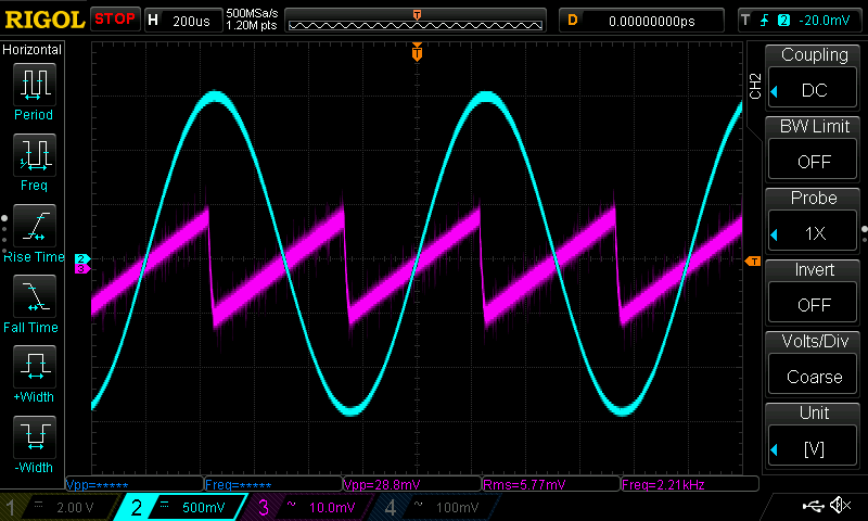

Starting with the idea presented here:
Low-distortion Audio-range Oscillator
I've now built a prototype of a two-phase peak detector using a half of the LM339 comparator, and a TL072 as the inverter. The original idea was presented here:
The waveform at the output of the detector is shown in the first attachment. It is a saw wave with a frequency twice the sine wave fed to the detector, and a peak-to-peak voltage of 29mVpp. The inverter gain had to be trimmed in order to produce a clear second phase - I used 1% resistors initially, but that wasn't good enough. According to the simulation, 0.1% resistors should be satisfactory.

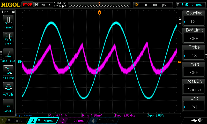

Passing the above saw wave through an 1k/0.47uF LP filter produces the waveform shown in the second attachment. The signal is now reduced by a factor of more than five, but still contains higher harmonics.
The DC part of the signal is -1.49V for the 3Vpp sine
In a next step, I intend to pass this signal through a switched-capacitor filter, which can further attenuate the 2nd by 30dB. The part I have in mind (LTC1062) has a step response of about 2ms (1V step), so a fast reaction of the entire peak detector chain is guaranteed.
I don't have the filter now, but I expect a delivery from Mouser by thursday, and will then present further results.
