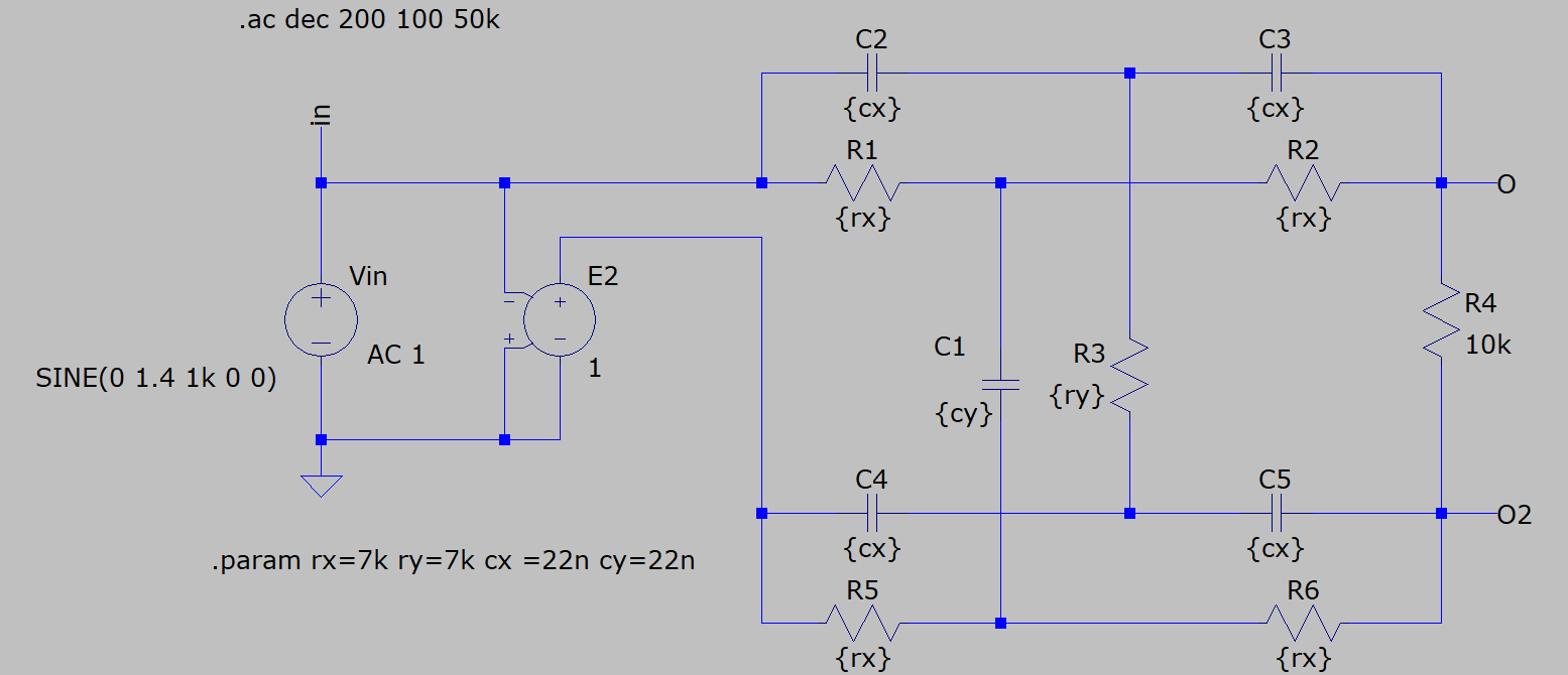

Converting the twin-tee for bal is much better (and easier and cheaper) than using two single ended ones.
All Rs and Cs now have equal values ;-)

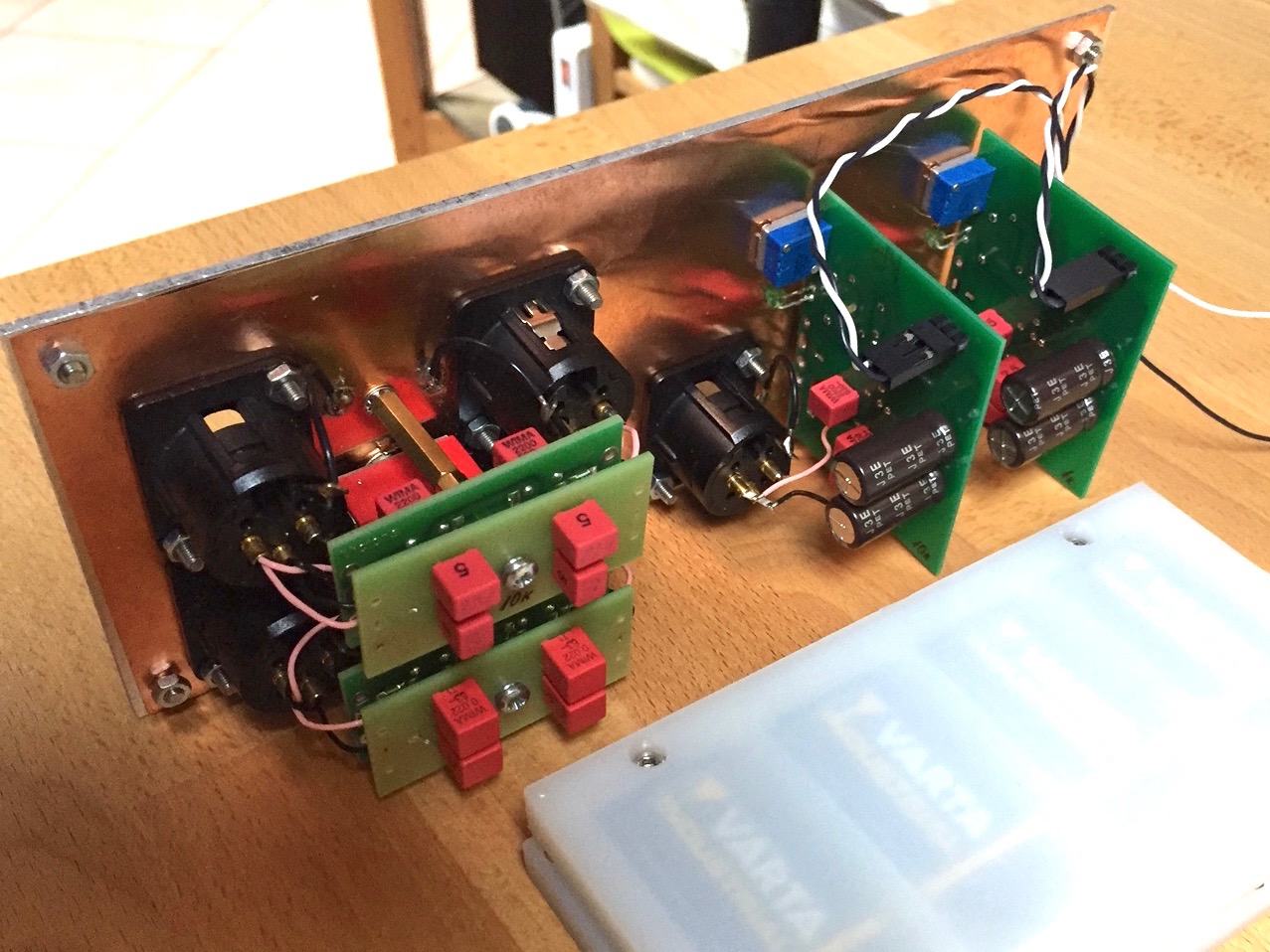

I am currently building an active Twin-T with a sharp and deep notch, so the attenuation at the 2nd will be minimal (0.1dB or something). To be able to keep the notch spot-on, I add a 5-bit relay switched threefold trim resistor (registered trademark 🙄). This will allow me to shift the notch by about 1.5Hz for 1kHz center frequency, with just a single rotary encoder. Hope this works...
I'm in the process of making a new case that contains both the two oscillators (1k and 10k) and the notch filters.
That is a great idea! Are you making that for sale or just for your own use?
