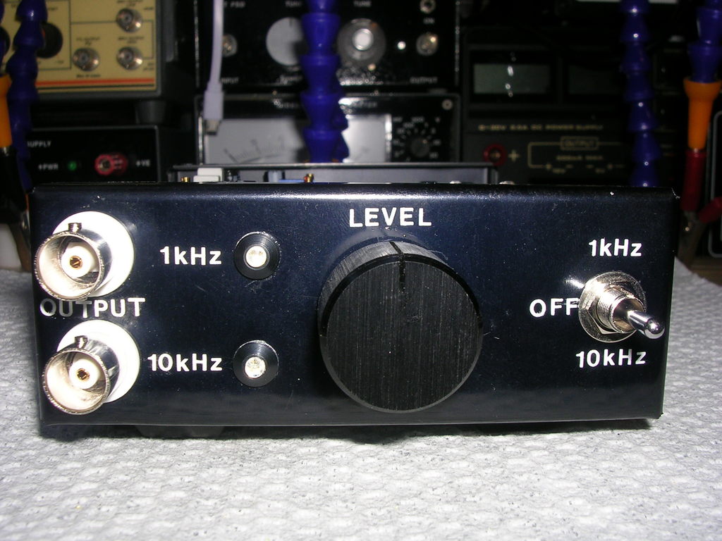

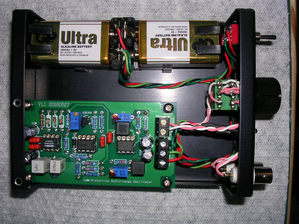

I got a couple of the ebay low distortion 1kHz oscillators mentioned earlier in this thread and pimped them up a little. I replaced the NE5532s with LME49720s, the TL072 with an OPA134, the frequency determining caps C1 & C2 with 1% polypropylenes, and the integrator caps C3 & C4 with polyphenylene sulphides. I tried varying the output level with a pot on the -ve supply to the current reference resistor R12 but this was only partially successful - the oscillations stopped when the output level was reduced by much more than about half. Instead I increased the output resistor R14 from 100R to 1k and connected this to a 1k pot for varying the output level. Normally I would have followed this with a buffer amp to provide constant (low) output impedance but I didn't have enough space in the enclosure that I was using. In any event this method works fine for my purposes. I discovered that the oscillator provides a low distortion 10kHz sinewave by the simple expedient of changing C1 & C2 from 47n to 4.7n. So I made a 1kHz plus a 10kHz oscillator and put them in a small aluminium enclosure along with batteries, leds, a potentiometer, a switch, and connectors. The power switch is centre off whilst the other positions power one or other of the oscillator boards. One or other of the leds light up to indicate which board is powered. Photos below.

Nice work. Have you been able to test its distortion? It should be pretty good. Probably a little tweaking around the FET to optimize it for "ultimate" performance. As I remember those are pretty cheap to start with. Through hole makes them even easier to tweak.
The distortion is more than 100dB down at both 1kHz and 10kHz. I'll need a better spectrum analyser to characterise it better than that. Unfortunately I didn't measure the distortion of the original so I don't know how much the tweaks improved things. Not by a huge amount I suspect. As you say some tweaking around the fet will probably improve things even further. Given that its a state variable oscillator I might also try a simple multiphase rectifier to reduce the ripple at the fet gate. Another idea I've toyed with is designing an oscillator with a four op-amp state variable loop - carefully done that should reduce the distortion to immeasurability - anyone tried it? I'm about halfway through building a variable frequency version of the oscillator using a 2 pole 24-way switch to provide a close packed range of switched frequencies, rather than continuously variable frequency with a double ganged pot and all the problems that entails.
These modules cost about £10 A&T, or £3-4 as a bare pcb, from ebay UK. I think that's pretty good value given their excellent performance and tweakability. The pcbs are pretty robust too; I desoldered and resoldered one of the resistors four times with no sign of damage to the pads, plating through, or the pcb itself.

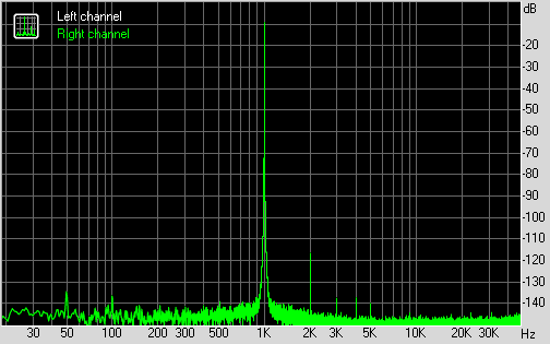

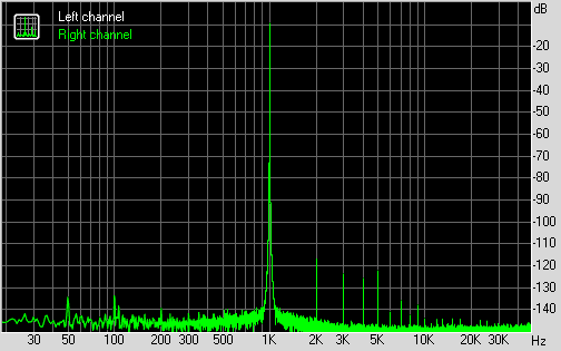

Yes, I measured the distortion in the as-is state, but also after having replaced the 5532's with 4562, and TL072 with 134A.
I used the RMAA software at the time and wasn't happy with its flexibility and the lack of control over what I do with it. But FWIW, I'm enclosing the three spectra - at least they show the reduction of the harmonics after the two changes I made.

thanks.
This is going to be my second test with the RTX6001 (after loopback).
Hopefully it is going to be easy to set up to see the existing performance of my low distortion oscillator.
Then I will look at my two LNA, +60dB Wurcer and +80dB Frex.
If I can get loopback, osc and LNA all giving sensible results, I might be ready to look at amplifier performance.
