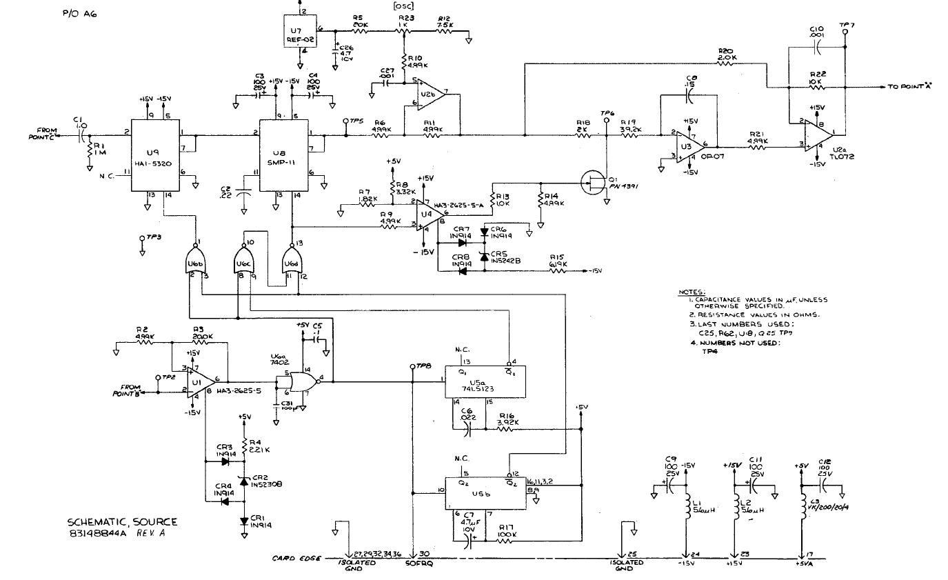

For info, recent project write-up by Tom McKay and Rod Elliott (Project 174 - Ultra-Low Distortion Sinewave Oscillator) implementing a sample and hold agc with Linsley Hood's two-stage Wien oscillator.
Project 174
I recently breadboarded the sample & hold described in this project with a view to replacing the full wave detector in an oscillator I built a while back.
The existing detector has a small amount of ripple that contributes to the harmonic distortion. Attempts to increase the time constant makes the settling time too long and can result in squegging.
The oscillator in the original project write up only operates up to 10kHz. My oscillator covers 15Hz->150kHz in 4 switched ranges.
My tests show that the S&H works up to about 28kHz.
Above that, the sampling pulses stop.
For operation at higher frequencies, C9 and C10 need to be reduced to give narrower sampling pulses.
However, this stops it working correctly at lower frequencies.
The only answer I could come up with is to switch C9 and C10 according to the frequency range.
I tried using a 4066 analogue switch to do this.
It meant reducing the +/- 12V supplies on the S&H down to +/-9v.
I was also concerned about the spikes on the input to pin 6 of the comparator.
These exceed Vcc which could damage a 4066. It needs an added protection diode between pin 6 and Vcc.
I found that using values of 1nF for C9 and 56pF for C10, the S&H can be made to operate up to about 100kHz.
Above that, the delay in the sampling pulses relative to the peak of the sinewave cause the the AGC control output to drop.
Replacing the LED 'D3' with three diodes in series helps by widening the clipped top of the sinewave. However, this reduces the AGC output voltage somewhat.
Another problem with the S&H is the unwanted offset in the AGC control output due to the FET biasing resistor R15. This is easily corrected by replacing the FET with a voltage follower using the unused half of the second TL072.
I think that's pretty impressive for a circuit with simple parts.
You can switch to a simple AGC at higher frequencies where the settling time is not an issue (Optimation did that).
Or the S/H circuit for the Boonton 1120 works to 140 KHz. One part has been discontinued from that design but ADI has newer parts that should work Sample/Track and Hold Amplifiers | Analog Devices .
The manual for the current instrument is here with details on the circuit and parts lists etc.: http://www.boonton.com/~/media/Boonton/Manuals and Software/1121A Instruction Manual.ashx
