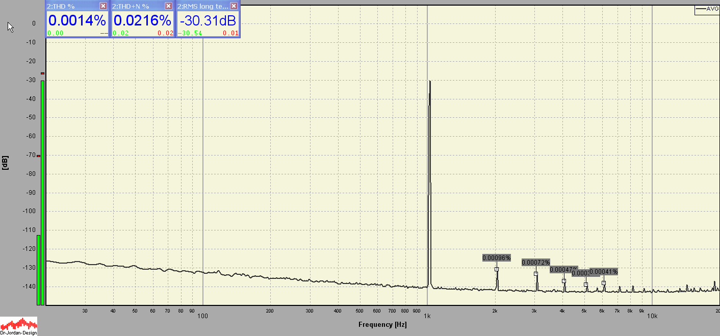

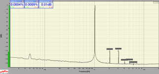

This is the 239A clone working at 20 Vpp out into 10 kohm - measured THD is almost only the THD of the EMU 0204 itself. A plot of the FET operating Vds (~88 mVpp) is attached too.
Ciao,
L.

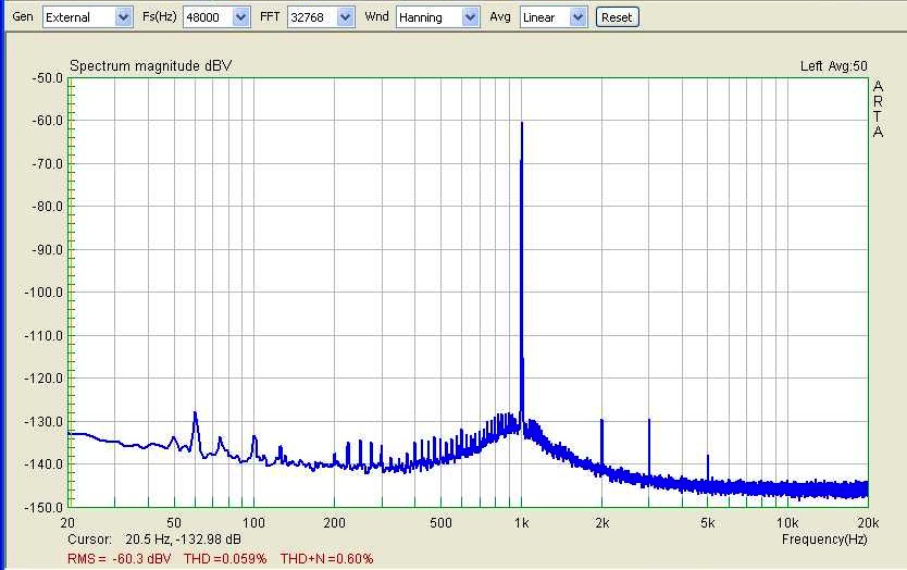

My 339A/239A clone uses an LT1468 for the main amp -- works quite well, considering it has a 10:1 cap ratio instead of HP's 100:1 ratio. I call this version the IG-339B -- it's built into a Heath IG-18 chassis and uses the Heath tuning resistor switches. The Heath mylar caps however have been changed to polypropylenes.
The fundamental is 1kHz at 6.3VRMS, level-adjusted by a 10k pot to 1VRMS and fed into my Active Twin-T filter to reduce the fundamental by 60dB without attenuating harmonics at all. The ADC is an E-MU 0204.
