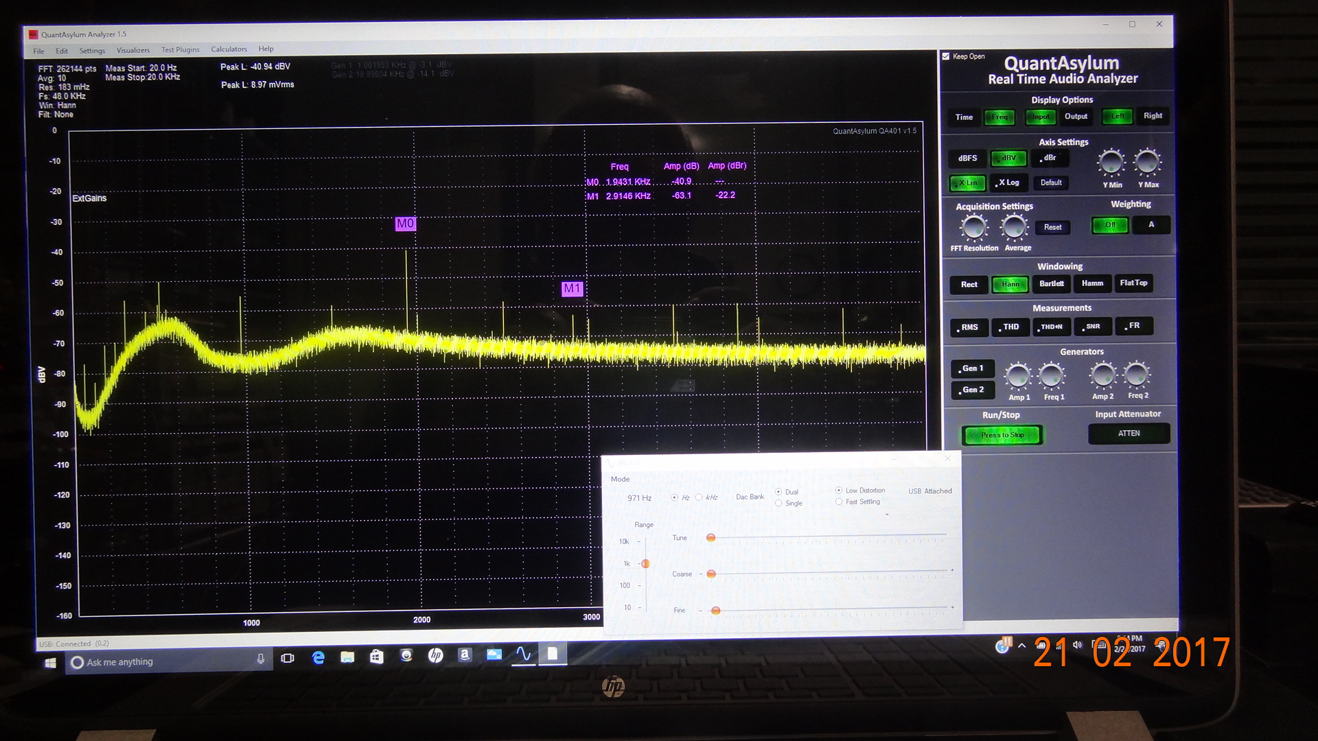

I adjusted David's Generator unit for more 2H and less 3H.... can be equal or less 2H and more 3H thd ..... So now the distortion harmonic level falls between -140 and -160dB. If adjusted for equal 2 and 3H level, both would be at approx -150dBv.
[This includes the analyzer non-linearity at these low levels. The Gen distortion harmonics are thus below -150.]

I dont use the meter gain scale for -110. I force select the scale to be -100dB.
David is correct... the -110 fs has no affect on monitor output, only meter. Lowest scale for monitor out is -100dB.
The monitor out goes into FFT QA401.

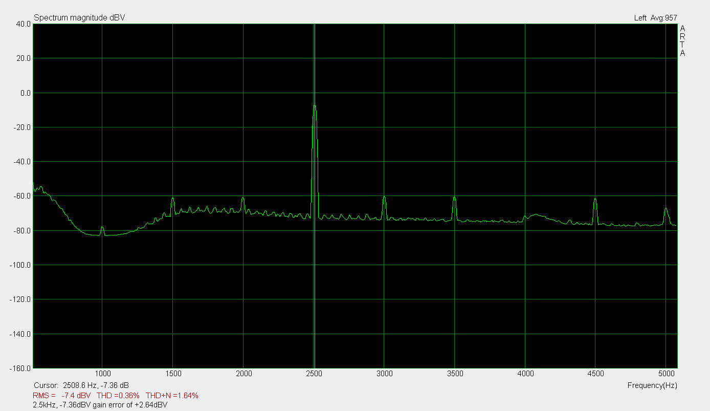

I've done some tests with Shibasoku 725D to demonstrate the accuracy of the scaling in level and distortion mode.

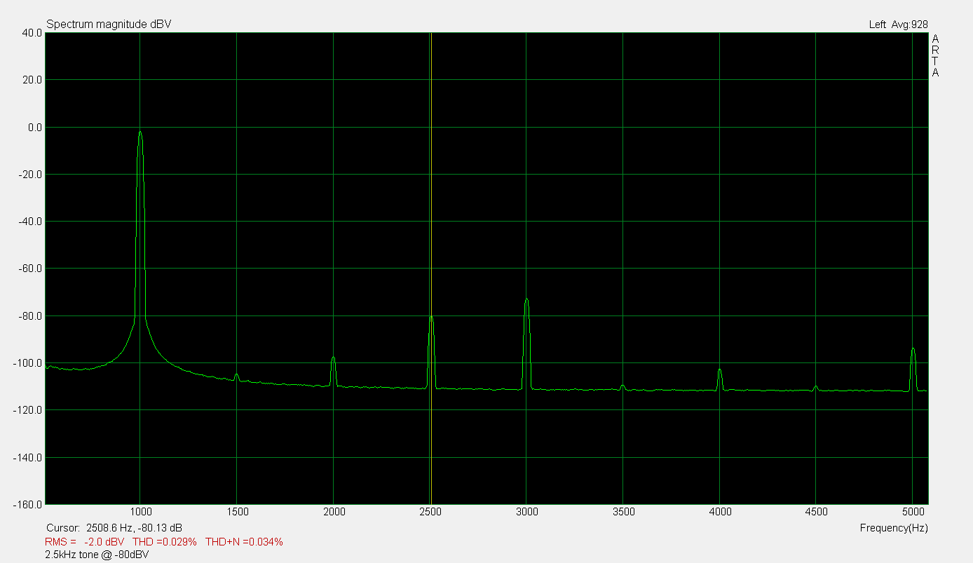

I've mixed a test tone at 2.5kHz with the oscillator. The oscillator level is 2.5Vrms. The test tone level is set to -80dBV. The level is taken in the 3Vrms (+10dBV) range on the 725D. The 725D meter is scaled such that at 3dBV FS of the meter the monitor output is 1Vrms (0dBV). 2.5Vrms then is exactly -2dB down from the meter FS and this is reflected correctly in ARTA. The RMS value of ARTA is -2.0dBV. The cursor in ARTA shows the level of the 2.5kHz test tone.
The test tone is generated from an HP625A and is mixed with the output of the SVO oscillator. This shown in the first pic.
The 725D is switched from level mode to distortion mode. I've set the range of the 725D to 70dB so not to clip the input of the EMU0204. 70dB FS corresponds to 0dBV on the monitor output. In the 70dB range we expect the -80dBV test tone to read -10dBV on ARTA. The actual measurement is 7.36dBV. In the distortion mode there is a gain error of +2.64dBV. This is not in our favor.
This demonstrates the system scaling is correct from level mode to distortion mode and validates the 725D meter FS is 0dBV at the monitor output. The monitor output is scaled to the meter's FS in any ranges.

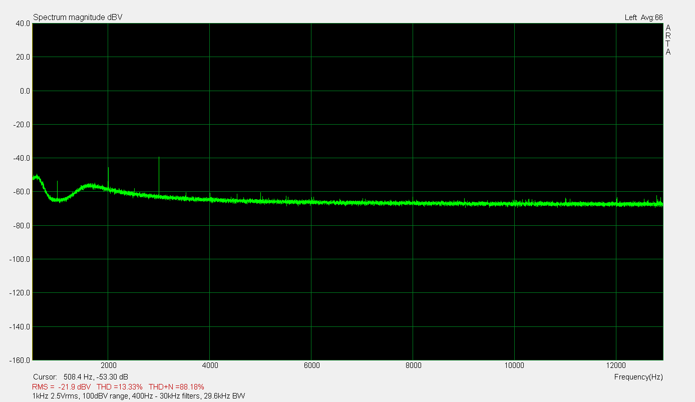

The first pic is level mode. The second pic is distortion mode and third pic is the distortion of the SVO at 2.5Vrms. I've set ARTA to plot linear scaling for clarity.
There is a difference between the residuals of this 725D in contrast to Richards 725D.
You can see the 2nd and 3rd harmonic are flipped. This is a s low as these two 725D can measure.
For the test tone tests the 725D filter are turned off.
In the distortion measurement the 30kHz and 400Hz filters are in. The input level is 2.5Vrms @ 1kHz. measured in the 100dB range. 0dBV on ARTA is -100dBV. The BW is 29.6kHz. FFT is 44.1kHz with 131072 points. 100k cycles of linear averaging.

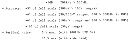

For GP panel meters maybe. But that would be really bad! I believe the spec for instrument is not of FS but of Reading. And it is to be within +/- 1dB for harmonic measurements. anyway ---
I just placed an accurate ac voltmeter to a variable output generator and set for 1v fs on 725D and then changed output level to 1/10 v on same scale. The 725D meter reading was less than one tick mark low of .1v on the volt scale. Or about 1/2db
THx-Richard
Well you can get lucky but you can't bet the farm on it. Did you check the spec in the manual? I have never seen it different than % of FS. Even the relatively expensive d'Arsonval movements themselves are often no better than 1.5% FSD.
Look in the left hand side of the meter: it says class 1.5 - 1.5% FSD accuracy. That's just the meter movement itself.
And it seems to me that one tick mark off at 0.1V is 10%.
Jan
using ShibaSoku 725D -
THD+N
Meter on -100dBv FS range:
and why meter reading cannot be used to measure the THD ... need to go to monitor output.
Meter on -110dBv = FS; is well below the scale reading of -130dBv
THx-RNMarsh

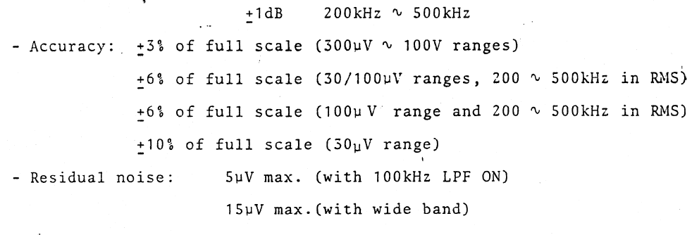

This why Shibasoku specifies 30% to 100% FS. We run out of dB. So have to calculate in % of FS. But what can we do? We have to take a reading.
I calculated the sum of the first 10 harmonics all at -150dBV. Came to -140dBV THD.
This is from the 725D operation manual.
This doesn't mean the meter is not accurate below specification. Shibasoku can't guarantee accuracy at these levels below the stated percent FS.
It means we have to do our due diligence to proved the measurement accuracy at these levels each and every measurement.

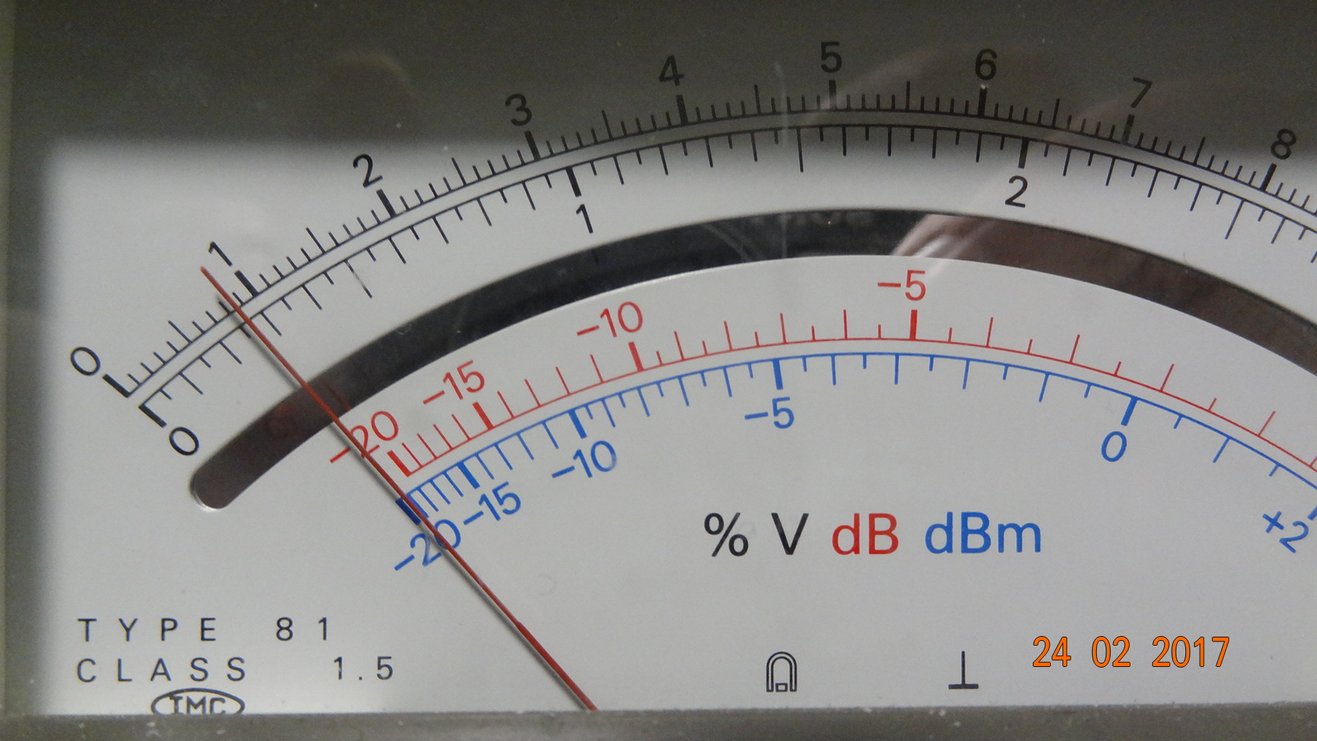

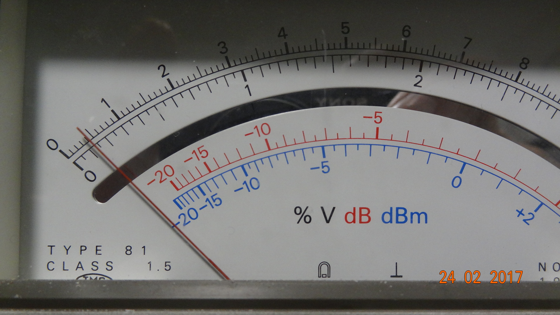

BTW One more comment to the reading of d'Arsonval movements: the better ones, like those on the Shibasoku, have mirror scales. That means that the best accuracy is obtained when you read the meter such that the mirror image of the needle falls just behind the needle itself. In that case you are exactly perpendicular to the needle and the scale resulting in max accurate reading.
If you look at the pictures of the meters posted above you will see that the needle mirror image lies to the right of the needle itself and that therefor the apparent reading is too low. If you disregard that, it may easily give another 5 or 10% error at low readings.
