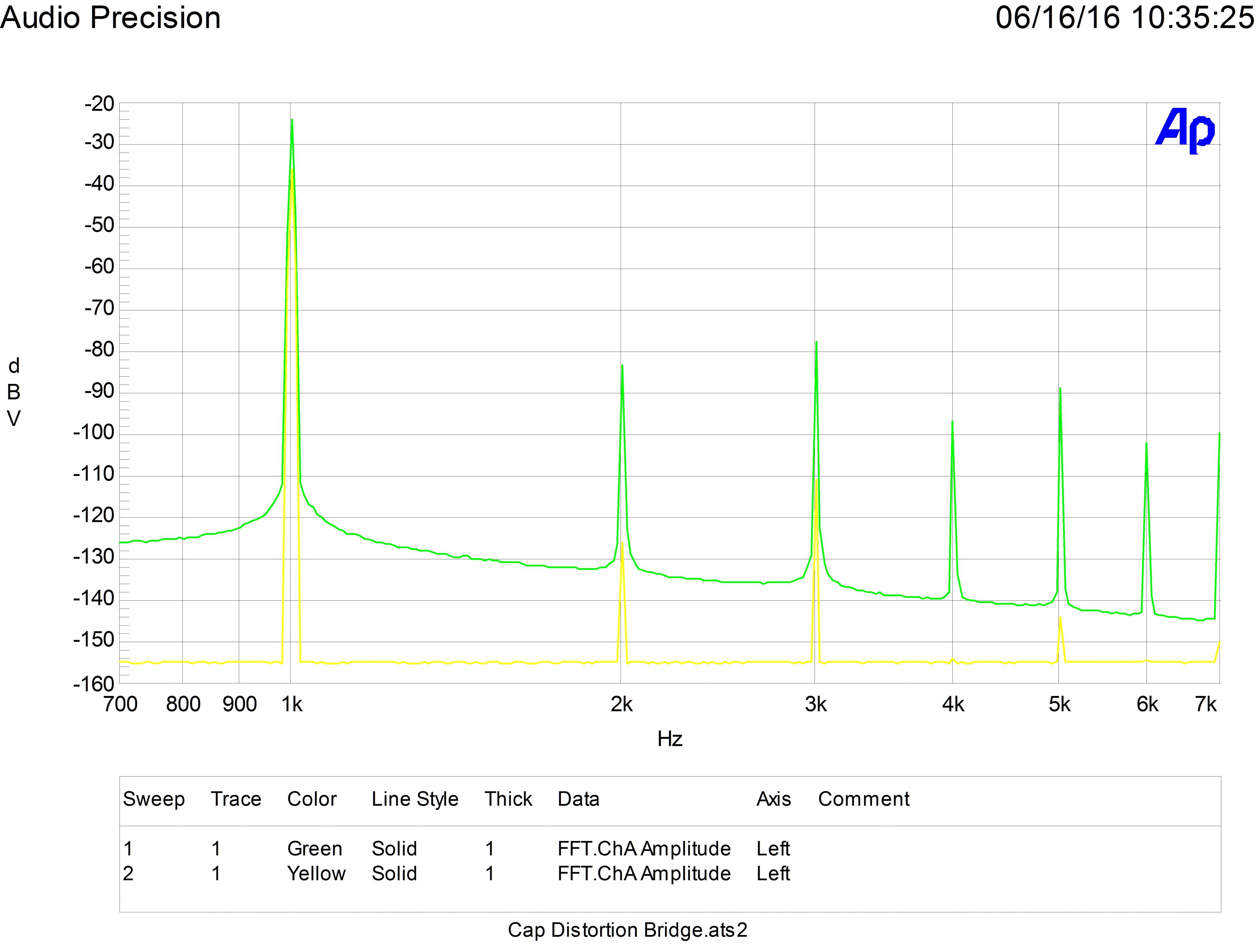

The last comparison was made by replacing all three Wien bridge capacitors (two of them in parallel) in my 1kHz oscillator board - I have one old semi-experimental board for these purposes. Oscillator output ~2,7V RMS.

Yes, but this test is not so easy and quick. Needs to match capacitors, and needs to check, that the AGC works in the same proper condition...
, but I have the new fresh results.
As a joke, chinese polyester 0.01uF 100V:
http://content6-foto.inbox.lv/albums/e/elterra/COGvsFKP2/chpolyester10n.jpg
and..., I do not believe my eyes, The Winner is -Xicon polystyrene 0.01uF 50V:
http://content6-foto.inbox.lv/albums/e/elterra/COGvsFKP2/Xicon10n.jpg
Polystyrene is a very good dielectric, so I guess I'm not surprised. I am always worried about my soldering technique when using polystrene caps though.
Polystyrene capacitors are my first choice unless the area is hot. These days it's hard to get the values you want at the voltages you need. I used to use Siemens, and they were excellent. Matching the Xicon caps means buying many and / or padding the capacitors.
The next best thing is Polypropylene, and you have to measure the DA on those. They are definitely not all equal! Teflon is of course the cap of choice if you can afford them. That's why I didn't include them in my list. Can't afford them.

Polystyrene caps are very good for this. They became hard to get for two reasons- heat, they don't lend themselves to surface mount, and moisture sensitivity, you can't wash them with the rest of the board. They are really a hand operation. 2% PS caps should not be difficult to get. Relcap Reliable Capacitors still makes them for a price and the Xicons are fine. That factory has been making them for many years.
The PS caps are always film and foil. Same for most Teflon caps. Teflon is a pain, you need two or three layers because of the pinholes and then the foil. The yield is not great.
Both Teflon and PS have very good temperature stability. Same for COG(NPO). Everything else goes downhill. To be really obsessive you match the residual tempcos between the caps and the resistors. You can get remarkable stability with care.
