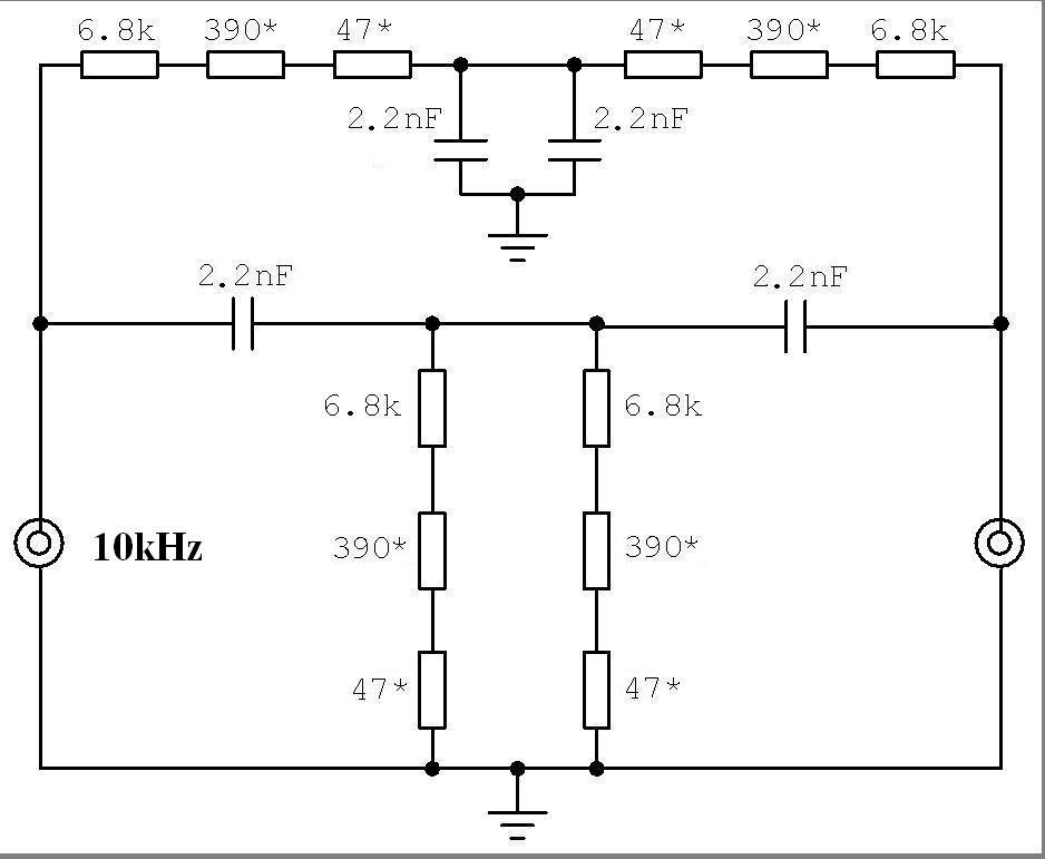

I think step 1 is to lower the operating level. 6V RMS is too high. It should be around 3V max. The tuning caps could also be a limitation but other aspects first.

I fouund the schematic which doesn't show well on screen. However I see seveal options for improvements:
1) The Reference for the output voltage comes from the negative supply. That should be revised and maybe made adjustable. A 25K pot from - rail to ground with the 2.2 MOhm resistor to the wiper might work
2) A series resistor on the FET to reduce its control to just a little more than necessary to stabilize the output will alo redice any distortion from it.
Its a pretty textbook example of a state variable oscillator it seems. Even with rework, making it with through hole parts makes it a candidate for tweaking.
I'm not confident that it will get to the level of Victors oscillators. It will be interesting to play with.

Yes, we can see relative changes, but sometimes we can go to the wrong conclusions. Sometimes harmonics from different parts of the system play with each other, especially the second harmonic.
In my own way, first step, when I use unknown ADC, is reducing the input signal from the reliable sine source for the ADC to the point, when harmonics become invisible. Also needs to check, if no artifacts at lower levels. If all is ok, then this would be the max input (0dB) for this ADC. Next step is to use twin T notch and the buffer amplifier at the ADC input. The quality of the twin T filter parts, is very the important thing. Only metal film resistors and perfect polypropylene or polystyrene capacitors (or maybe rare other types) can be used. I can recommend Wima FKP2 or polystyrenes from LCR.
Regards.
I agree completely -
The numbers below about 100-110 are all worthless data with sound card type instruments. The phase changes of very small amount will give completely different harmonic data. I agree, it may look like you are making relative data changes only but that is not true. Only careful testing (VERY careful) need to be made for accurate harmonic data beginning at about -100dB re 1 v.

We all need a twin tee board from some enterprising person. There are oscillator options but the critical test part is elusive. I'm too busy working to have much time but maybe someone else (or one of the really enterprising China guys) is up for this. Even if I need to load the tuning components and tweak it it would save a lot of time. Maybe matching simple software that can do the corrections and calculate the various distortion numbers. At these levels were not testing too many amplifiers. Very few are anywhere near this good. But you can always integrate it with a load resistor.
Demian,
If you (or someone else) have a schematics in mind and need a PCB, I am happy to help.
Patrick
Demian,
Patrick
Samuel Groner offered his twin T design to the interested in this thread a while ago. I got the Gerbers and the design note from him, and here is my - not yet finished - example.We all need a twin tee board from some enterprising person. There are oscillator options but the critical test part is elusive. I'm too busy working to have much time but maybe someone else (or one of the really enterprising China guys) is up for this. Even if I need to load the tuning components and tweak it it would save a lot of time. Maybe matching simple software that can do the corrections and calculate the various distortion numbers. At these levels were not testing too many amplifiers. Very few are anywhere near this good. But you can always integrate it with a load resistor.
