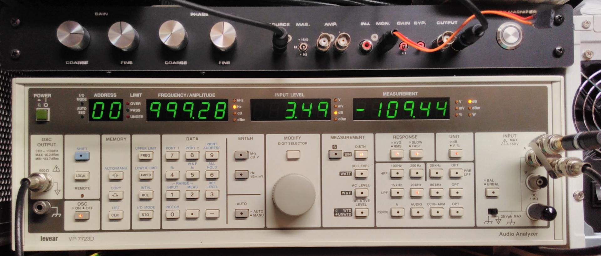

BTW -- The Panasonic and Levear and maybe National, all share a common design concept in implementation; similar to the ShibaSoku 725 models.
The Panasonic etal are made by Matsushita Communications Industries Co. Ltd. Maybe they did the design as well as building them.
THx-RNMarsh
THx-RNMarsh
Wouldn't be the first time they OEM'd product for others in the market.
David, would you have a model number for me to chase? I've not seen one.
Hi Richard,
Pretty darned respectable, and it's automatic.
Hi Richard,
