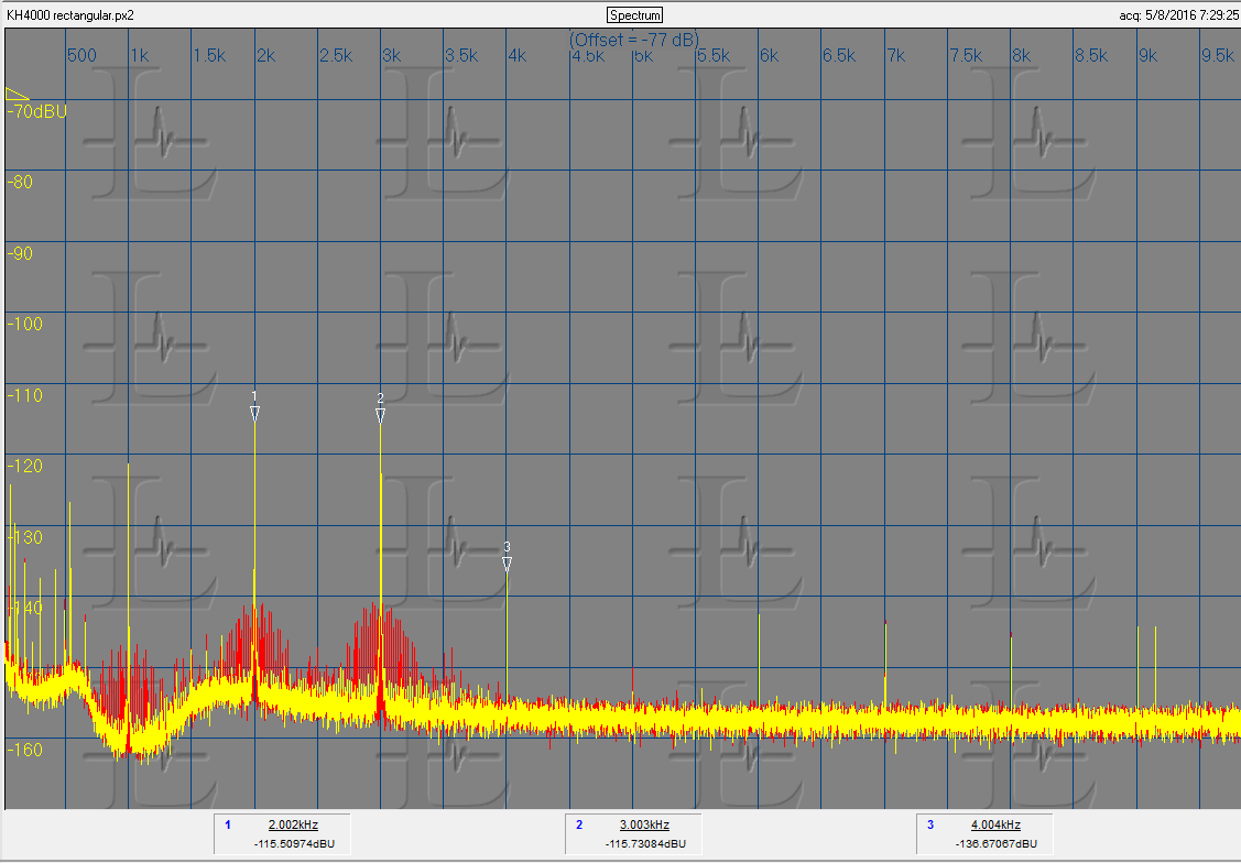

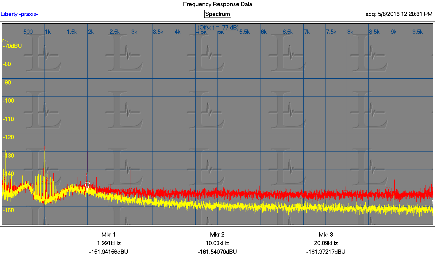

Better comparison between Victor w/ fresh batteries and the ULD4. Red is the ULD4 and Yellow is the Victor oscillator. I have some annoying common mode power stuff I need to sort out between the various boxes. Even adding a ground from the Victor (running on batteries) to the different ground options on the 725 adds a lot of junk. On the ULD4 there is some crosstalk from the 10 KHz and the 20 KHz even when they are all the way down. All the oscillators are always running. Andreas will be looking into this. But my 725 has some issues as well. I still need to implement more of Davida's revisions.
The ULD is running from a small wall wart and its internal DC-DC converter. The isolation is very high and noise from the converter is quite low. I will need to learn more about it.

Did Victors go lower in thd in later versions? Mine doesnt do as well as Demian's.
Is scaling correct? I measure same for 2H but 3H is much lower on yours'.

My Victor oscillator is first Gen. The current ones are better. The linearity of the load is critical with a 600 Ohm source.

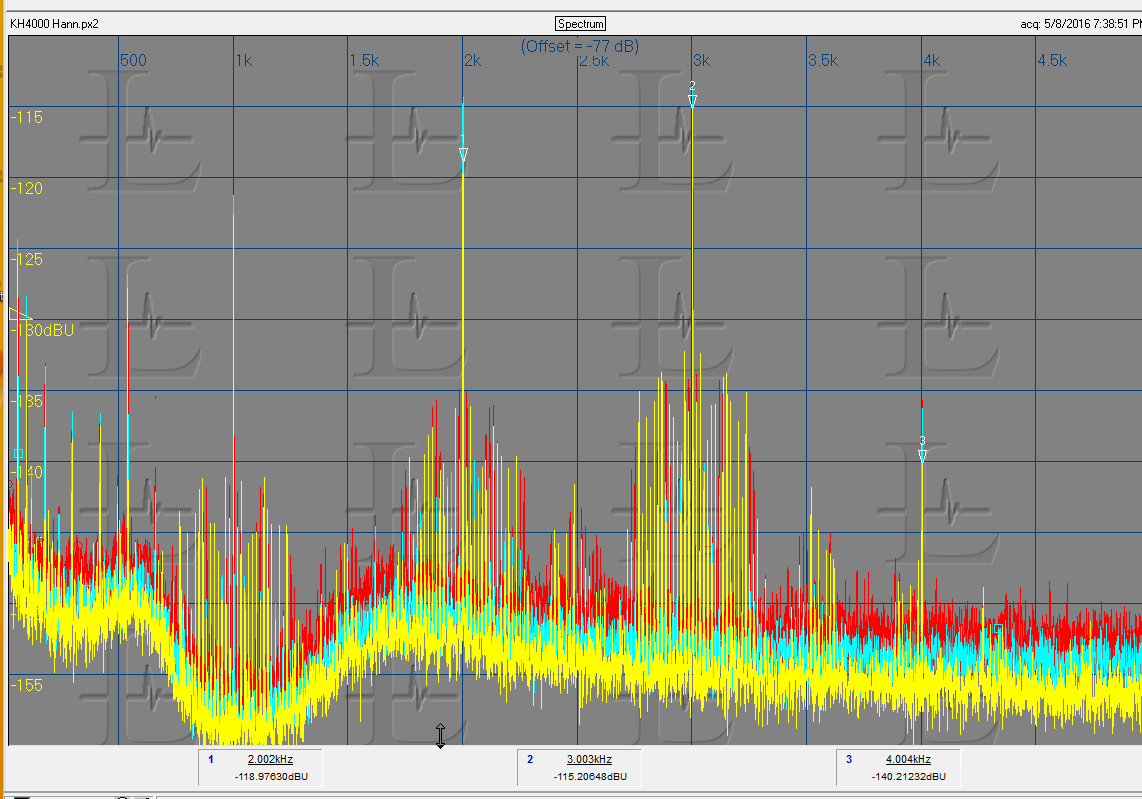

One thing I noticed is the window was in hann on QA. You prefer flat top. Mine jumped a few dB switching to flat top.

Finding a suitable window function is more complex depending on what you are looking for. Flat top is good for measuring amplitudes of discrete spectral lines but will have sideband artifacts and is not good for looking at what is hiding in the noise. The Hodie7 window I used for the plots above does a good job of unearthing stuff in the noise but may not have the most accurate level on the peaks if they are not perfectly in a bin.
Below are some overlaid spectra. they are all the same source with different windowing. And different results. Praxis has 9 window options. I don't know enough how to select with confidence. The first plot is a rectangular window over a Bingham window. The Bingham window has the sidebands that the rectangular window doesn't in this measurement. The second is three overlaid and you can see the different levels of the peaks.
With analog sources and high resolution plots its essentially impossible to get the signals perfectly in a bin. How the window handles the beginning and end of the measurement influences the sidebands and the low level stuff.
