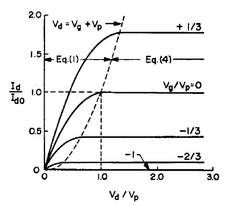

Bob's oscillator and JFET operation
I have some questions about the leveler loop in Bob's oscillator and it's made me think of some other issues too.
Bob's oscillator integrates the loop level to smooth it and then compares this with a reference level.
Mathematically it should be equivalent to compare with the loop level with the reference level and then integrate the error to smooth it.
This would have the benefit that the capacitors should be very close to zero potential, easier to switch without leveler disturbance.
On Bob's oscillator this only saves a few resistors, maybe more important on a sweep tuned oscillator.
It seems that it would be easier to set the leveler loop, check for problems, any potential is an immediate clue.
Does that seem reasonable?
The related idea is to trim the oscillator feedback so that the JFET has essentially zero Gate-Source potential at nominal operation point.
That runs the risk of a small forward bias on the Gate.
At very low level there will be minimal forward conduction but I can find little information on use of a JFET in enhancement mode.
Any one have a link or experience?
One possibility is to use an actual depletion/enhancement mode MOSFET instead.
But I can't find one with a turn off threshold to equal the best JFETs.
Any recommendations?
David
Here's a picture from Middlebrook circa 1963 showing that slight enhancement was always considered OK. In my experience 100-200mV does not cause any forward conduction except at extreme temperatures.
Toshiba 2SK192A datasheet shows gate bias to +0.6v
That would be pushing things to the edge at hot temperatures, that's an RF device for use at 50 Ohmish resistances. The gate to source junction typically acts like an ordinary forward biased junction not much different than a bipolar transistor at 650 -700 mV it's full on conducting at room temperature.

Here's a picture from Middlebrook circa 1963...
Thanks to you both. I hadn't seen either of these before.
Looks like I am OK to at least 100 mV and that's all I plan to use.
Best wishes
David
