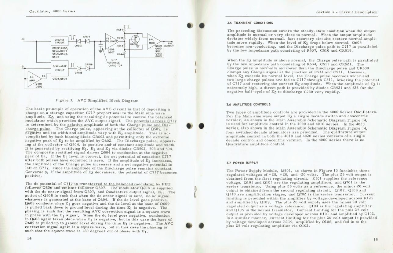

The KH4000 family of oscillators settle to the target level in less than one cycle even at 1 Hz. And still have very low distortion. If I can find the schematics I'll post them. Its an old design and all discrete so pretty involved but is not using a sample and hold.

Any luck? I checked the Krohn Hite site and the manuals there have the circuit description removed.

I was referring to the KH4000 and KH4024. I do have the manual here somewhere. The 4100 has similar performance. The 4200 is a different product with a different operating range.
As I remember (its been many years since i read the description) they use a technoique of injecting a charge to boost or cut the level. No FET or analog multiplier. All the details beyond that are in the elusive manuals. They do have good circuit descriptions.

Sounds like they are resetting the initial conditions of the oscillator (i.e. the voltage across the/charge of the capacitors) once per cycle. One of the few relevant reference I know is: RC OSCILLATOR WITH EXTREMELY LOW HARMONIC DISTORTION | Vannai | Periodica Polytechnica Electrical Engineering.As I remember (its been many years since i read the description) they use a technoique of injecting a charge to boost or cut the level. No FET or analog multiplier. All the details beyond that are in the elusive manuals. They do have good circuit descriptions.

I must admit I was surprised not to see any obvious FET or multiplier in the 4200 circuit.
I didn't look too closely at the circuit because I had noticed the 4200 was different and I wasn't sure how relevant it was.
But your brief description sounds similar, now I am even more curious to see the manual.

I found the manual. I scanned the circuit description and I'll make a complete scan in a few days. Unfortunately its an old document and a decent scan becomes a big file, too big for DIYAudio. I'll try to figure out a workaround..
Let me know if the attached image is readable. send me a PM and I'll send the complete scan when i have it done, hopefully by the weekend.

Demian, it's rather soft focus but readable.

Thank you, even better is to take Jan's offer and post it there so everyone can read it and we can share.
As already commented, it's soft focus but readable.

Jan has now posted it here: Measurement Means and Methods | Linear Audio NL
Its operation is not straightforward so some study would needed to understand that part of the circuit. I believe the distortion limits of that design are feedthrough from the agc pulses but I have not had one for many years so that all just fuzzy memory.

The presenting issue was transient settling time not distortion. The 4400 settles much slower and would be of little use at or below 1 Hz. The 4000 can go much lower and would need a faster agc.
