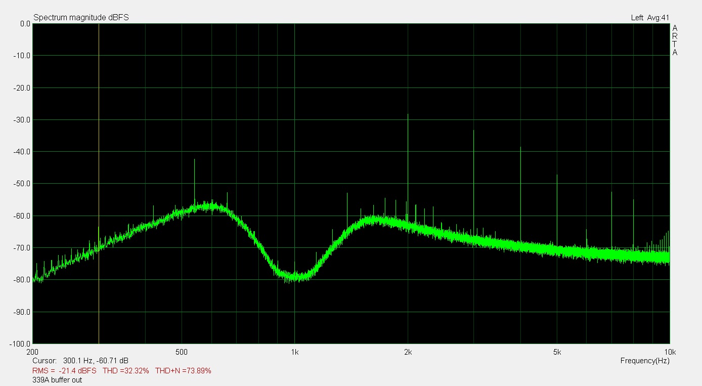

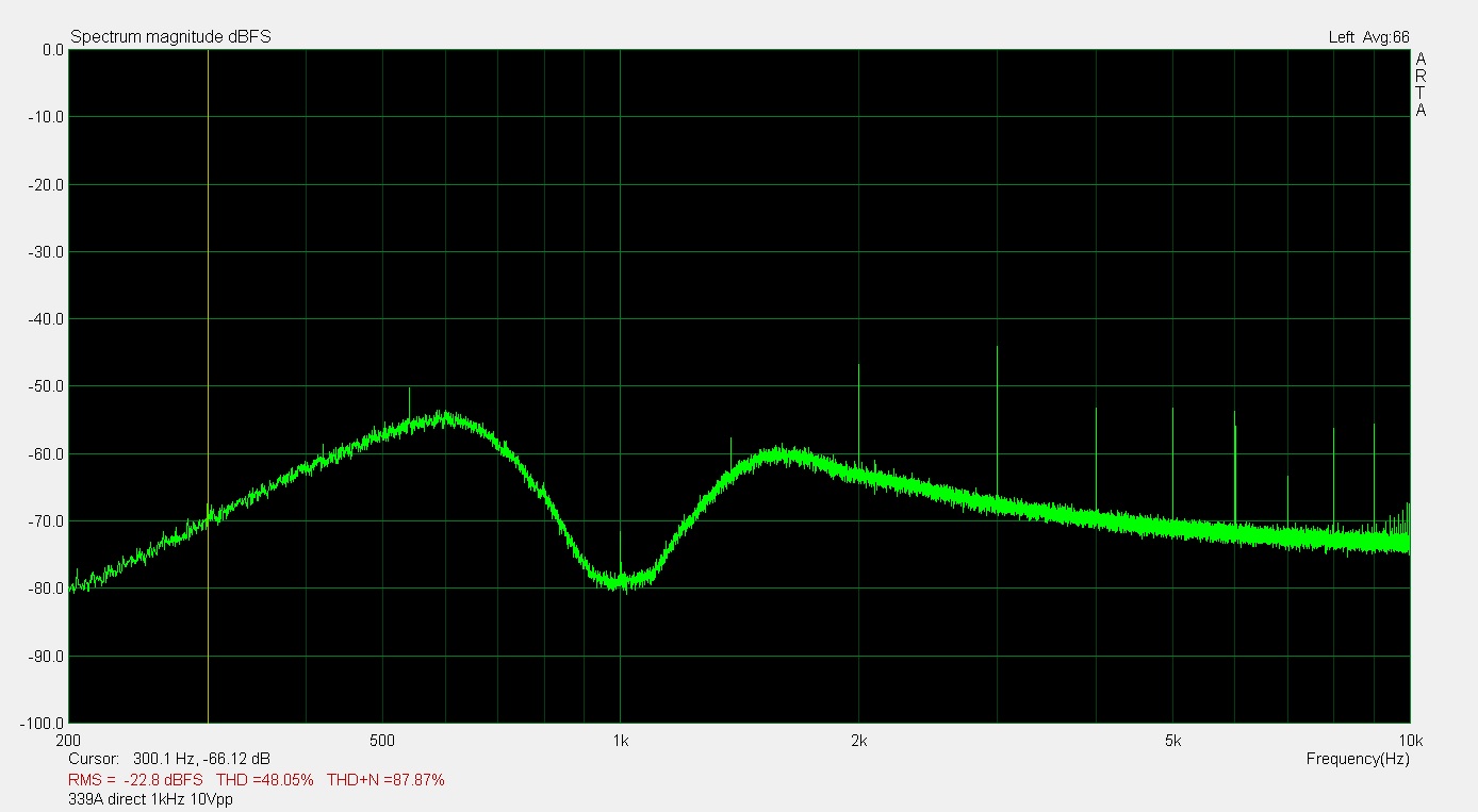

Digital multiplier
I've taken the digitally controlled multiplier from my state variable generator design and placed on it own board. I intended some time ago to try the multiplier on other oscillator types like the Bridged T and Wien Bridge types.
I installed the multiplier in s 339A oscillator replacing the Jfet. The multiplier runs off the original controller of the 339A. below is some spectrum of the results.
The first pic is a measurement on a Shibasoku 725D off the oscillator op amp bypassing the buffer amp. The measurement is really quite good considering the oscillator is operating at 10Vpp (7Vrms). The 725D measured -129.5dBV THD and -114dBV THD+N
The second pic is the output of the 339A oscillator on the buffered side. The measurement is good at the same relative levels but not nearly as good as the oscillator itself. We just just get the distortion of the buffer op amp, The 725D measured -117dBV THD and -110dBV THD+N
I'll work on the buffer more to get the distortion down.
The Shibasoku 724D is in the -90dBV range. The spectrum is scaled such that 0dBV is -90dBV so add 10dB to the spectrum measure to get the results.

Richard I didn't get before measurements for comparison. Can you take some measurement spectrum of the 339A and post it for comparison?
