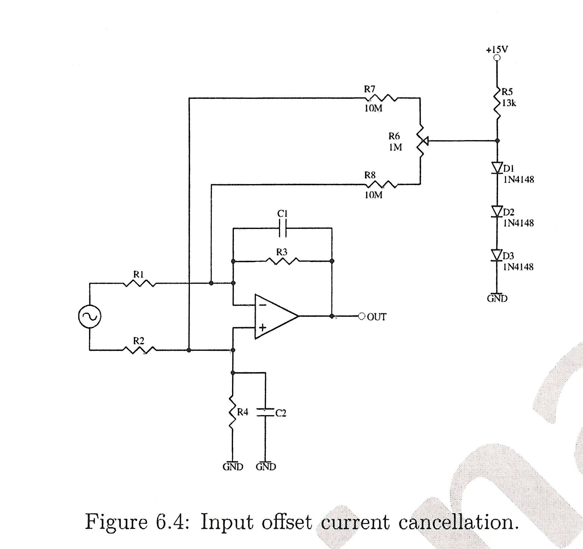

I was wondering about this trim... otherwise I was going to suggest using this --> maybe try it anyway and leave the existing trim untouched.
The KH4400A I have... does .0001% at 1KHz and .00025% at 10KHz with a couple opamp changes and adding an adj trim in place of a fixed value from the factory. I already outlined this in earlier comments/developments.

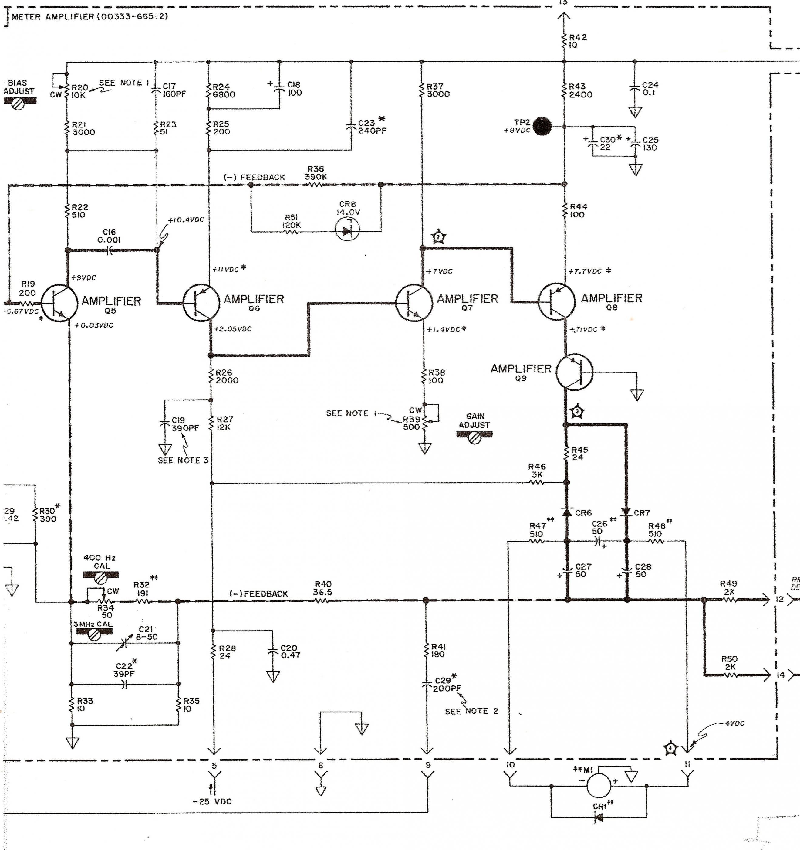

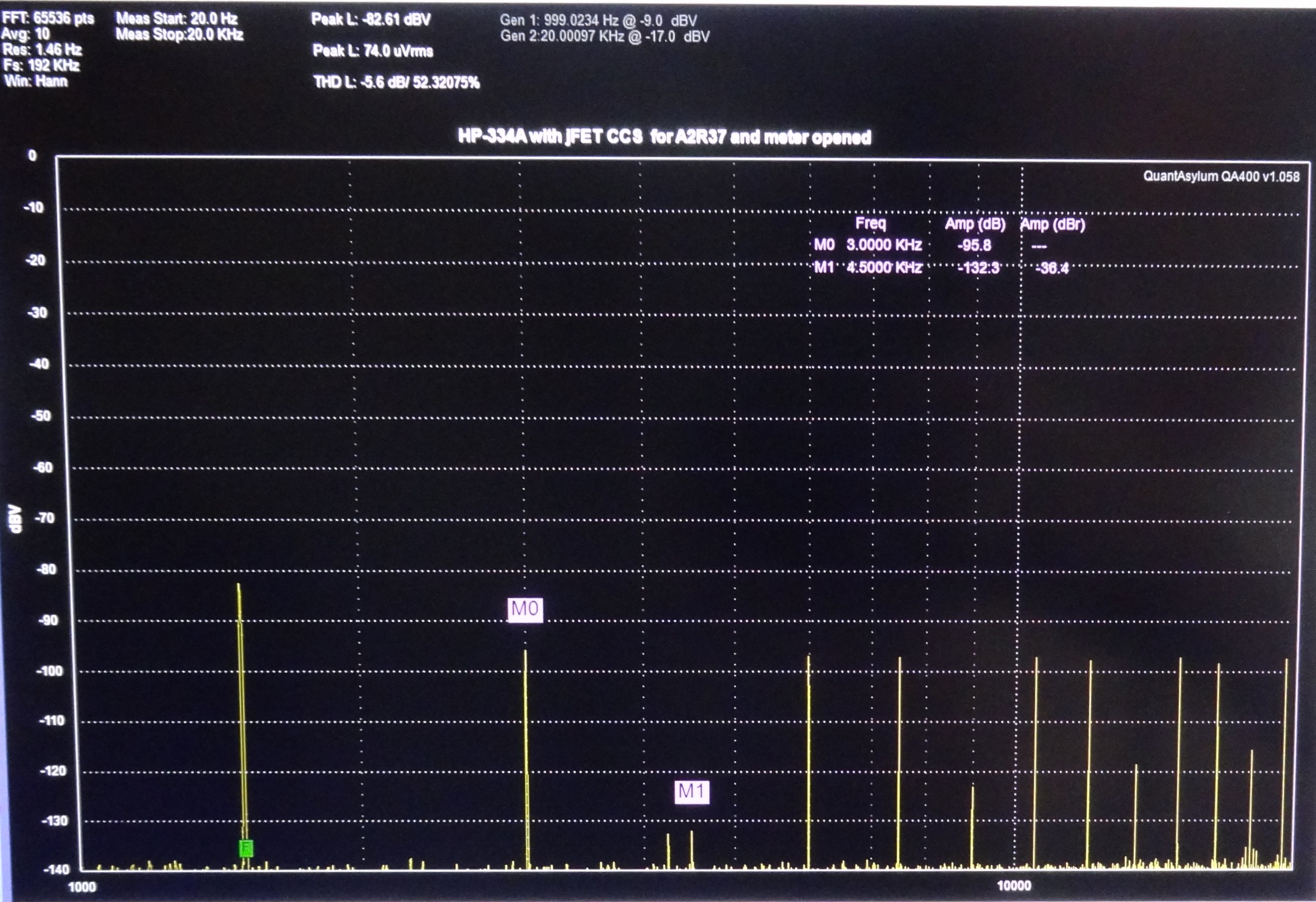

The distortion in the meter circuit of the HP-334A can be reduced thru cancellation. The input stage is a buffer which introduces about 6dB of the total distortion. So, I went at the meter circuit again. R36 (390k)- the nulling value was replaced with a multi-turn pot of larger value and adjusted for null. Most affected was the 3H and it was dropped into the floor of the QA400.
The 2H will be harder. But it is now at about -100dB.

Final thoughts for the 334A --- the auto-null circuitry with its differential input circuits, measures in at -110dB harmonic levels. So, that is the lower resolution limit of the instrument. The input circuits are single-ended -- really the volt-meter frontt-end that drives the notch filter can be bypassed and go direct to the null circuit input. Thats what i did and saw -110dB. If you just add the trim adj and fiddle with the input buffer and meter/null driver's bias control and make the panel meter disconnect..... these changes can get you to -100 to -105dB at the monitor output port.
This is a heavy and strong built piece of equipment and a reliable work horse. The best feature is the tunability of the notch and that allows for fine tuning and flexibility to match any osc/generator, exactly. Or, to tune out any individual harmonic. You could also use it as a fundemantal notch for an ADC input by adjusting the notch depth in manual mode. It seems to be very stable after warm-up. In auto-null mode, the depth of the notch is about -80-85dB. For the typical cost of $50 it can be helpful to anyone on a tight budget.
