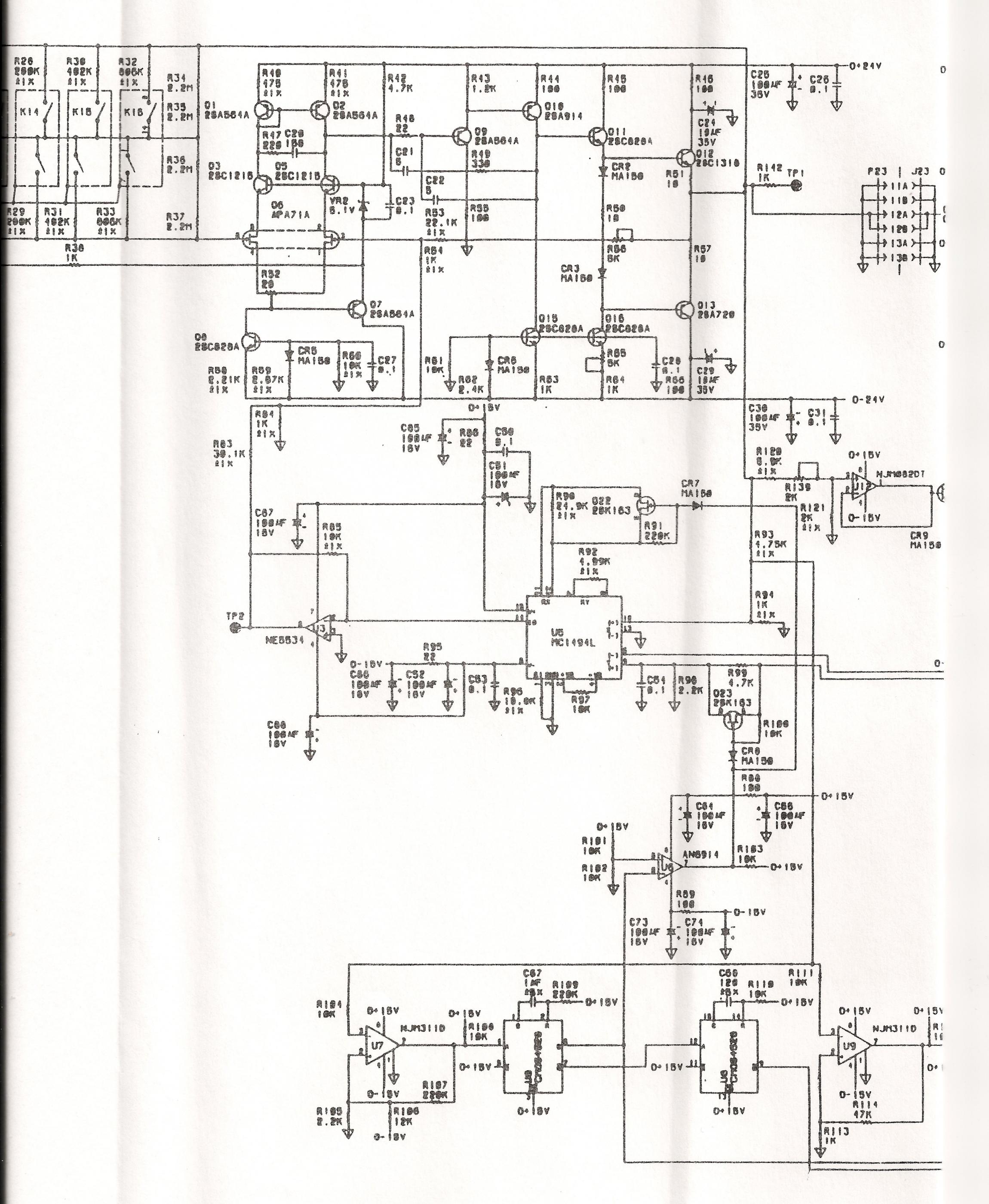

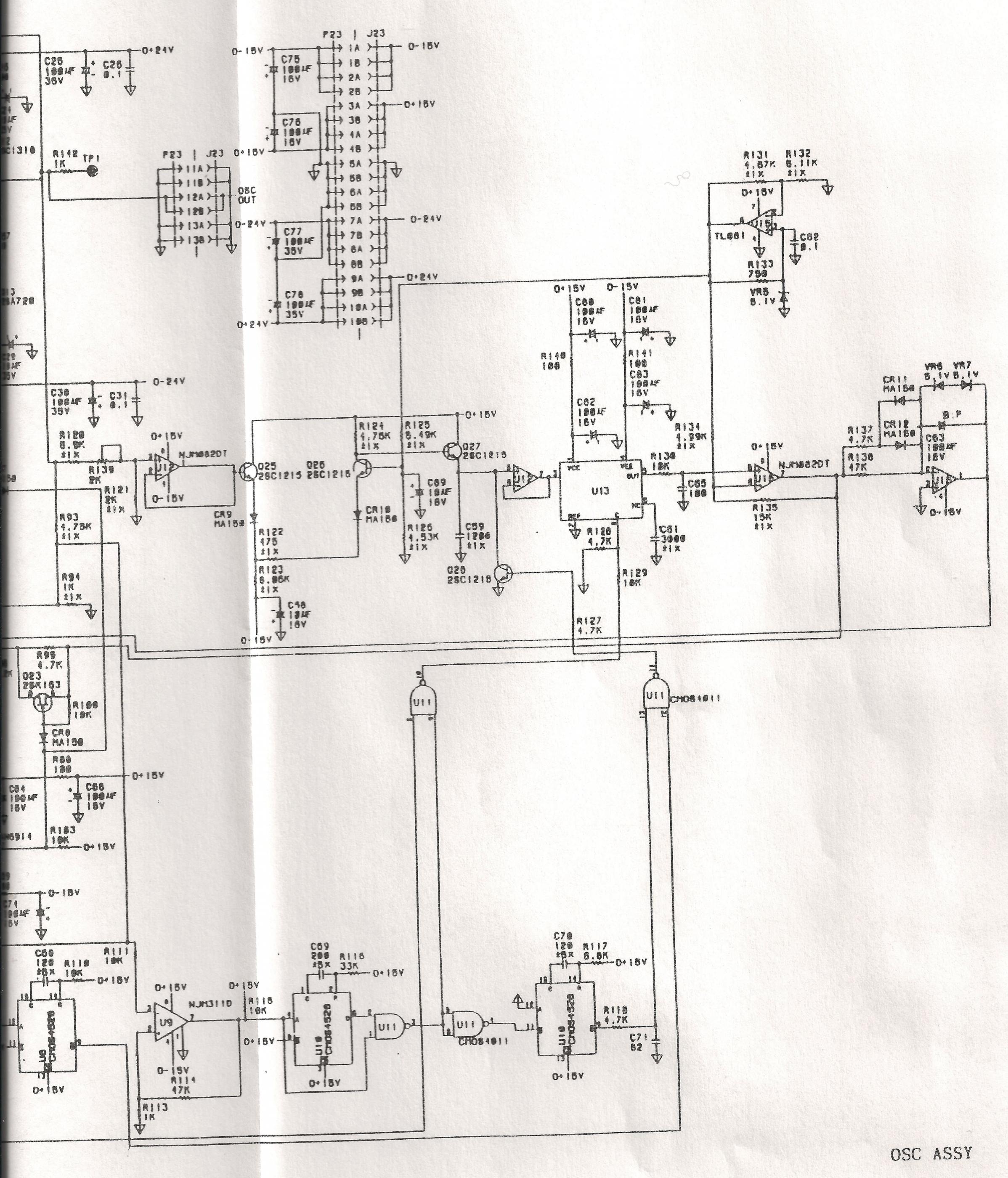

Low-distortion Audio-range Oscillator
The quality is fine. But looks like copied. But it is in a three ring binder and has folded pages for the schematics etc. Could be it is original but if so, was done on the cheap. The fan-fold type schematic pages makes me think it is original.
-RNM

I think several of us will want a scan of the Panasonic manual.

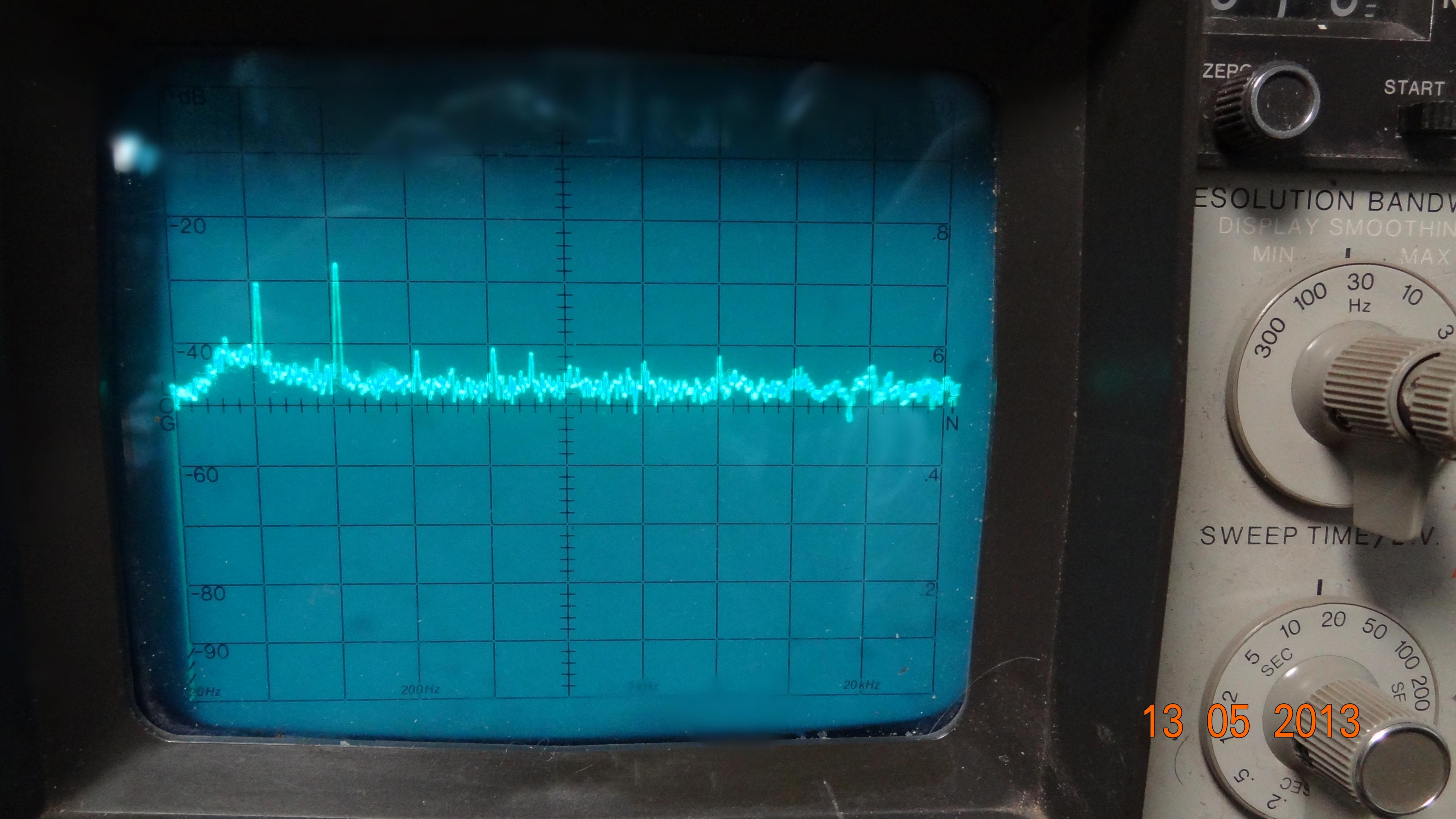

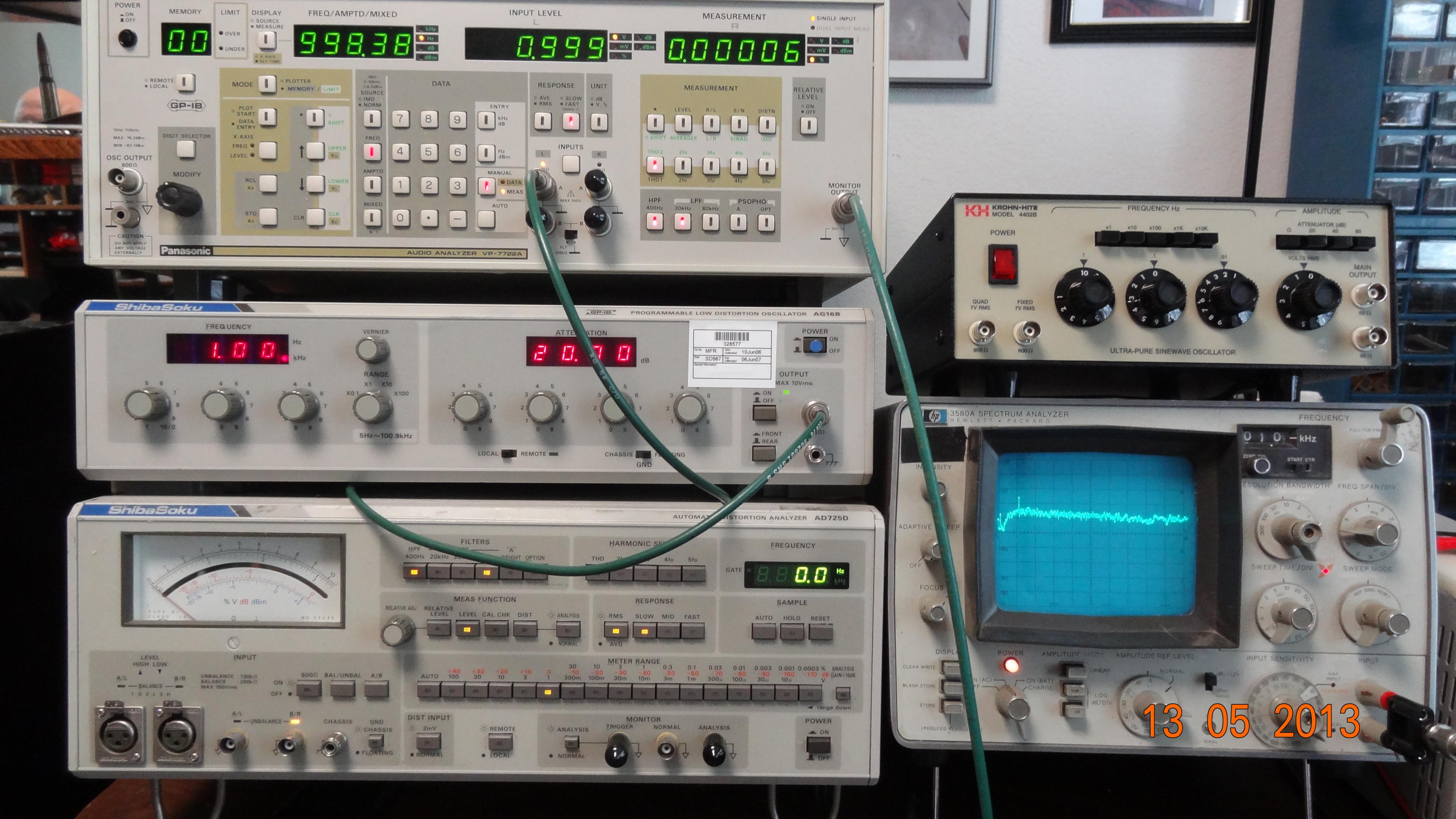

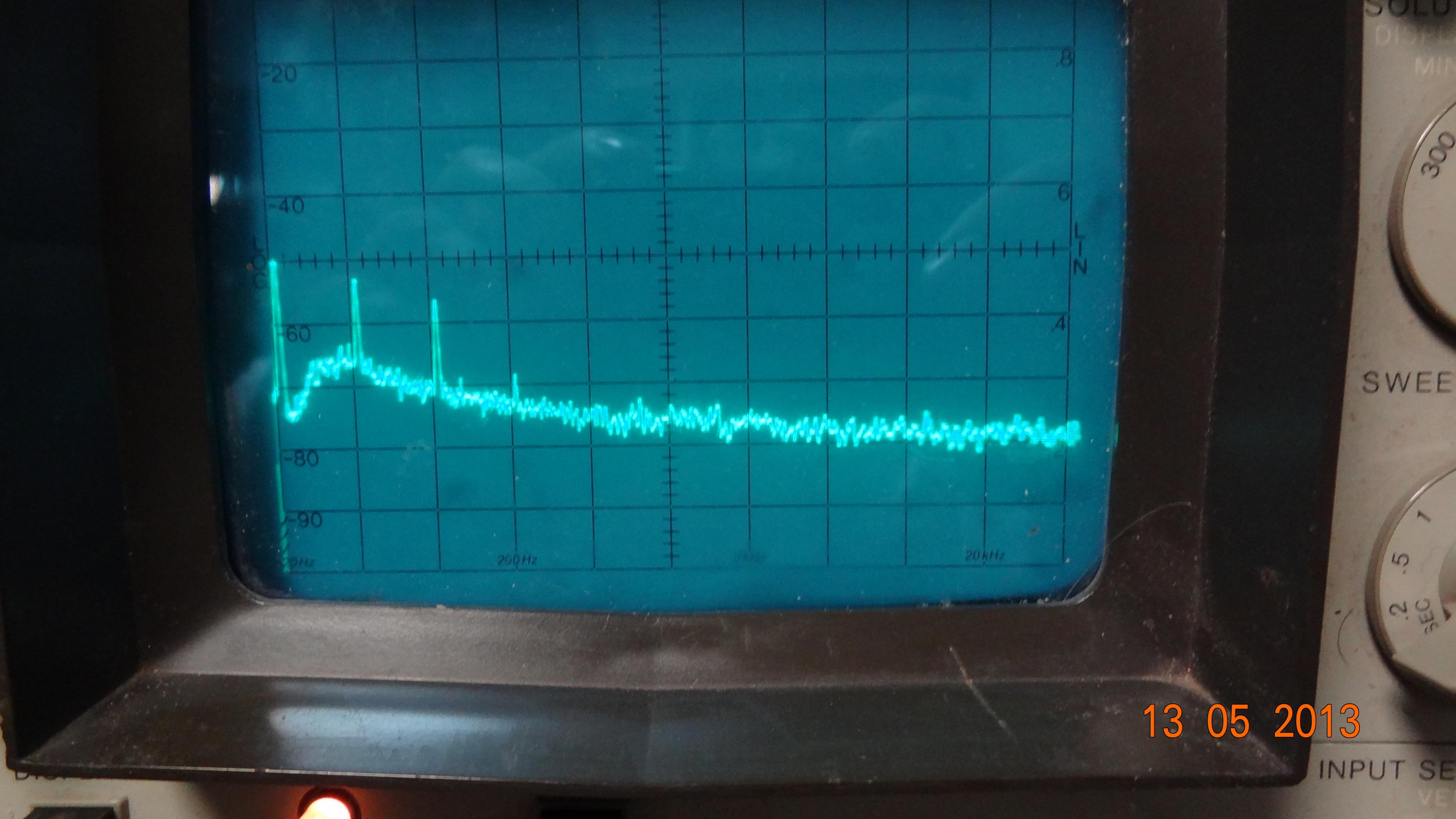

I am not using FFT on monitor output... that would Really complicate things. Just the slow swept analog filter (Spect analyzer). Here's a thousand words:
Never mind what the absolute levels are - each analyzer is at their lowest range - but zoom in and look at the 2H and 3H levels and to each other.
Clearly the 725 shows more harmonics with lower noise floor. But those harmonics displayed are not even remotely close to one-another.
Thx-RNMarsh

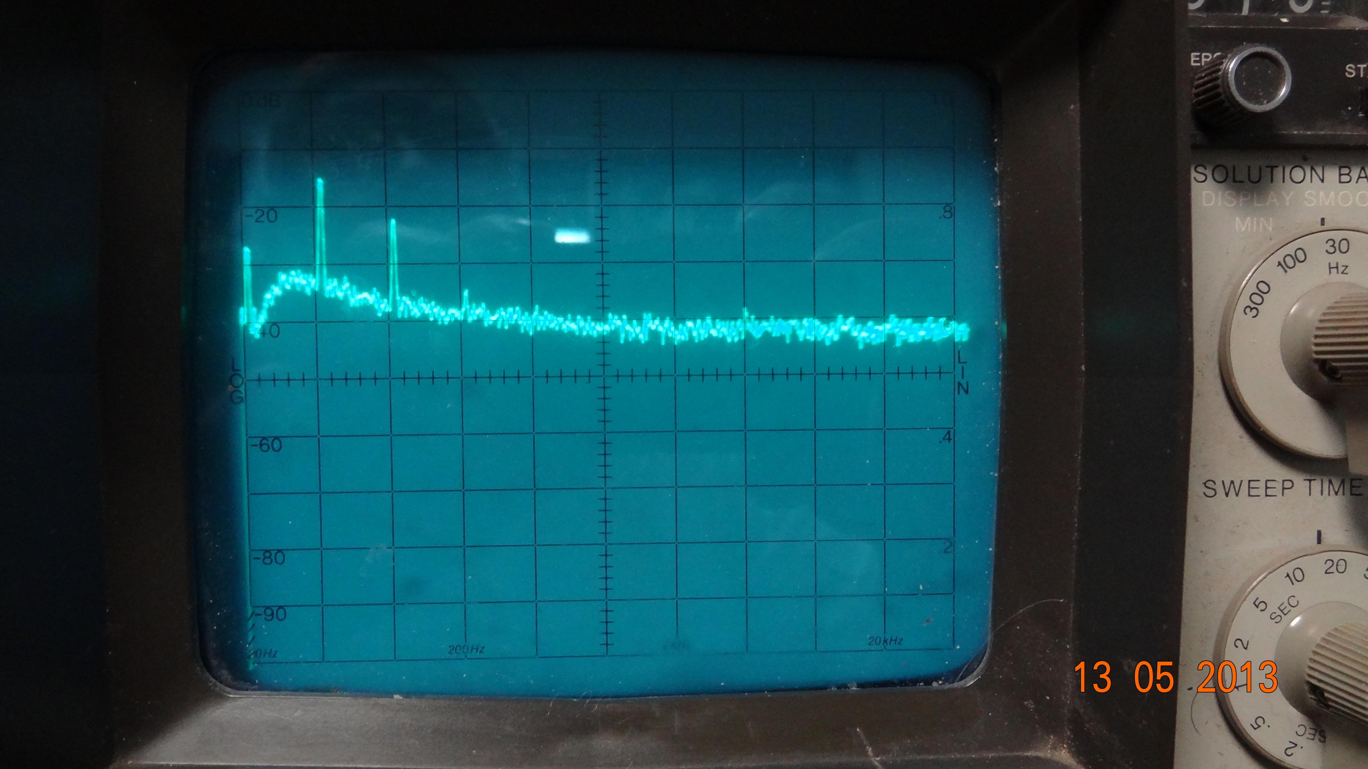

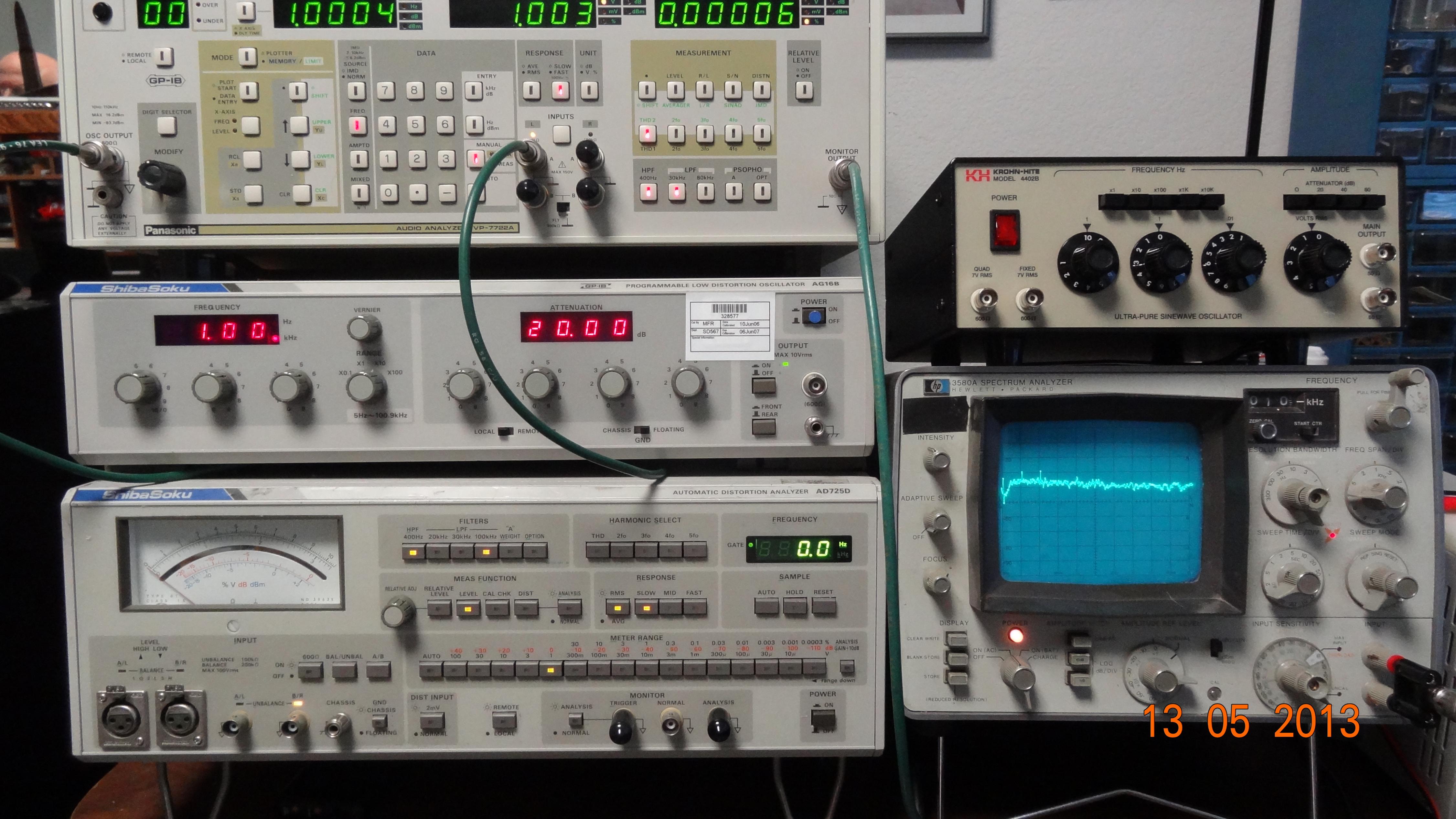

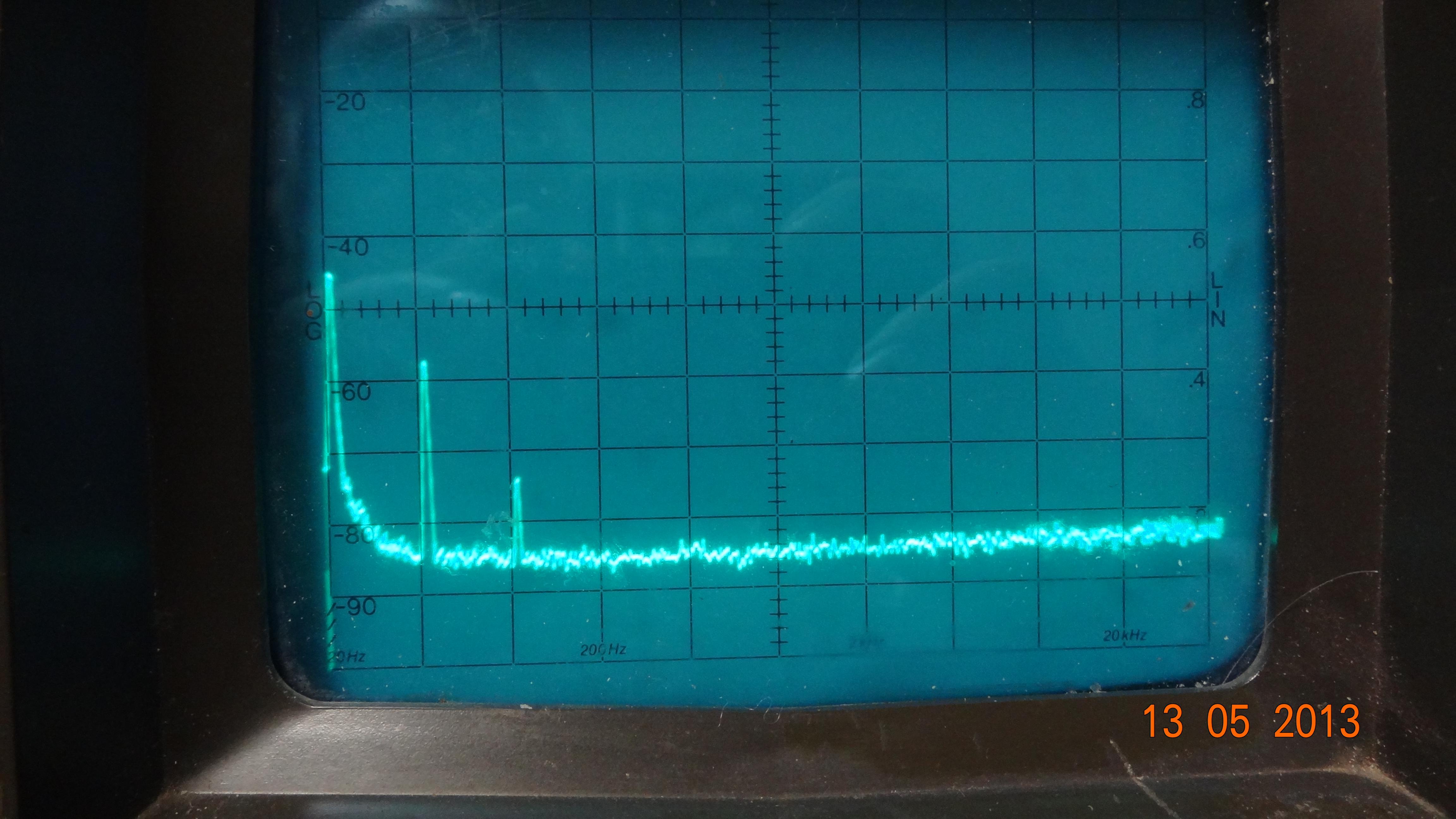

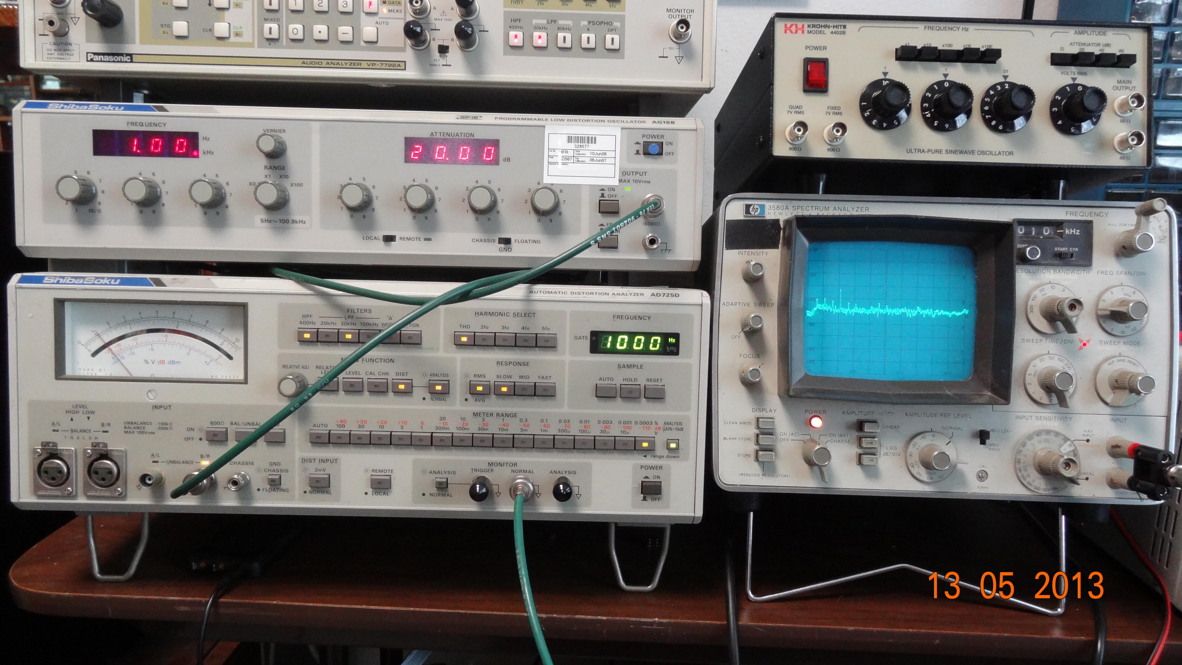

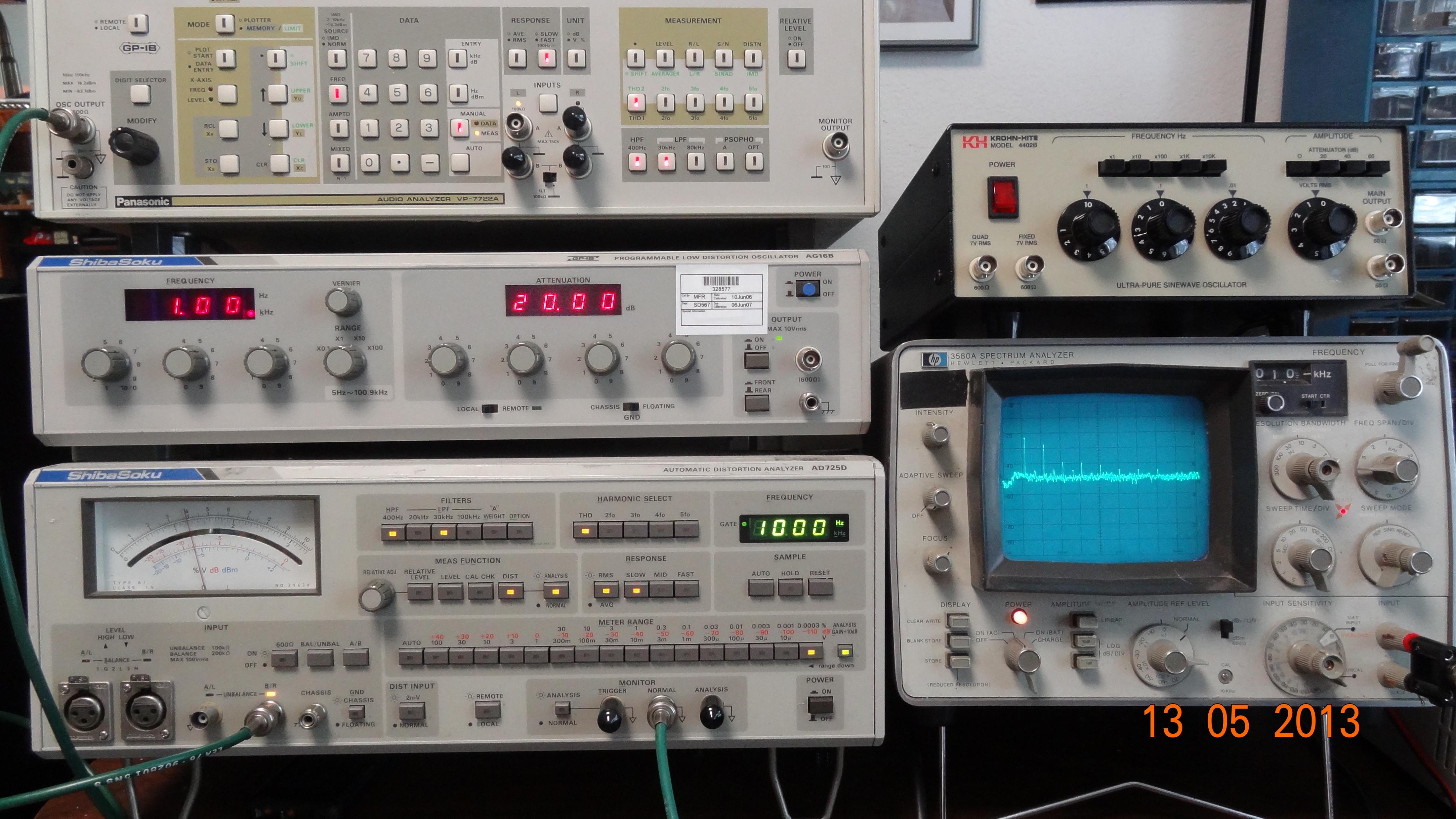

Harmonic spectrum from 4 different analyzers' monitor ouput.... each driven by a 10Vac rms signal from ShibaSoku AG16B (THD well below .0001%). Previous photo's were with 1v input. Each analyzer has auto scaling/ranging or manual range change to normalize the input level to the analyzer.
10dB/div;
339A(mod.), 7723A, 7722A, 725D
10dB/div;

It would help a lot to separate the generator distortion from the analyzer distortion. I would try inserting the B&K passive filter (-20 dB distortion analyzer mode) between the source and the 725D. Use the B&K notch to reduce the fundamental 40 dB and go into the 30 mV input. This should "amplify" the generator harmonics by 40 dB. You can then easily see if the harmonic pattern has changed and what the relative levels are. I think its pretty safe to assume the components in the B&K will introduce less than -140 dB distortion, they all seem to be very high quality.
I'm still not sure how an FFT analyzer would complicate the harmonic measurements. But I have been the technology for years.
It would help a lot to separate the generator distortion from the analyzer distortion. I would try inserting the B&K passive filter (-20 dB distortion analyzer mode) between the source and the 725D. Use the B&K notch to reduce the fundamental 40 dB and go into the 30 mV input. .
None of the THD analyzers I tried this on will function with that low of a fundamental input level.
Thx-RNMarsh

If you put a 6dB pad between the oscillator and the analyzer (assuming the pad and interface are always 600 ohms), then the 2nd harmonic should go down by 6dB if is coming from the analyzer in most cases, where the working level in the analyzer is determining its distortion (not sure this will apply to the control voltage ripple contribution, however). If the 2nd harmonic stays the same, it is probably from the oscillator. This is just a rough test and there may be exceptions.
For the 3rd, distortion should theoretically go down by 12dB if the dominant source of distortion is in the analyzer. Above caveats apply.
In both these tests, we assume anayzer input attenuator remains the same. We also assume that the 2nd and 3rd are measured with a spectrum analyzer at the residual output with sufficiently narrow bandwidth that noise will not influence the result.
Just my suggestion. There are probably plenty of other possible ways to try to separate these out.
