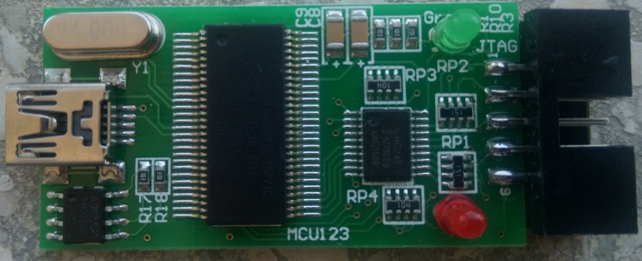

low cost USBi programmer using cypress CY7C68013A board

Just a nitpick. The Cypress boards are usually 3.3V boards. And the cheap ADAU1466 currently sold on Aliexpress and eBay are also 3.3V IOVDD, so as CyberPit says, it all works fine.
But the ADAU1466 can use either 1.8V or 3.3V IOVDD. When IOVDD is 1.8V, the programming pins can accept 1.8V only. Using 3.3V programmers on a 1.8V board will damage the ADAU1466
The Analog Devices USBi programmer can be switched between 3.3V and 1.8V, depending on the target device. The cheap CY7C68013A boards cannot, and only work at 3.3V
As a matter of fact, the original Analog Devices USBi uses the CY7C68053 56BAXI device, while the cheap boards use the CY7C68013A. The former can work at 1.8V to 3.3V, the latter only 3.3V
So, while it's perfectly safe for now to use the cheap Cypress boards or the FreeDSP one, if in the future ADAU1466 boards using 1.8V become available, those won't be safe to use with the cheaper options (unless someone uses a level shifter for the programming pins, which is not hard to do)

If you change the pull-up resistors as shown in the attachment the boards can be left connected and powered up simultaneously or separate. No need to disconnect or power up individually.
The DSP will boot from EEPROM and the programmer will be detected correctly.
For anyone else reading this thread: I tried changing the resistors and it makes no difference. Looking at the circuits, the SDA/SDL lines are used by both the CY7C68013A and the ADAUxxxx. And both try to access the same lines at boot time, creating a conflict. Changing the pullups doesn't make a difference.
As a matter of fact, both boards have 10k pullups, so when connected together, the resulting pull up value is ~5 kOhm, which is a bit high for an I2C bus at 3.3V. When changing the ADAU board pull ups to 4.7kOhm, the resulting pull up is 3.2kOhm, which is a better value. With 2.2kOhm, the resulting value is 1.8kOhm, which is even better, according to the TI app note (https://www.ti.com/lit/an/slva689/slva689.pdf?ts=1620582343503)
So, change the resistors if you want, it will not harm anything and actually make things better for high speed I2C communication, but it cannot solve the original problem of having shared I2C lines accessed by 2 masters at the same time.
The only way to actually solve it would be to add a circuit that interrupts the communication on SDA/SDL between the 2 boards for a second when power is applied, so that each I2C bus can allow the flash content to be loaded independently. The FreeUSBi circuit does that. Otherwise simply power on the boards separately, then connect the SDL and SDA lines
