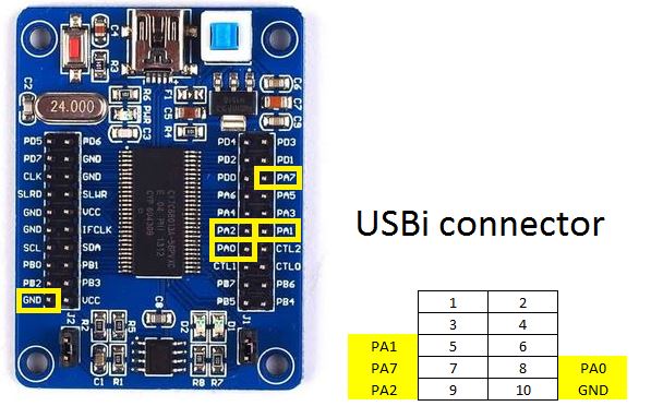

Programming the low cost CY7C68013A development board:
Download Cypress Suite CySuiteUSB_3_4_7_B204.exe. This file should have the following md5 checksum: 1ece8ba8dcb0038049b7e07e2473011b.
Download 24aa256.zip (24aa256.bix 8kB)
Unpack the zip.
Rename 24aa256.bix to 24aa256.iic
To transfer 24aa256.icc to the EEprom on the CY7C68013A development board:
- Remove jumpers on the CY7C68013A development board,
- Start CyConsole (part of Cypress Suite), Choose menu Options-> EZ-USB interface
- push button lgEEPROM, select the EEPROM file i.e. 24aa256.icc. Download should start.
-put jumper on again
When the board is reconnected to USB (reset) the board should be recognized as Analog Devices USBi (programmed) .

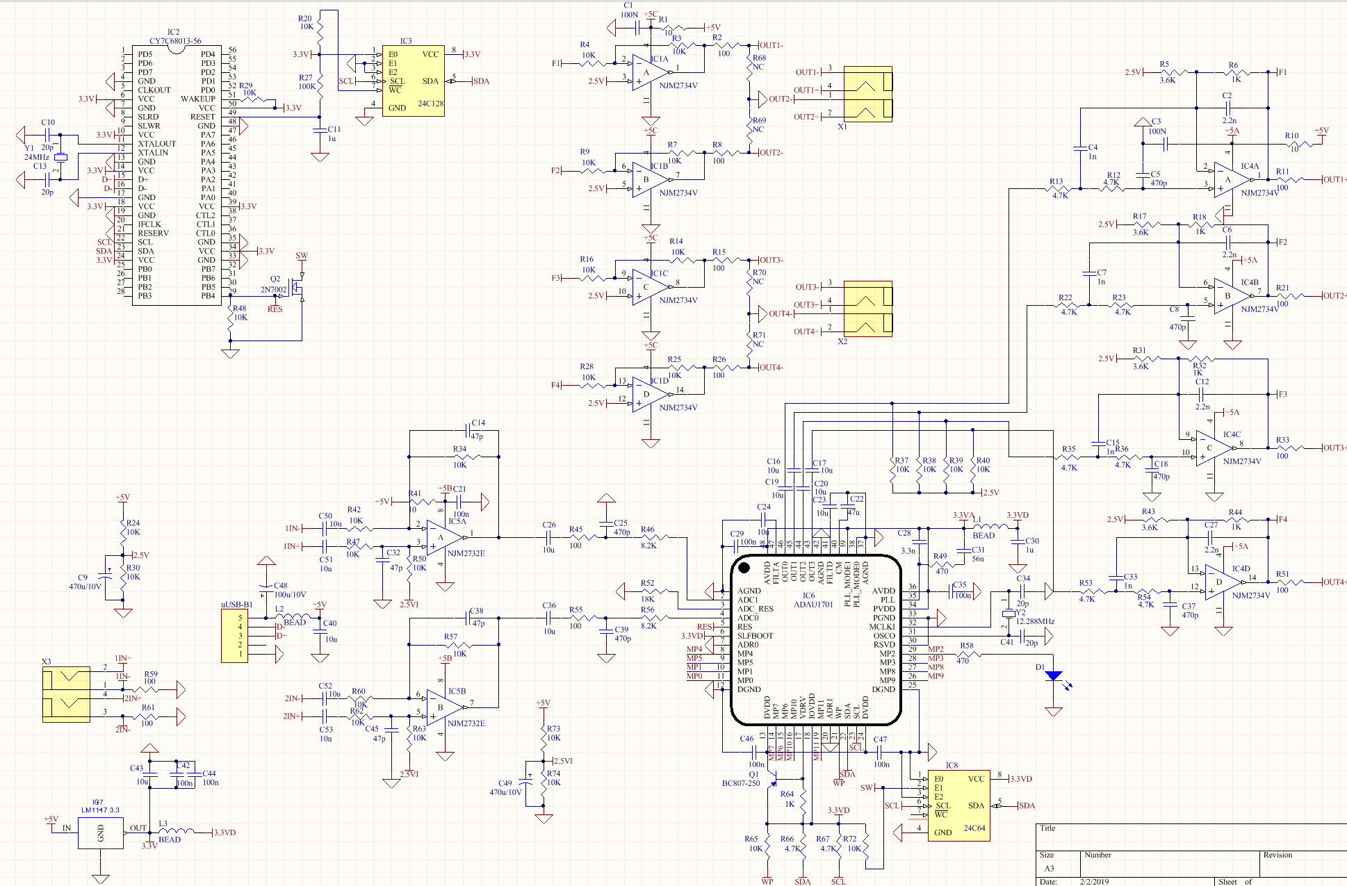

On the previous page I've shared entire project Sch+PCB where is no any jumpers.

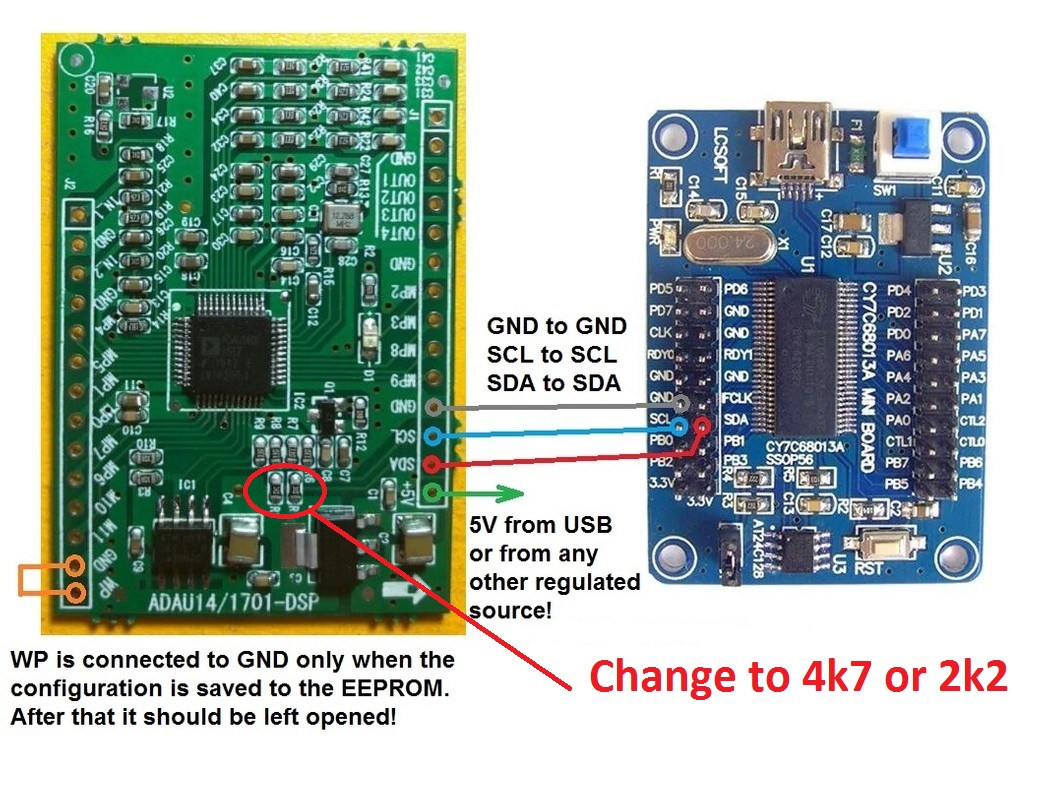

Are you also using the small green AliExpress board with the ADAU1401/1701?
If so, make sure to lower the pull-up resistors on the SDA and SCL to 4k7 or 2k2.
The programmer board is probably pulling the I2C lines low and the ADAU will not boot.
This will solve the problem. It won't matter if you power the board or the programmer first. You can even leave the programmer connected.
Here is the connection with the green ADAU1401 board:
The connection between both boards should be applied AFTER they are powered-up!
If you change the pull-up resistors as shown in the attachment the boards can be left connected and powered up simultaneously or separate. No need to disconnect or power up individually.
The DSP will boot from EEPROM and the programmer will be detected correctly.

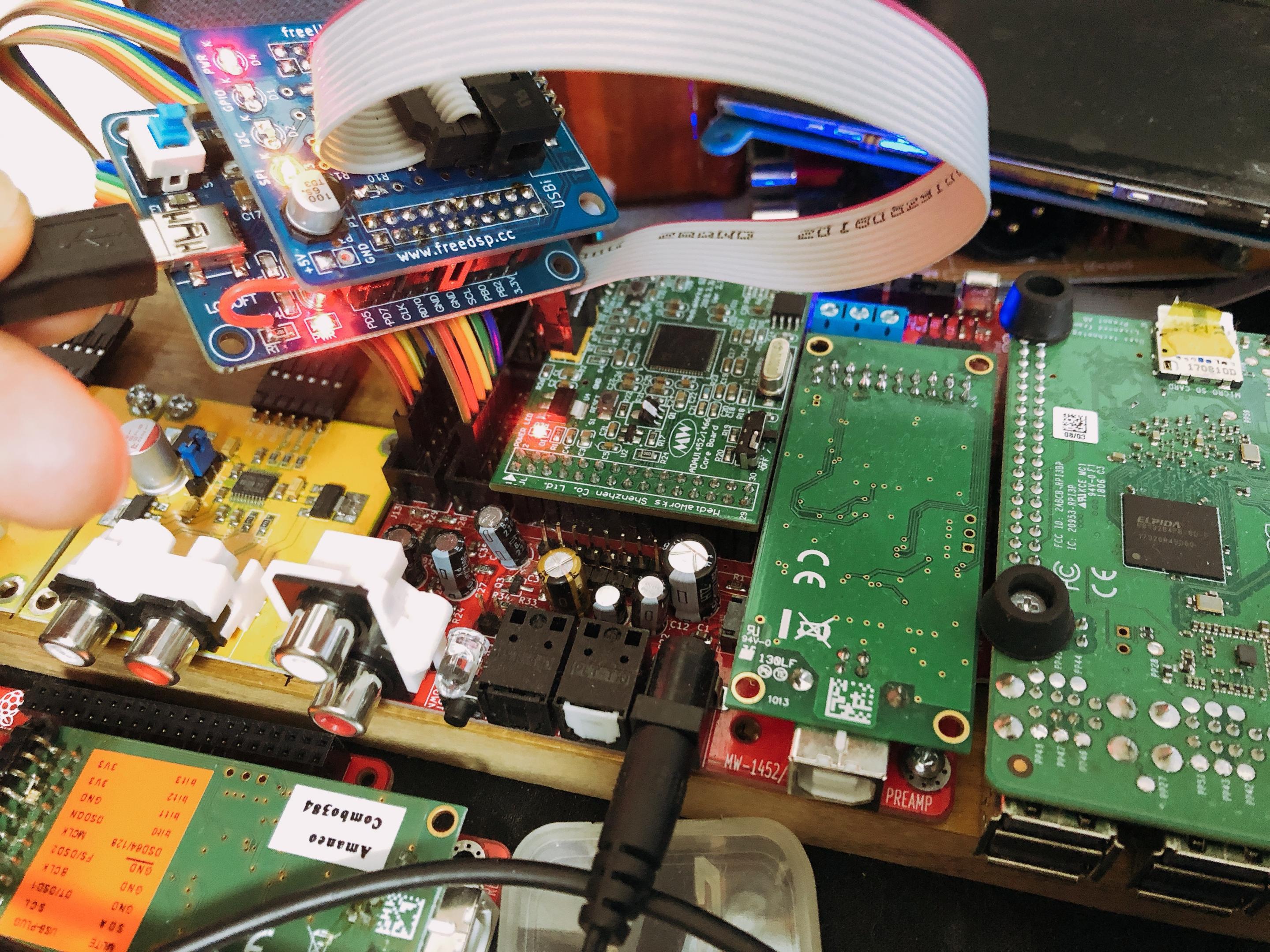

I have a question. I've worked with the low cost ADAU1401 boards, however I just ordered a ADAU1466 board. I believe those are normally programmed over SPI. Is it possible to still use the same cheap FX2LP boards to do it?
Don't worry, It's works fine.
